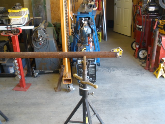

Around here we use a lot of pipe for fencing, building buildings, and just about anything else.
We have a small vineyard and at the end of each row I have installed some 1 7/8 inch pipes to secure the trellis wires. I'm a bit of a nerd when it comes to these things and I like to have them look finished so I buy domed caps to weld onto the pipes. Then we paint them dark brown, and run the trellis wires. The lowest wire is used for the drip irrigation that goes to each vine.

The second shows one of the pieces of pipe for the vineyard with the clamp holding the cap on.

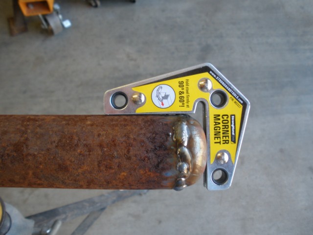

The third is a close up of the clamp. Now just a quick tack, remove the clamp and finish the weld. Walla! it's done.
These things are just the handiest little devices for working around pipe.
