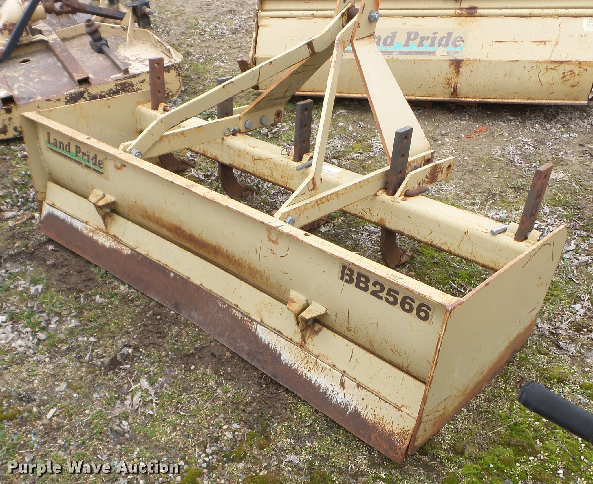

My only guess for the mounts on the back is some sort of gauge wheel

my tabs do not show up well , here is a web image of the only other BoxBlade I have seen with the tabs

No I have no clue what they are for, A little larger image.

/ CountyLine Box Blade??? #45
They are for a swinging style tailgate, guessing it was an option or it was removed at some point and changed to a fixed style
Sent from my SM-G715U1 using TractorByNet mobile app
/ CountyLine Box Blade??? #46
ok so thanks for the larger image that's definitely being used for a swing mount blade
but not sure if it is a true swing gate or thats an option to use with the fixed rear blade ?
Thanks again for the input gentleman , I don't plan on using those tabs for anything other than maybe dragging some chain link to smooth the drive after the box blade
