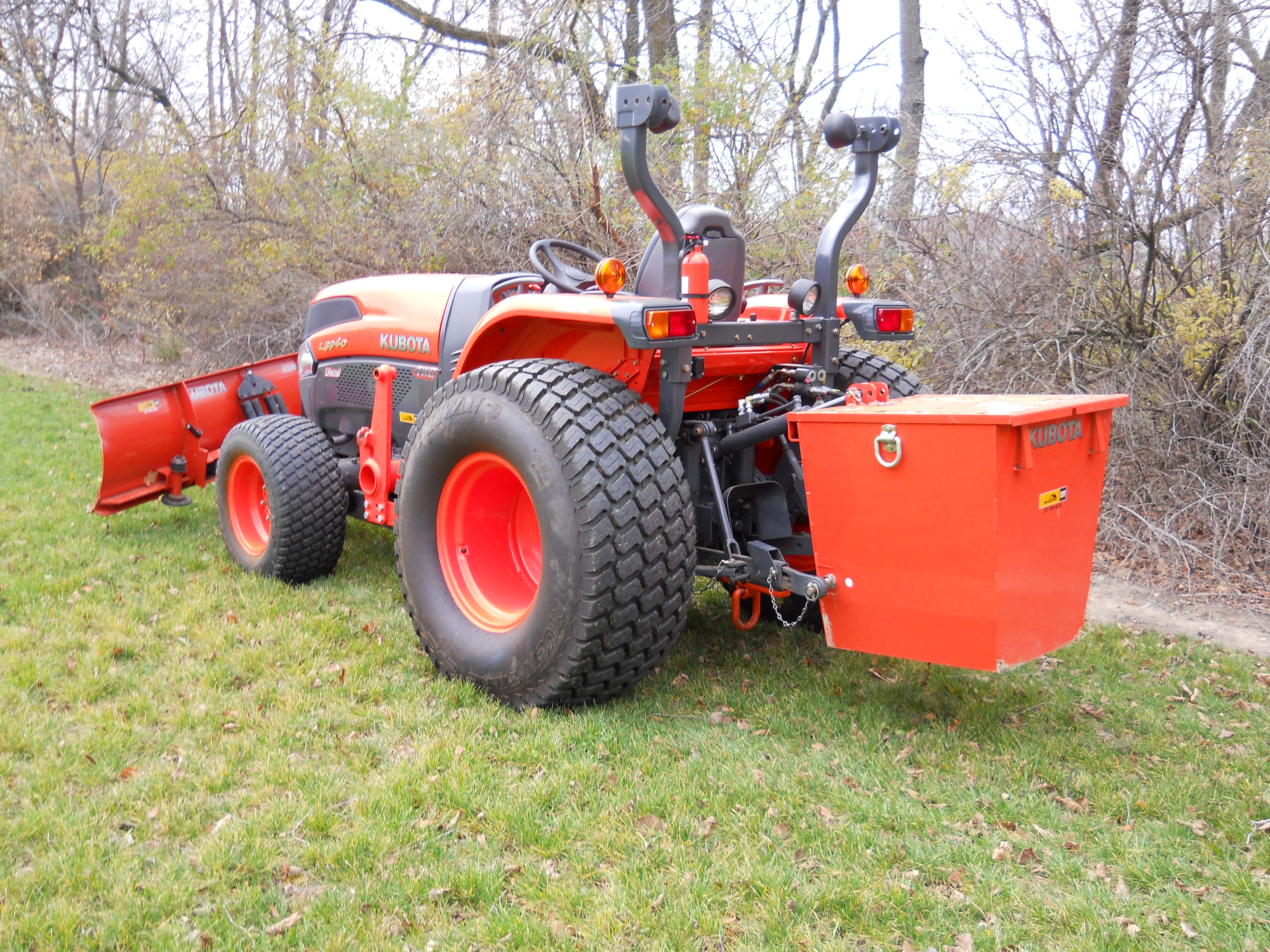

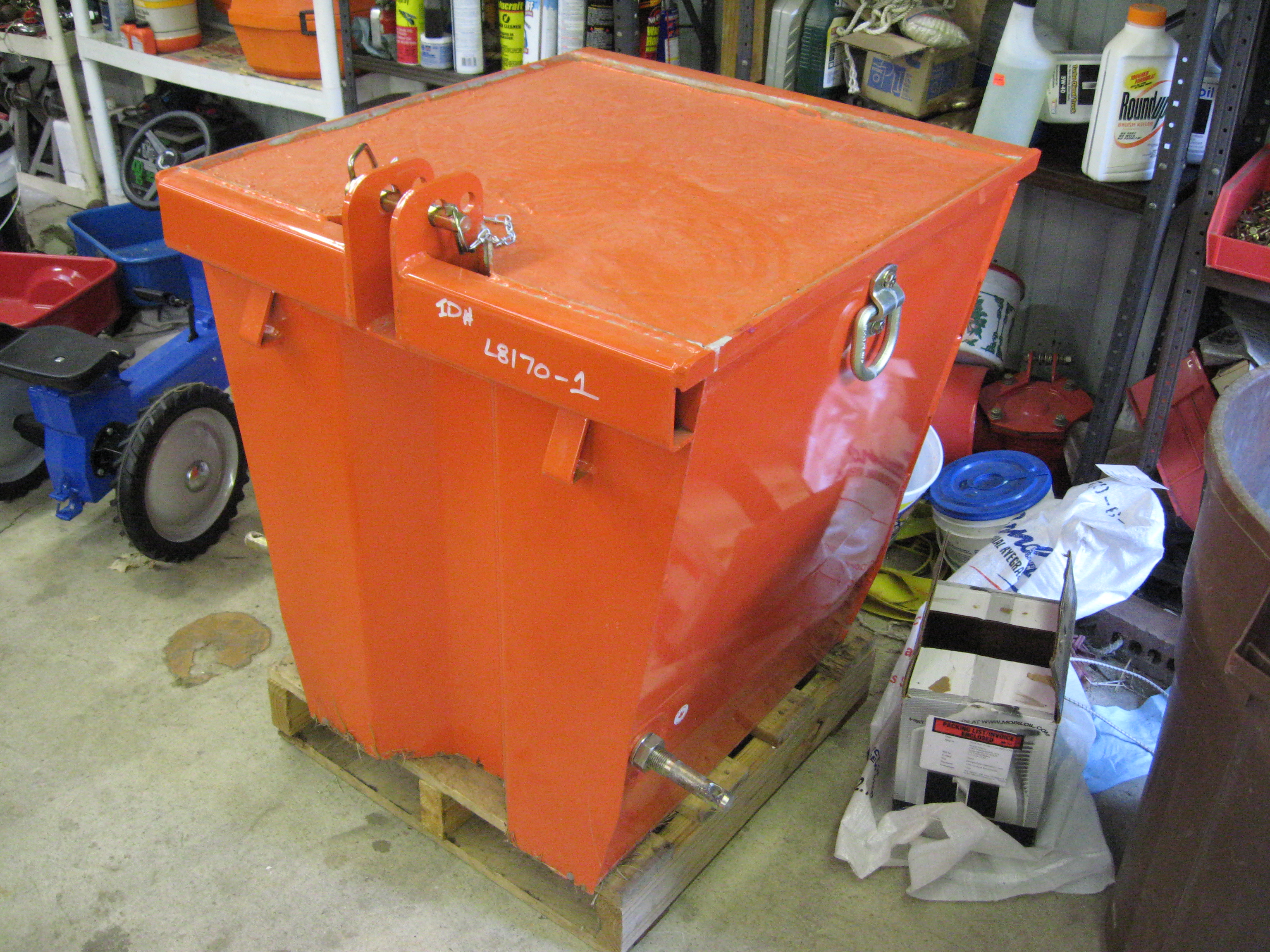

Get a ballast box. I put off getting one for years and like it. It stays close to the machine so it痴 not sticking out and it痴 easy to vary the amount of weight.
