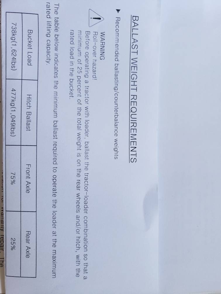

From my xr4140 manual. Roughly 66% of bucket load needed as rear ballast to achieve the 75/25 ratio recommended. 20200504_094149.jpeg

From my xr4140 manual. Roughly 66% of bucket load needed as rear ballast to achieve the 75/25 ratio recommended. View attachment 653927
Great information Johnston!! Now this is getting to be usable and easily figured information. My tractor is designed to lift 1000 pounds including the bucket. So I would need a 660 pound counter weight. I have 530 on there now which is good for an equipment saving 800 pound lift for this SCUT. Works for me and thank you for taking your time to share that information.
   / Counter weight size question - Is there a way to calculate the correct weight? #16
....but note those percentages are talking about weight and ballast at the axle. You’re adding ballast at some distance away from the axle, and often forward of the FEL pins (when using forks, etc) ....so now you’re back to 10 lbs at 1 ft. is the same as 1 lb at 10 ft.
