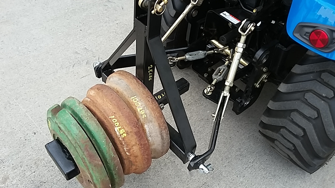

Attached are some pictures of the ballast weight that I built. That is 400 pounds. I'm gonna add one more 130 pounder and see how that feels. I've never had that "light in the seat" feeling but I'm just thinking about the load on that front axle.
I truly appreciate all your thoughts here as it helps me feel good about my decisions here.

Well after some work and welding I got the BIG weight in the stack. I had to make a spacer to take up the slack between the 10" center hole and the 2" trailer hitch bar but that is done and now it's all back together. The orange weight is an F&H DP2628 and it's 130 pounds. The 400 pounds that this weight was total worked pretty well but I'll more confident now with this 530 pounds hanging off the three point.
Thanks again gentlemen for your thoughts and suggestions.
Regards,
Lisa
