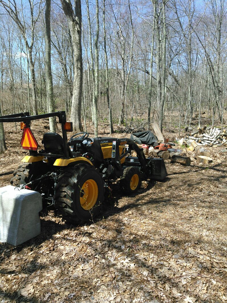

What weight should a Jd 2720 carry on 3pt when using loader

Having your twin in black /yellow paint i use 700lbs. Feels perfect to me with that amount.
