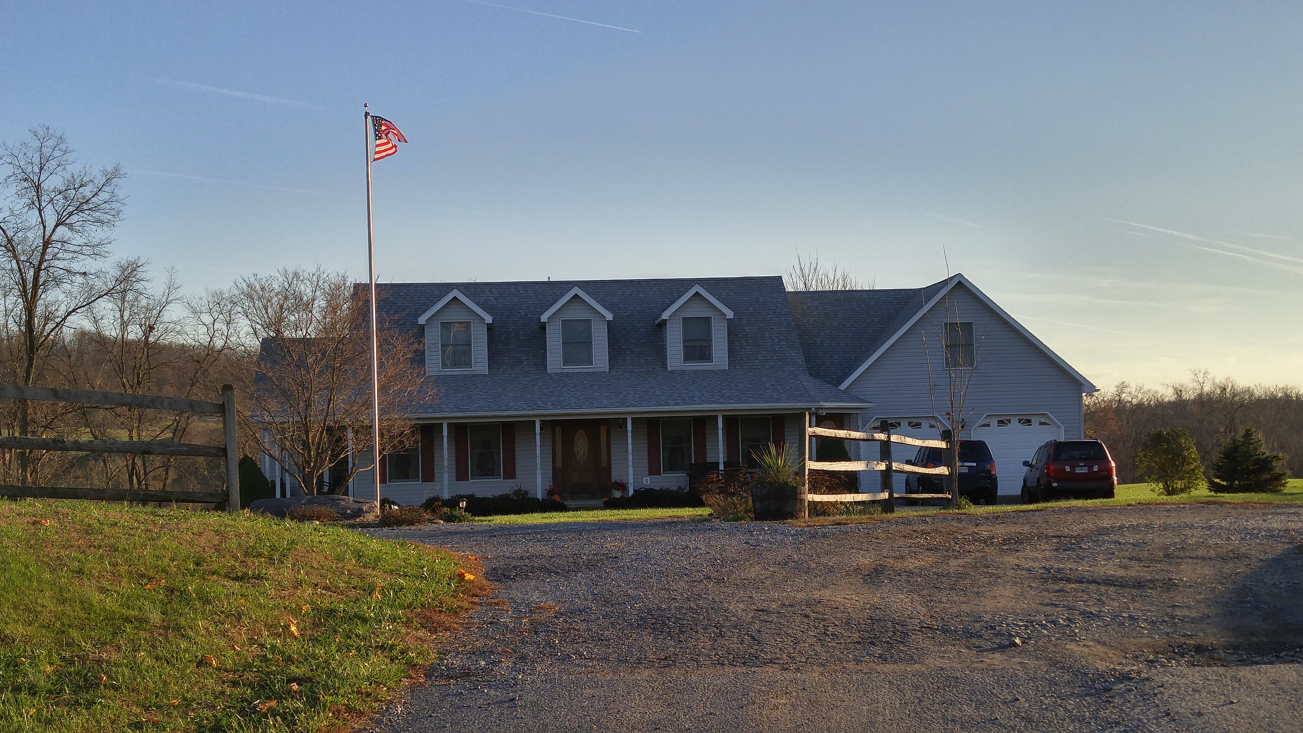

Here, up is lot cheaper than going out.
I built in 9 months while working full time. Usually had a couple friends help on the weekends. Started framing in jan, was fortunate to have a mild winter. Dormers take a lot of time.
My excavator also did the septic, very reasonable price.
Garage was added later, took way longer than the house.
Once you move in, it's done. Few things i never finished.
