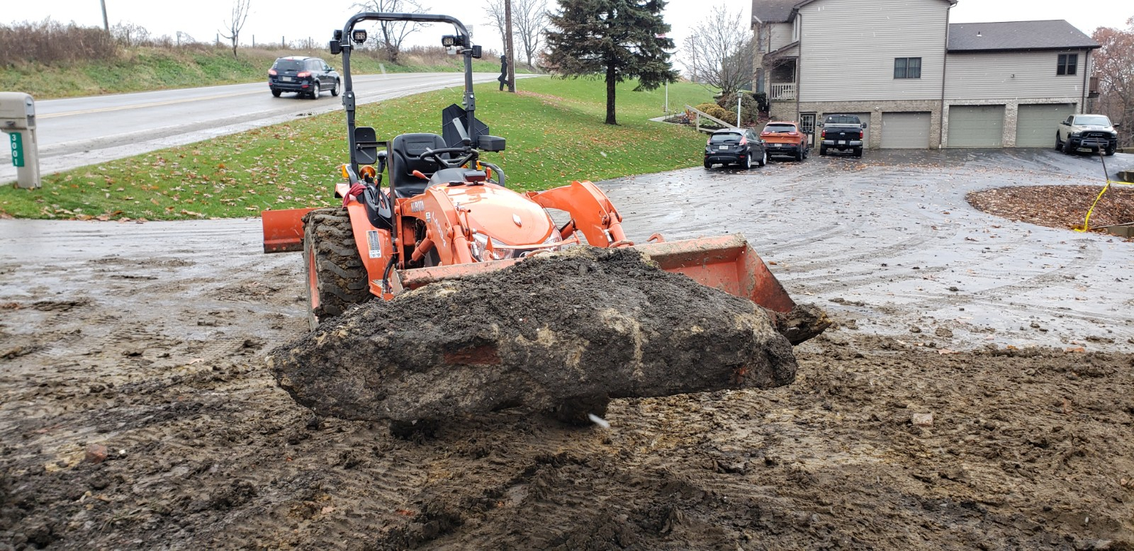

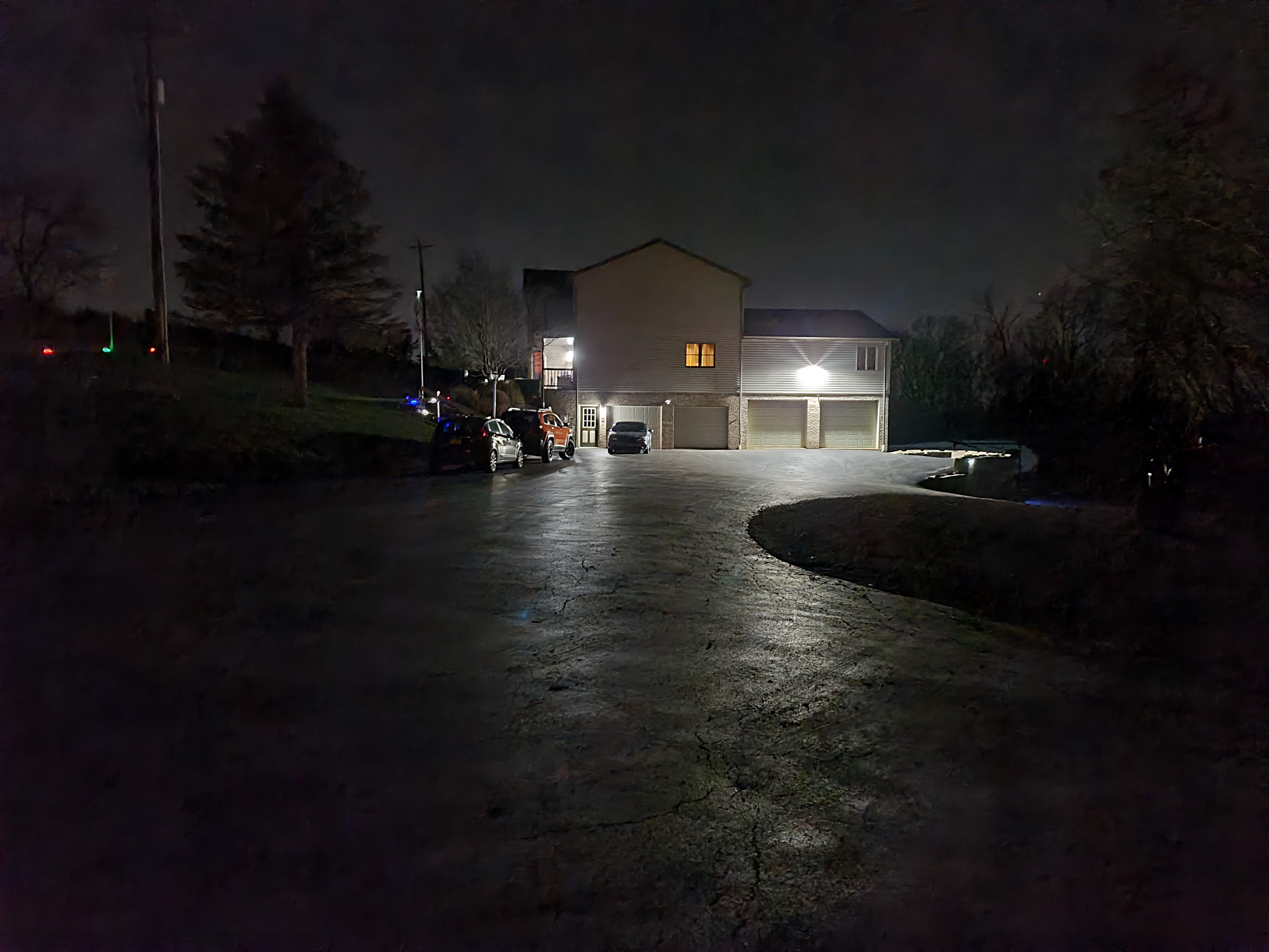

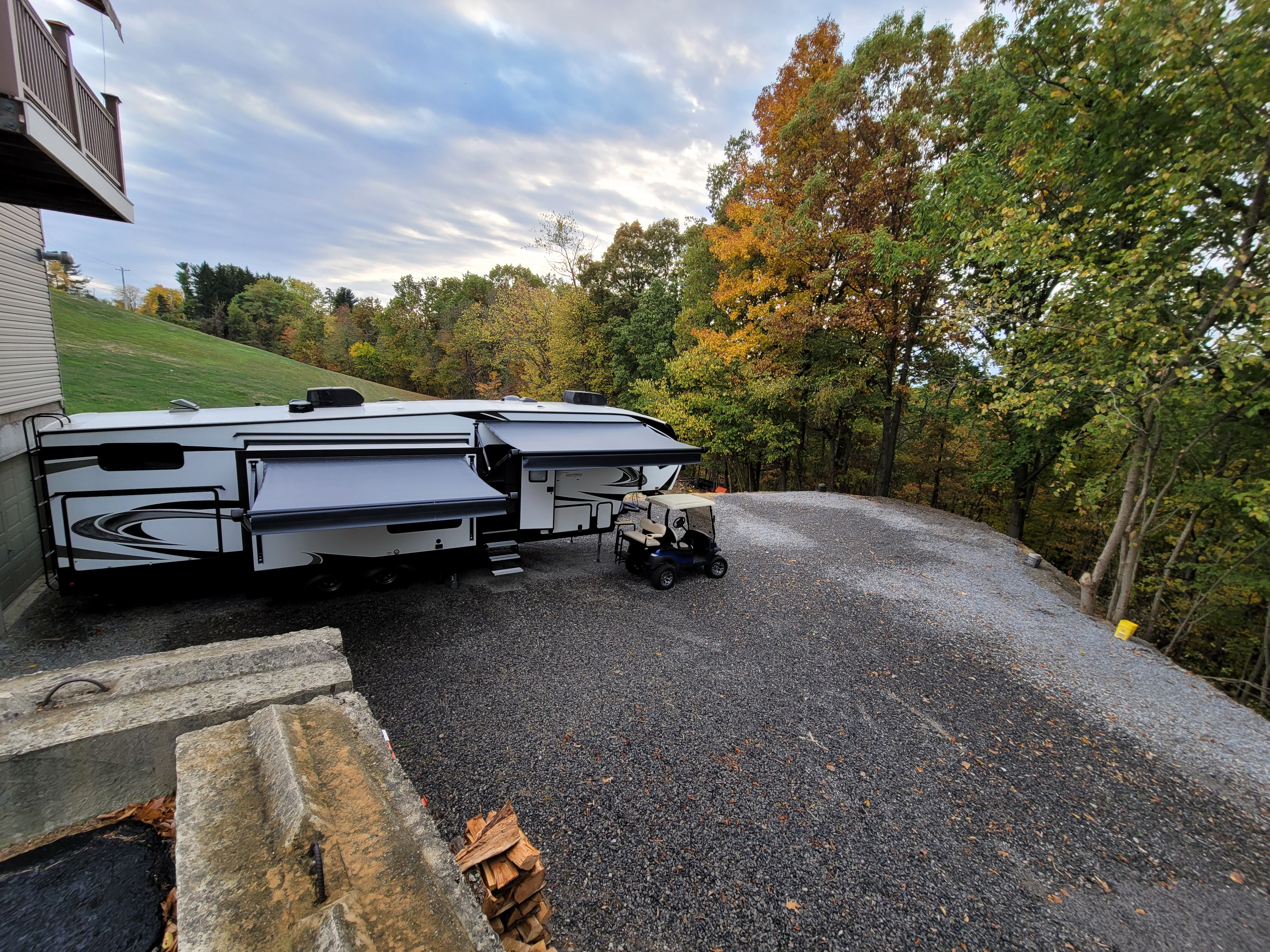

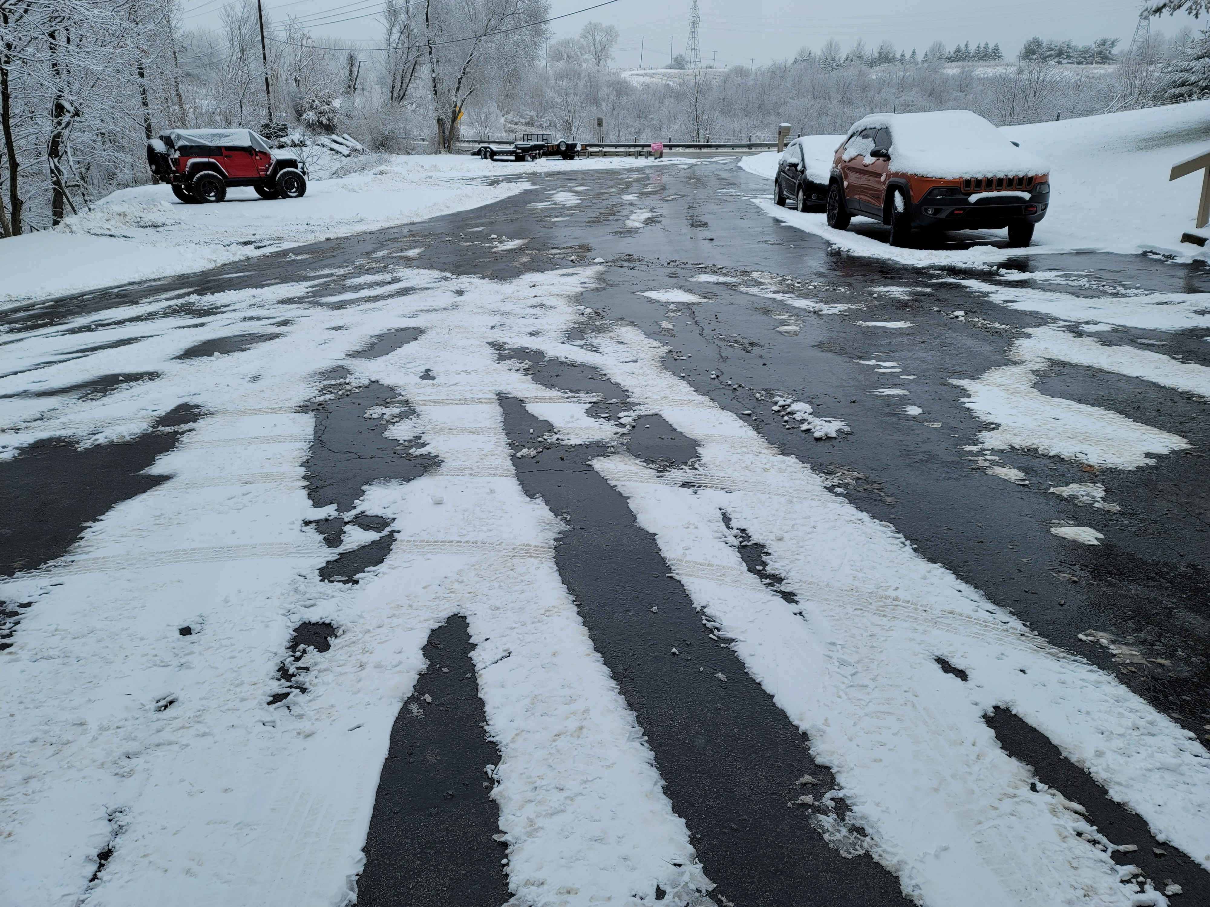

You guys are scaring me. I have been adding fill to my driveway and I have a 250' long hour glass shaped upper drive with 85' wide at the upper house garages, 55 feet at the narrow part of the hour glass, and 120 wide at the far end of the driveway. Then I have a split to go around back to the lower garages that is 30' wide along the wall and opens to 110' from the 3 garage doors to the tree line and that is 50' wide.
I have the original asphalt up top that was 85' wide at the house ad dropped to 35' wide and went out to the far end. All the rest is now #2B, but I dream of a Walmart parking lot of asphalt out there. I may need to sell some vital organs to fund it!
I attached pic of the original driveway with my Kubota holding a rock in the bucket. That was 3 years ago. We have been taking fill like gangbusters for 3 years and made the driveway massive.
I need to take drone pictures for this year to show what we've done with clean fill for free. It is shocking. But now.... I am getting close to done and want to make it all homogenous with asphalt so that it looks "pretty" and plows easy. Plus my old dog hates the #2 limestone on her pads. She lips/tiptoes around it and looks at me with disgust.
