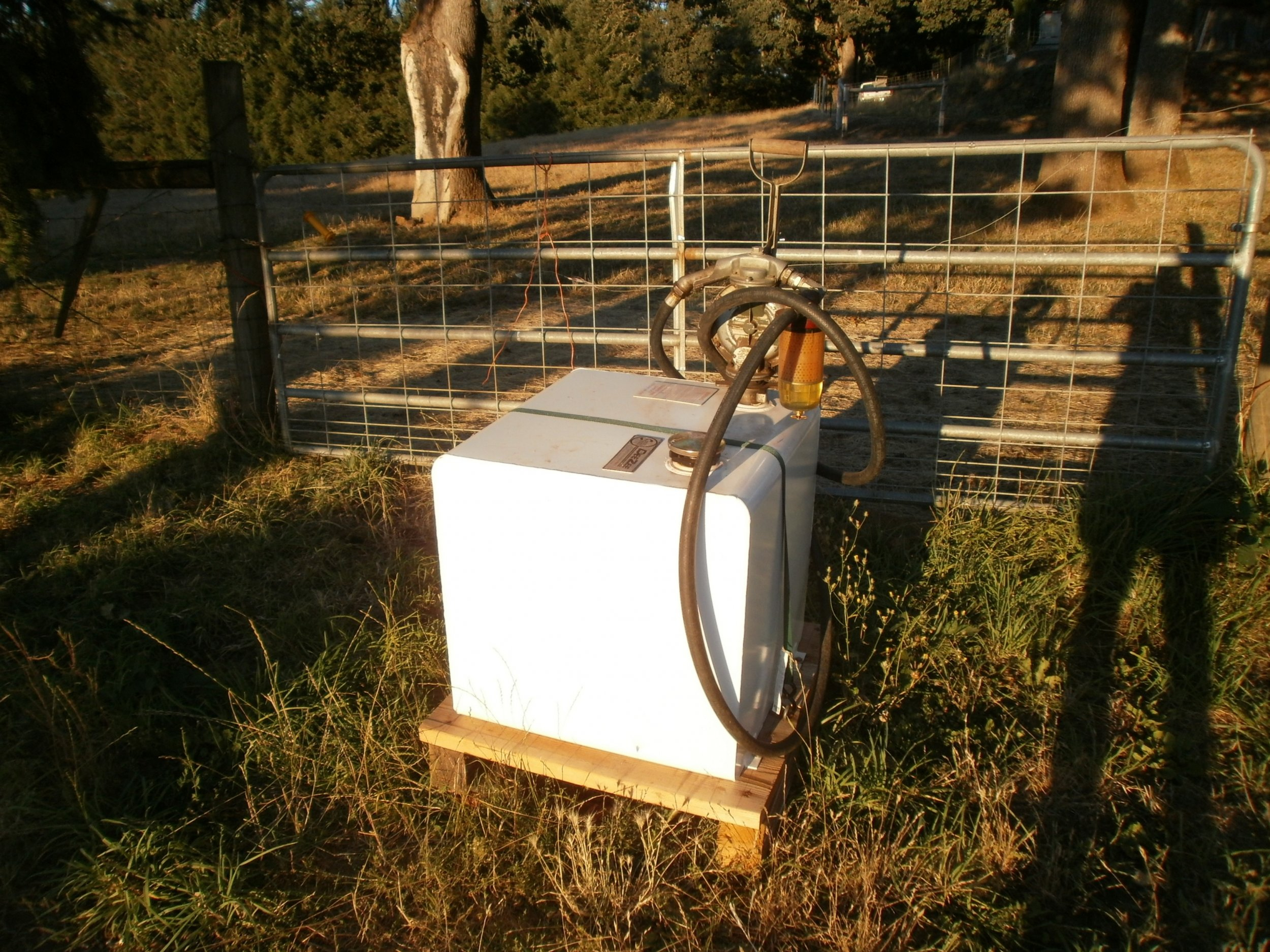

I'm at the stage where I don't need a big tank anymore. I don't need to have a hundred gallons sitting in the back of my pickup all the time, either.
This fifty gallon tank mounted on a small pallet fits the bill for me now. It sits in the shed. When I need more fuel, I load it with my forks into the truck, fill it up, then unload it. works for me.
