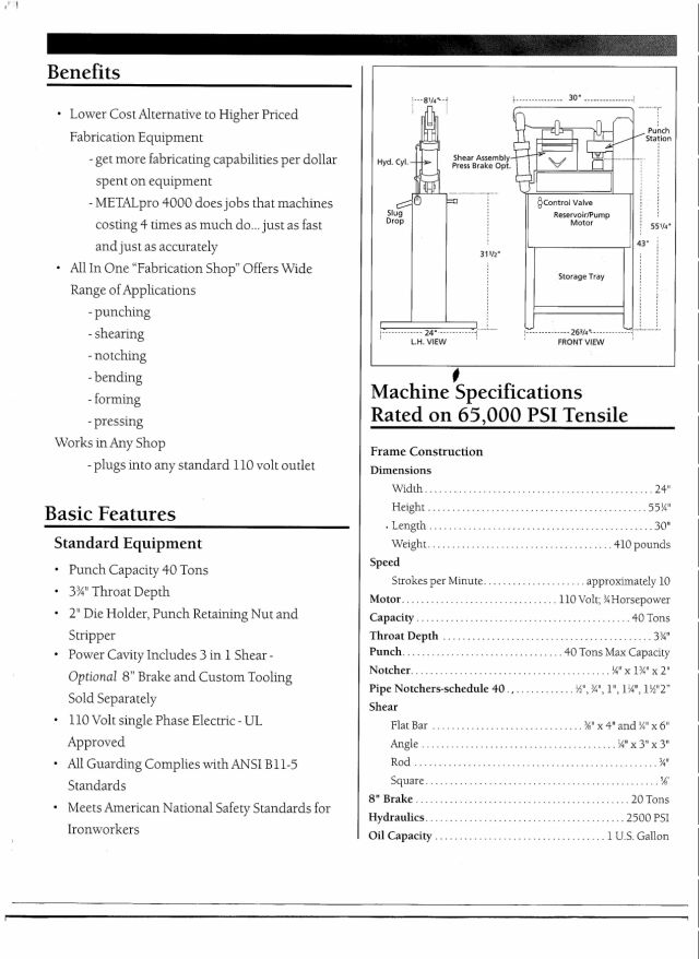

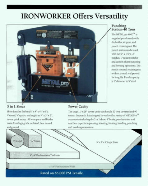

JimC, tell me about the "metal worker", what exactly will it do? Photo? Thanks. Stanley
   / Forks for a BX2200
#12
A litle bit of everything.
Handiest tool I ever had, I guess it could be called a home version of a larger professional tool.
Photos attached
#13
Here is photo from the brochure.
the first was the specs

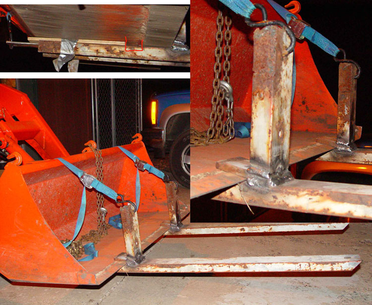

   / Forks for a BX2200 #15
JMP,
I made mine out of scrap in a weekend because I had a tiller and aerator comming by truck so they aren't pretty by any means but worked wonderfully. I used some channel for the forks and stuck them out 3'. I welded tabs on to chain them on but found that by setting the plate under the bucket to start w/in 1/2 the length of the piece over the lip they would lock on to the bucket and coudn't be removed w/o removing the load to lift them up and off. The red mark in the top picture is the critical distance I'm talking about. I taped a wood spacer on to make sure they would go on an off when getting the distance right. Since they couldn't be removed w/o the weight off or breaking the weld I used straps to hold them in place and keep them from moving side-to-side when unloaded; there is no weight held by the blue straps.
My Wife was impressed enough to offer to paint them when I get them cleaned up /w3tcompact/icons/wink.gif.
I hope that sparks some ideas for you,
Michael
