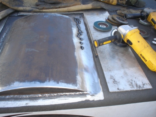

This is what Pete looked like leaving this morning.
BTW the customer is a TBN member but wasn't familiar with me or my constant hogging of TBN's bandwidth.

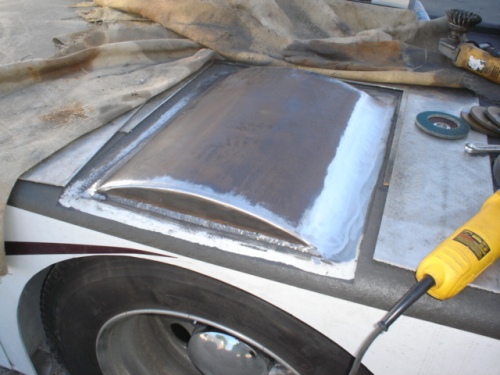

The enhancements worked out just fine. Customer's happy and I'm happy.
The world is a wonderful place.
Here's Pete getting his finished but unfinished washed off.

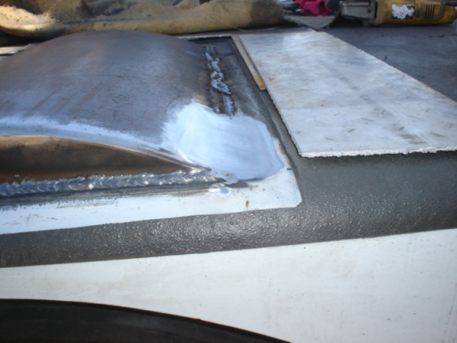

Nice Job Harv, How did you get the rhino material to release from the bed so cleanly?

We scored it with box knives and then removed it with putty knives. It was surprisingly easy.
But then I was watching. /forums/images/graemlins/grin.gif /forums/images/graemlins/grin.gif

OK thank Harv. I was guessing scoring it then using a wire cup brush on the grinder. The putty knives sound like a much easier solution /forums/images/graemlins/grin.gif

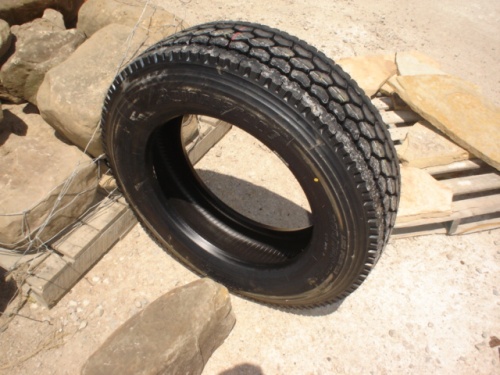

Nice job! Too bad about the tire, I know how you feel. I've had my share of paychecks go south due to the OOPS! factor.

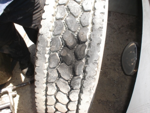

It's a non-asbestos fire blanket. They burn first. /forums/images/graemlins/grin.gif
The reason the tire lit up was because I didn't think (got it?) that a dingle berry would fall through the gap I had in the area to be welded.
One did. /forums/images/graemlins/blush.gif

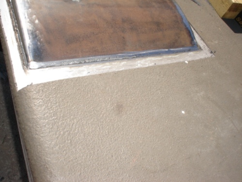

The customer emailed me some pictures of the finished product after the dermatoligist did his thing.
/ Cosmetic surgery
#39
Three sixteenths of Rhino liner will cover a multitude of sins.

/ Cosmetic surgery #40
You'd think it was factory. Once again, nice work.
