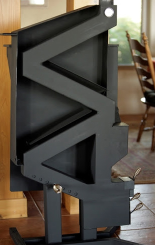

I was doing a little looking over the week end, and found this pellet stove, (no power needed) not the easiest starting but not that hard either,
WiseWay Pellet Stoves - Stoves | Central Point, OR
the flue temps seem a little hot to me tho, watch the video and it is well explained,
This stove is the first and only EPA-certified and UL-listed Non Electric Pellet Stove on the market today. The WiseWay Pellet Stove accomplishes an overall efficiency rating of 75%. Impressive is its ability to heat from 800 to 2,000 square feet of living space. A 40-lb. bag of pellets will last up to 31 hours on low or 12 hours on high.

I will supply electricity for an extra 10+% in efficiency on the pellets. Many pellet stoves run 85+% efficiency.

That is one cool stove.... I like it.... You could plumb hot water to heat the floor of the green house or your own dwelling..
