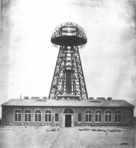

Maybe they could set up some Tesla Towers like Wardenclyffe?
