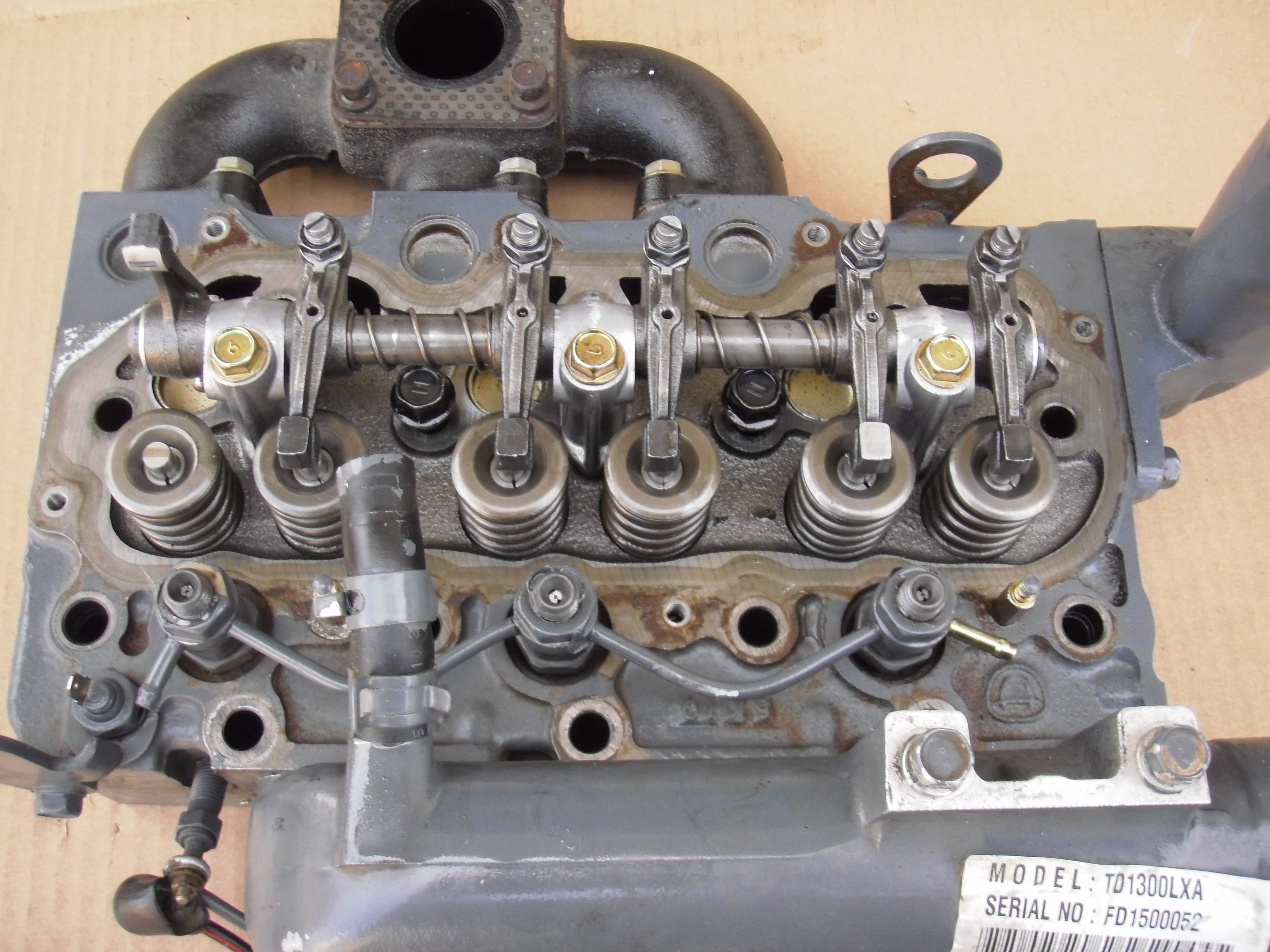

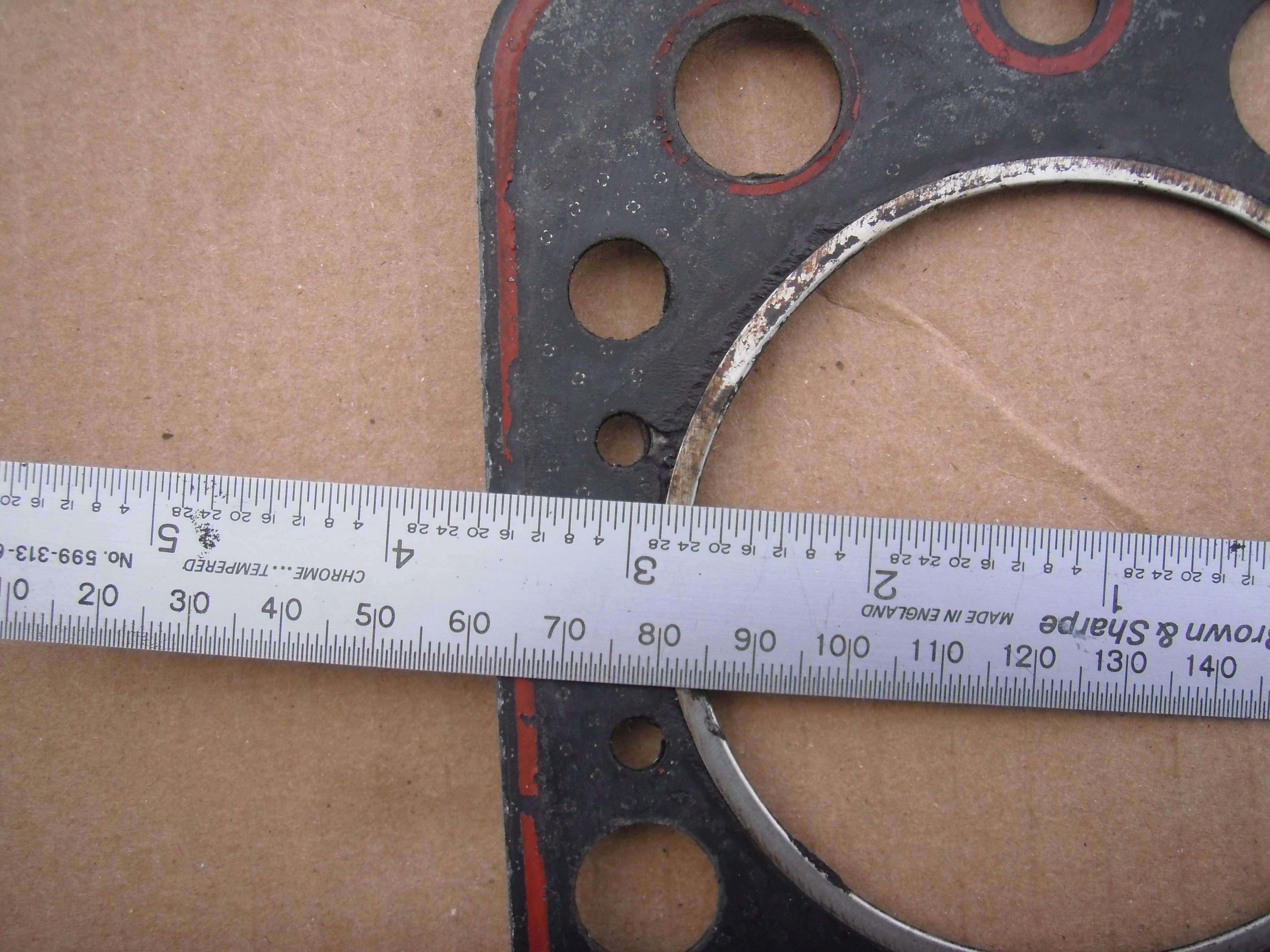

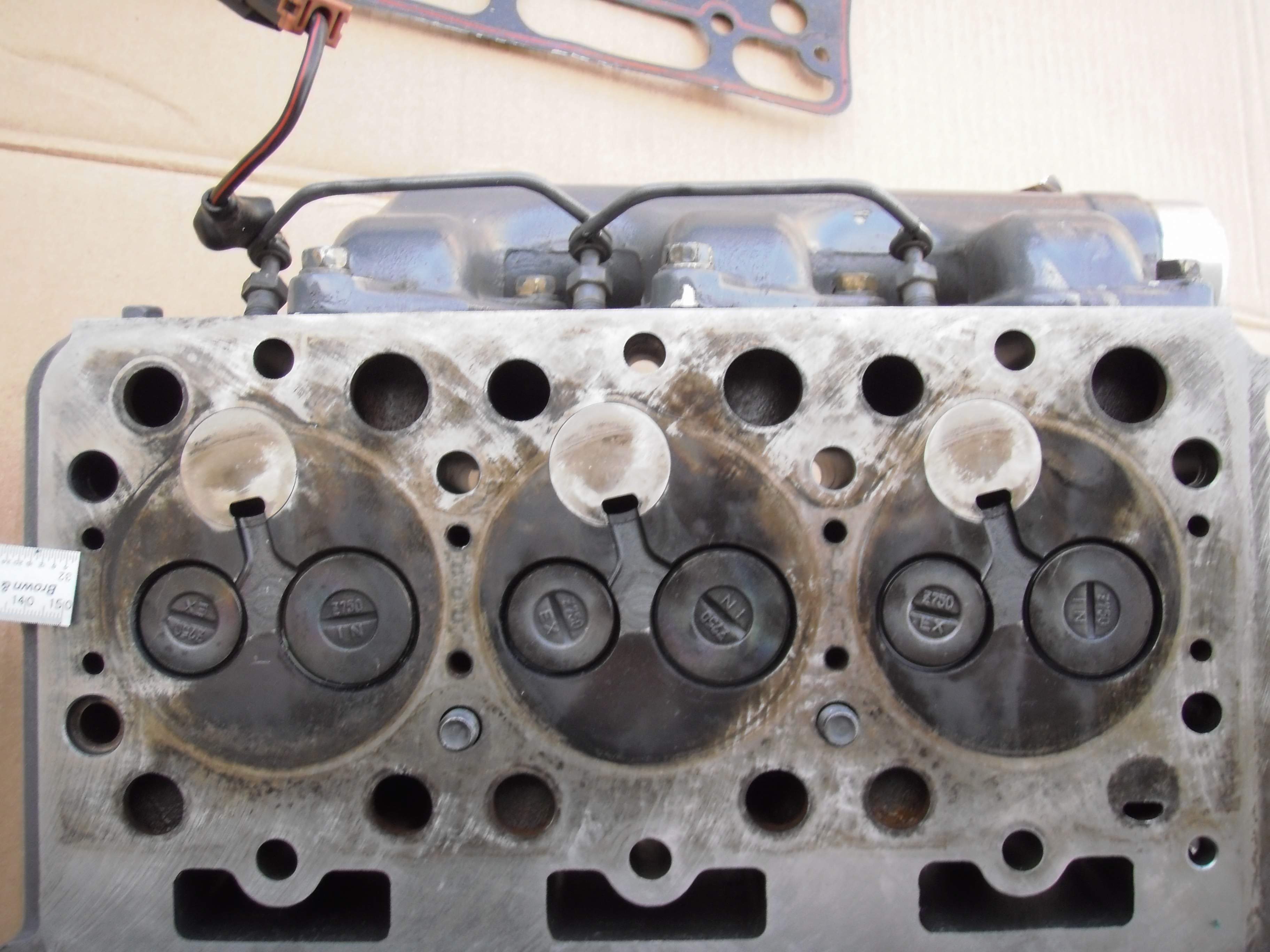

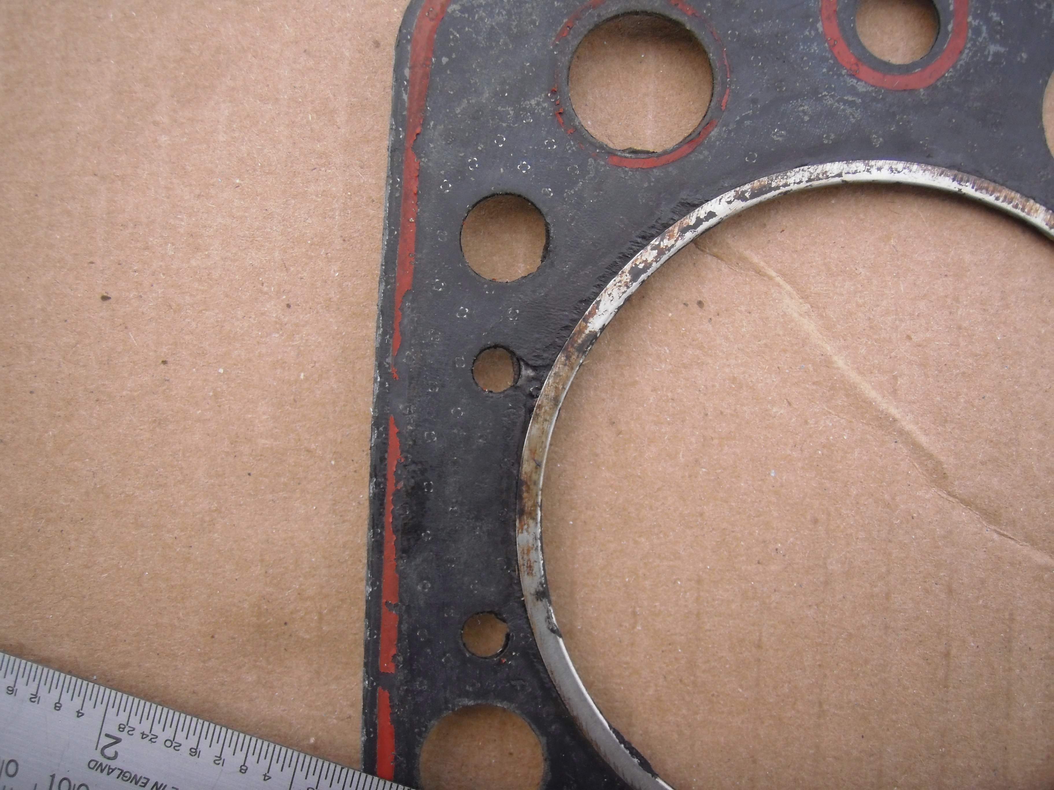

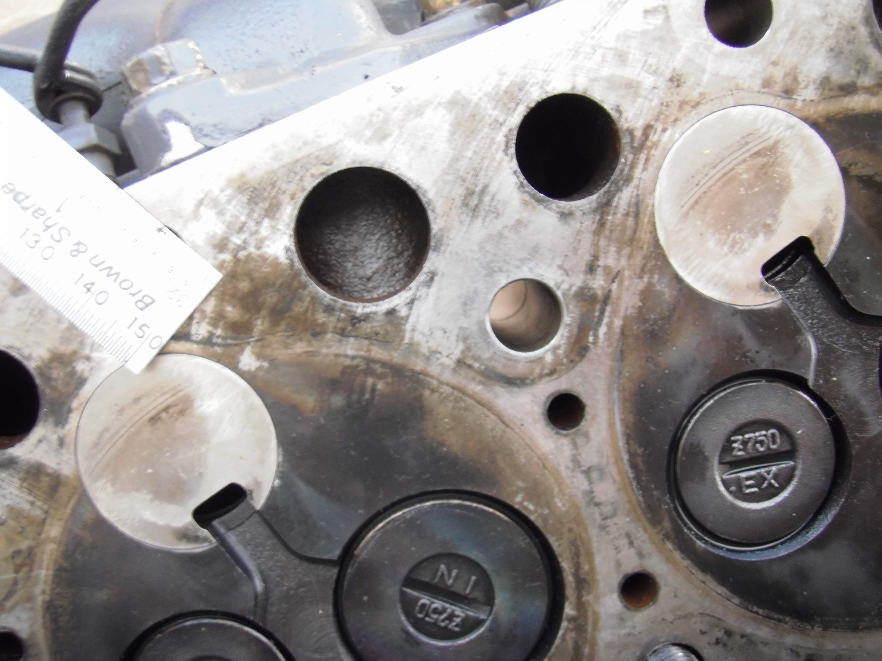

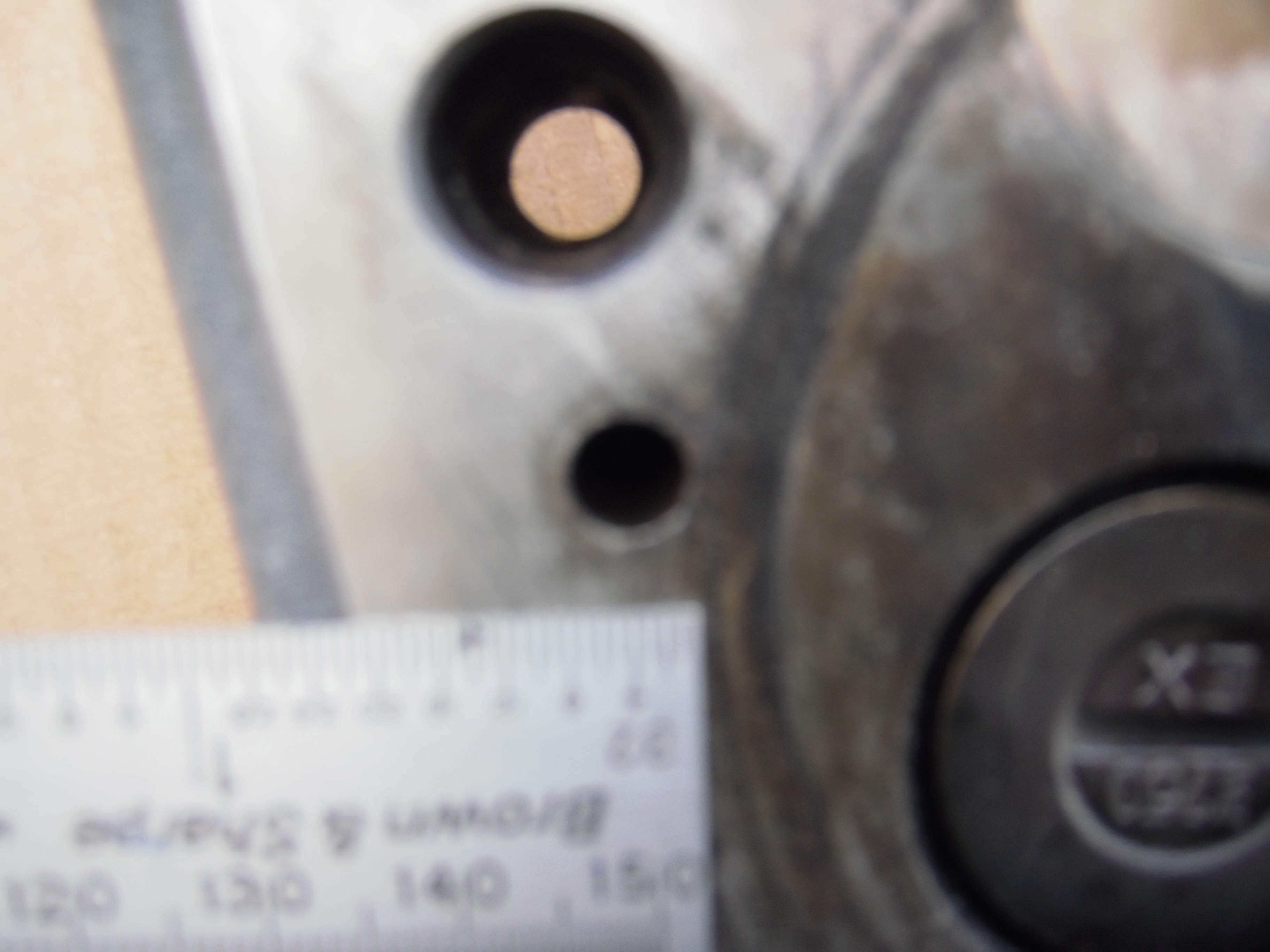

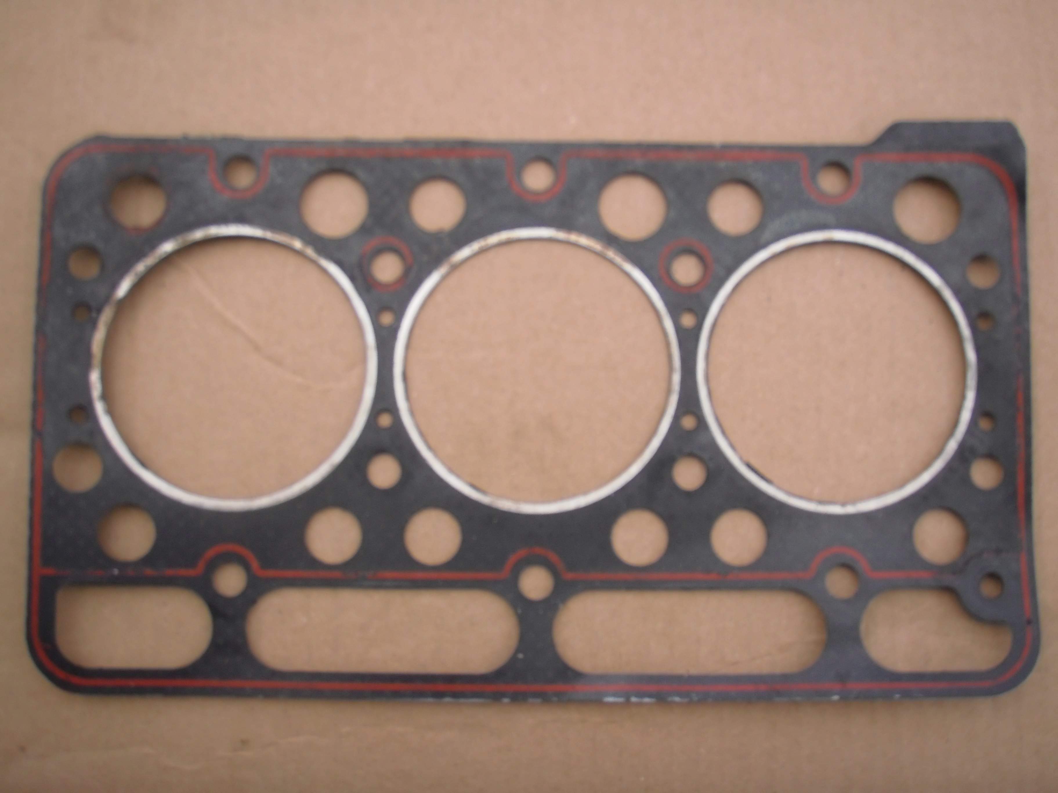

I finally found some time to get the head off my tractor. I have attached a few photos of where the head gasket failed. After looking at the design I am surprised that this has not happened often and there is no mention on any board of Kiotis with head problems. I think the coolant holes are too close to the cylinders. This causes the gasket to not be very wide in this area. There is only about 1/8 of gasket between the 480 psi cylinder and the 12 psi coolant holes. From discolorations on the head I would say there were a few spots leaking on my head gasket and it has been leaking for while. Even though I had not seen the white smoke until the final failure. I fully expect it to fail again, it took 501 hours to fail this time.

It'll increase your costs of course but you may well want to consider replacing the head bolts as well. I'd be real exacting with torque and re-torquing. If the books calls for it or not on the re-torque. Maybe even 50hrs down the line. Just as a tid-bit I remember a few years back Ford had lots of problems with their V-6's head gaskets. Gasket looked a whole lot like yours. Solution was eventually fixed by Ford with a new gasket but for most of us we just went to Fel-Pro for the solution. Best of luck!
   / coolant recovery tank gurgling #27
Don't be so pessimistic.. It'll probably never happen again. Are you going to check the head for flatness?
#28
Yea, I stoned both surfaces lightly to clean them up a bit. The tolerance for flatness is .002" and I didn't see anything with a precision ground straight edge and feeler blade.
   / coolant recovery tank gurgling #29
That's good to hear. Did you get the new gasket yet? How much?
Maybe check the bolts and block, that they were tapped far enough. Probably just wasn't torqued enough.
