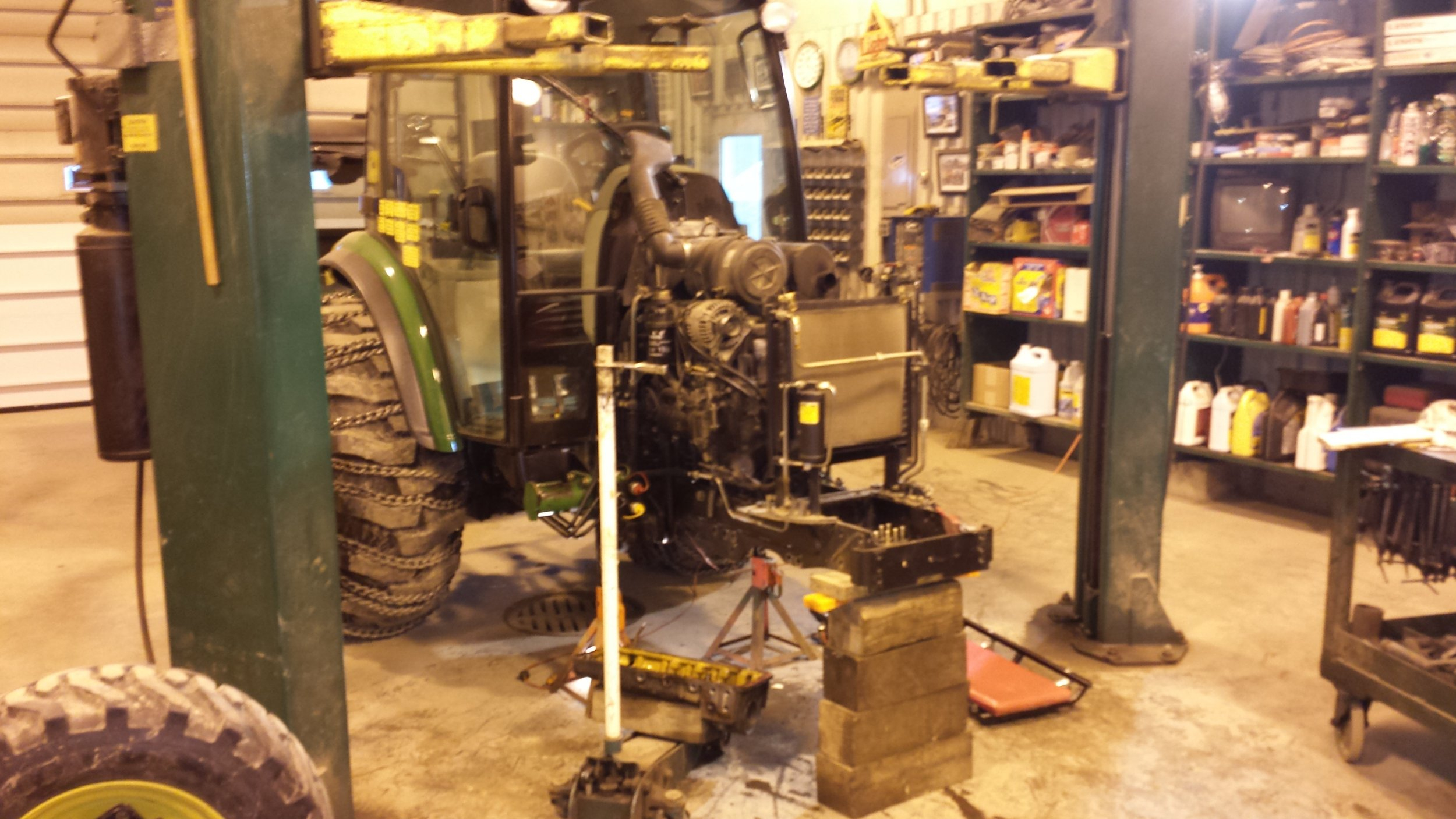

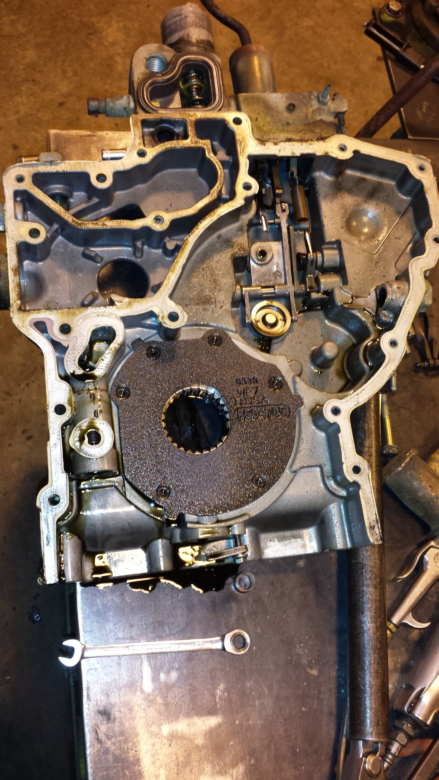

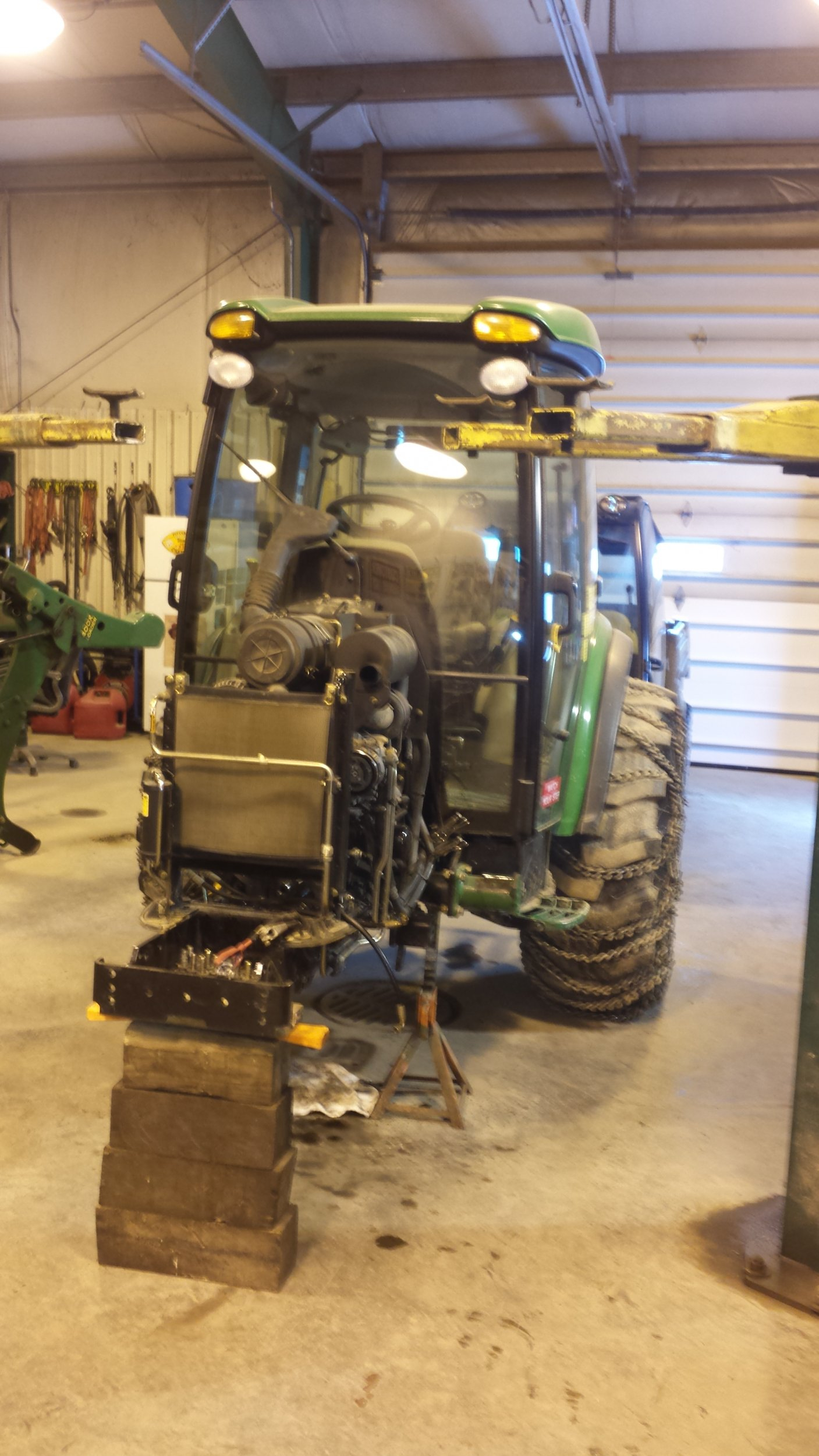

Shelton, I just saw your post. For $6600 I would do this repair all day long. There is a gasket for the forward end cover. It is a steel gasket with an embossed center section. See the picture of the kit. I did the repair myself at around 1000 hrs. I now have 2300 hrs on the tractor and there are no coolant leaks. The water pump now has a gasket called out. You need to replace all of the mounting hardware because it is torque turn. At the time I repaired my tractor the basic repair kit was only about $200. There are some other items that you may want to replace when doing this repair. Add the water pump gasket, radiator fan bearing and tensioner idler pully, front axle trunion bearing/sleeves, etc. The engine does not need to be removed to do this repair. Later

I just saw the post. I would replace the bearing in the fan shaft. Don't use the brass shim at the head connection because that just adds another connection that could leak. You need to dress/ file the area around the thermostat because that is where it leaked. That surface is as cast and it needs to be filed smooth as in machined like. Looks at the section of the rubber gasket and you will understand why. The cast in groove does not do any sealing. It more like a locator groove for the rubber gasket. I will look and see if I have the RE 547689. From what I remember it was just a list corrections to be made for various problems. I didn't want to disconnect the air conditioning and hydro cooler. With the radiator out there was sufficient room to remove the FEC. You need to really clean between the side rails and oil pan before you remove the oil pan. Any dirt and or debris can contaminate the later assembly. I would replace the synthetic bearings on the trunnions / front axle assembly. I have the John Deere maintenance CD and and it said to remove the cab to do this work. That wasn't going to happen. If you have a cab tractor they make a high volume water pump which would help in the cold weather for heat. The FEC used stretch bolts so you will need new hardware which I think comes in the kit. I will look for any instructions tomorrow.
