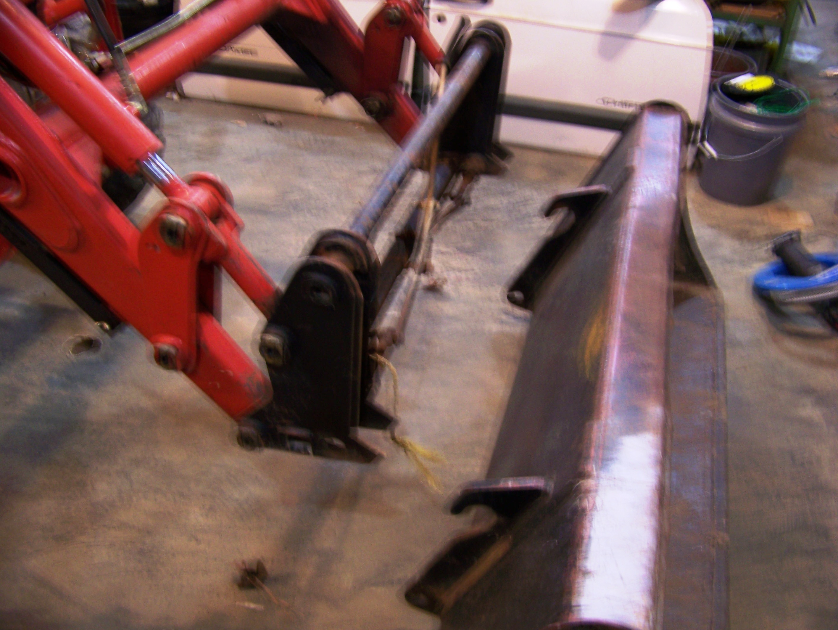

Can you provide a picture of what your system looks like now?

I'm picking up the tractor in about 10 days so I don't have a good photo but below is a link to a post and photo from a previous thread many years ago. The Branson QA is similar to Euro but different enough that Euro attachments don't fit (or so I've read).
http://www.tractorbynet.com/forums/century-branson/356600-bl20-quick-attach-type.html

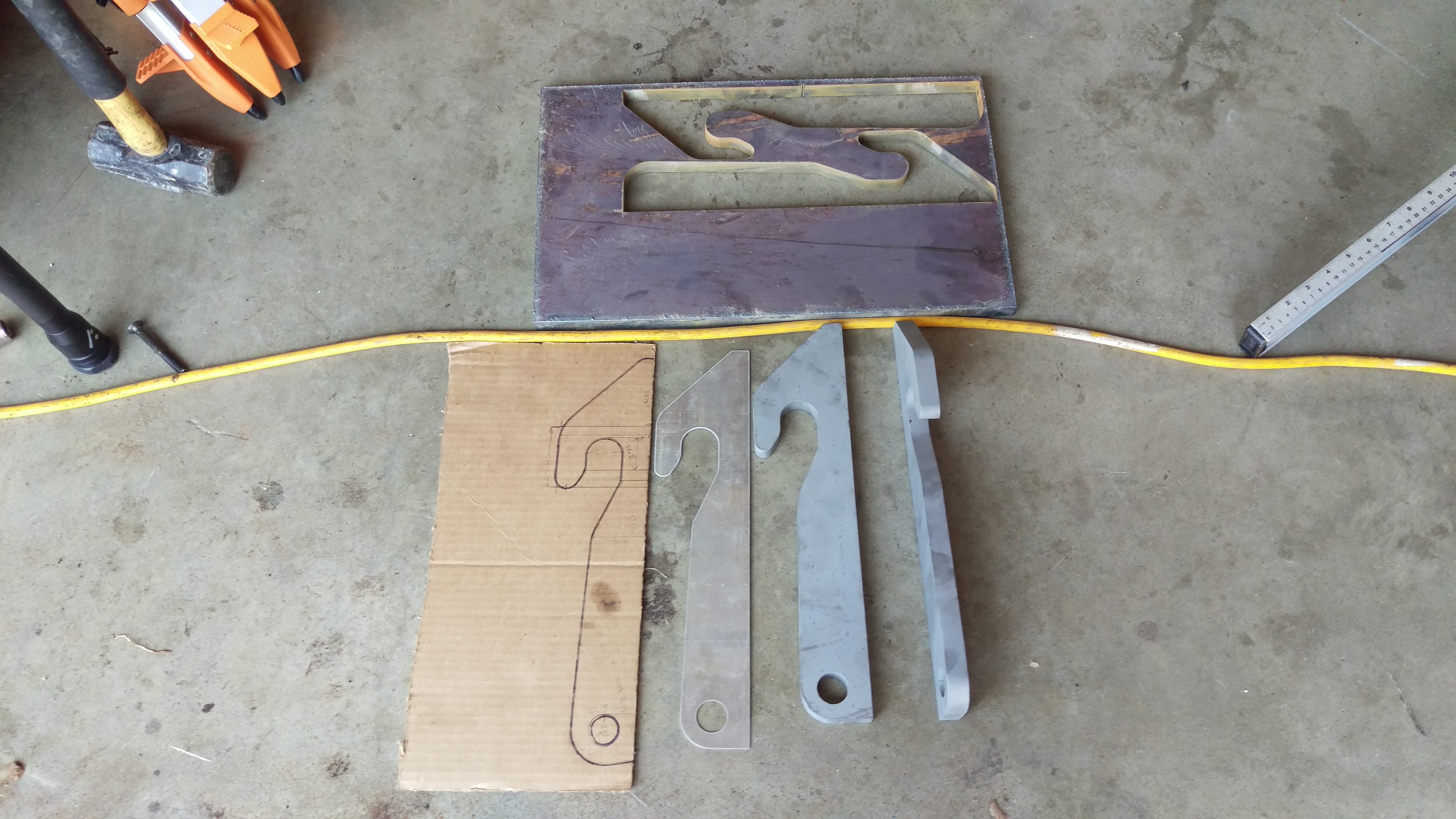

I ended up waterjetting new brackets, then welded them to my fork carriage. I almost built an adaptor to skid steer, then opted not to for the same reason. Now I have the blanks and extra 3/4" material to build anything else I need, although between the bucket and my forks, I don't think Ill need anything else.

I had prematurely ordered a set of global/euro forks before my tractor was delivered, not knowing that the Branson quick attach was proprietary. I created a template and had these waterjetted. Came out great. I then cut off the brackets on the fork carriage I had, and welded these on.

I think everything we currently have on the shelf has been cut off of buckets when we converted same to SKC. So they are not flat on the back, they have a big notch where it wraps around the bottom of the bucket. We use them occasionally for the right application, but you would be better off to make a tracing of the bracket and go down to a metal place and have them cut you out a couple. With the right equipment, it is easy enough to do. We can burn you out a pair on our plasma table, but I doubt we would save you much if any after we have to ship them from the left coast to the right.
