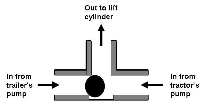

I would not try to run a dump trailer off of a towing vehicle's battery just because that would limit the vehicles that can tow the trailer because they would all have to have high-current wiring. I have a 7' x 12' twin cylinder (double acting) dump trailer. It came with a deep cycle battery and that fresh battery regularly gave me seven dumps with the trailer loaded to its capacity. Depending on how far you are towing, you could recharge the battery from the vehicle. The manufacturer supplied me with the circuit diagram for doing that. If you are doing short hauls and lots of loads, you need two batteries and a charger going constantly on the 'resting' battery to keep up.
To hook the system to the tractor's remote, you need hoses and fittings and a device called a "Shuttle Valve." This one is from Surplus Center. It looks internally like the diagram below. What it does is to allow the source with pressure to power the hydraulics while isolating the other source. This ensures the electric pump/reservoir on the trailer won't have back-pressure and overfill the reservoir if there are slight leaks. The same is true for the tractor. There is no danger of the trailer pump's pressure feeding back and sending fluid to the tractor. This configuration was suggested by the manufacturer of my trailer. I have all the parts sitting in a box in my barn, but have not done the mod yet or I'd show some pictures. It's a simple item to add and has the double value of being a "T" for the circuit in addition to being a shuttle valve.:thumbsup:

Both Jinman and J J are spot on with their suggestions, and I definately agree that if using your trailer on short hauls with the tractor it makes far more sense to use the tractor auxilary spool valve rather than the battery and pump built into the trailer...
Here is my own suggestion to bypass the trailer pump, but allow easy reconnection if needed:
1 - Disconnect the hose connecting the pump to the Ram at it's connection with the pump (or valve if fitted).
2 - Extend the ram hose (using a join) to ensure there is enough slack to reach the tractor auxilary output.
3 - Install quick fit connectors (same type as on the auxilary output spool of the tractor) - it will most likely be the male connector on the pipe and female connector on the pump or valve.
To use the trailer on the tractor, you can then simply plug the hose into the tractor spool auxilary. Or to use on a different towing vehicle using the battery pump simple coil the spare hose and plug into the trailer pump... Total cost of doing this here would be around €50 (not sure what that is in $ sorry!)
Also make sure you check the trailer oil resivoir, as it will probably need topping up to compensate for the extra length of hose, and as with J J I'd suggest using the same oil in the trailer that you use in your tractor hydraulic system....
