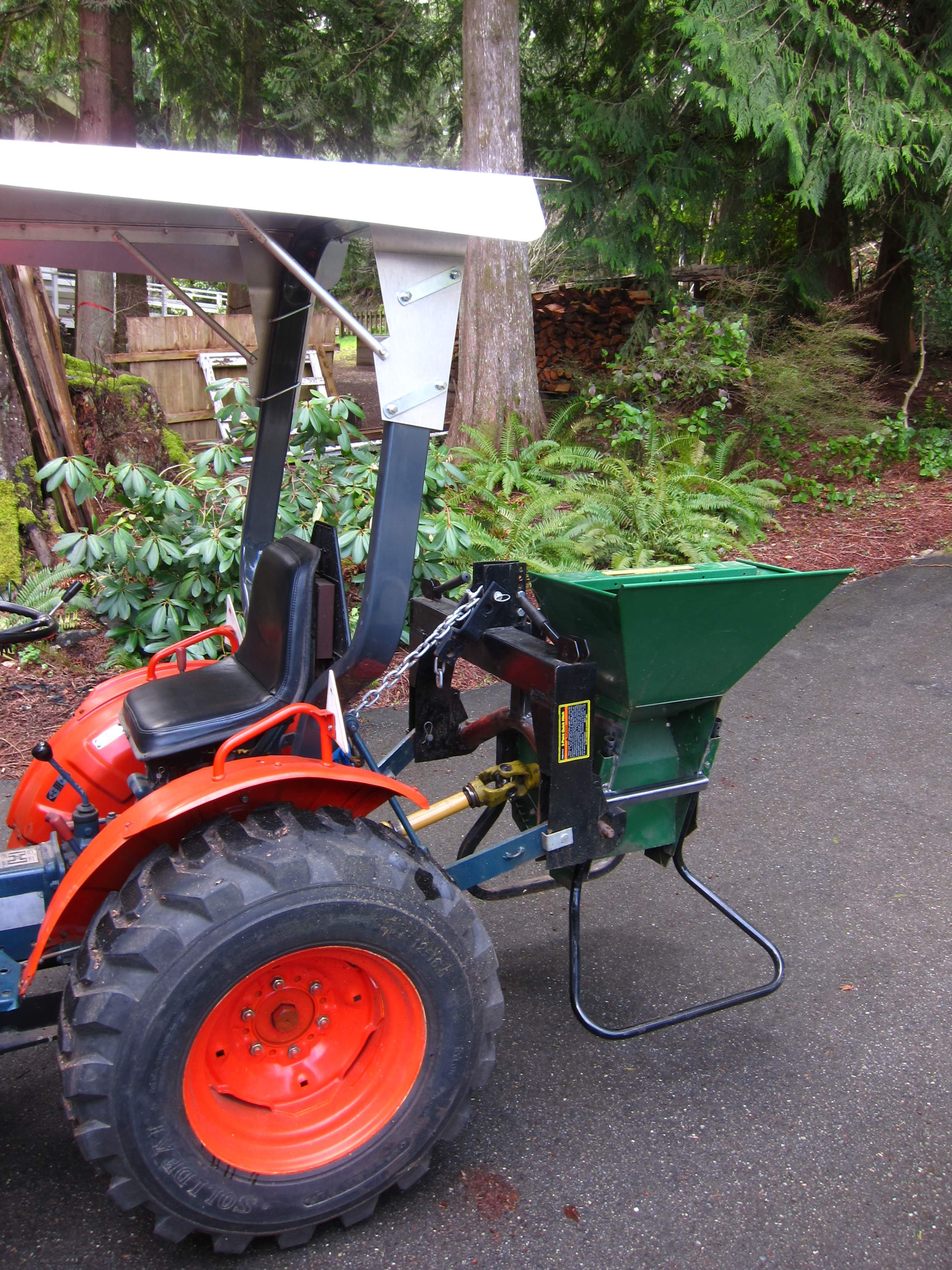

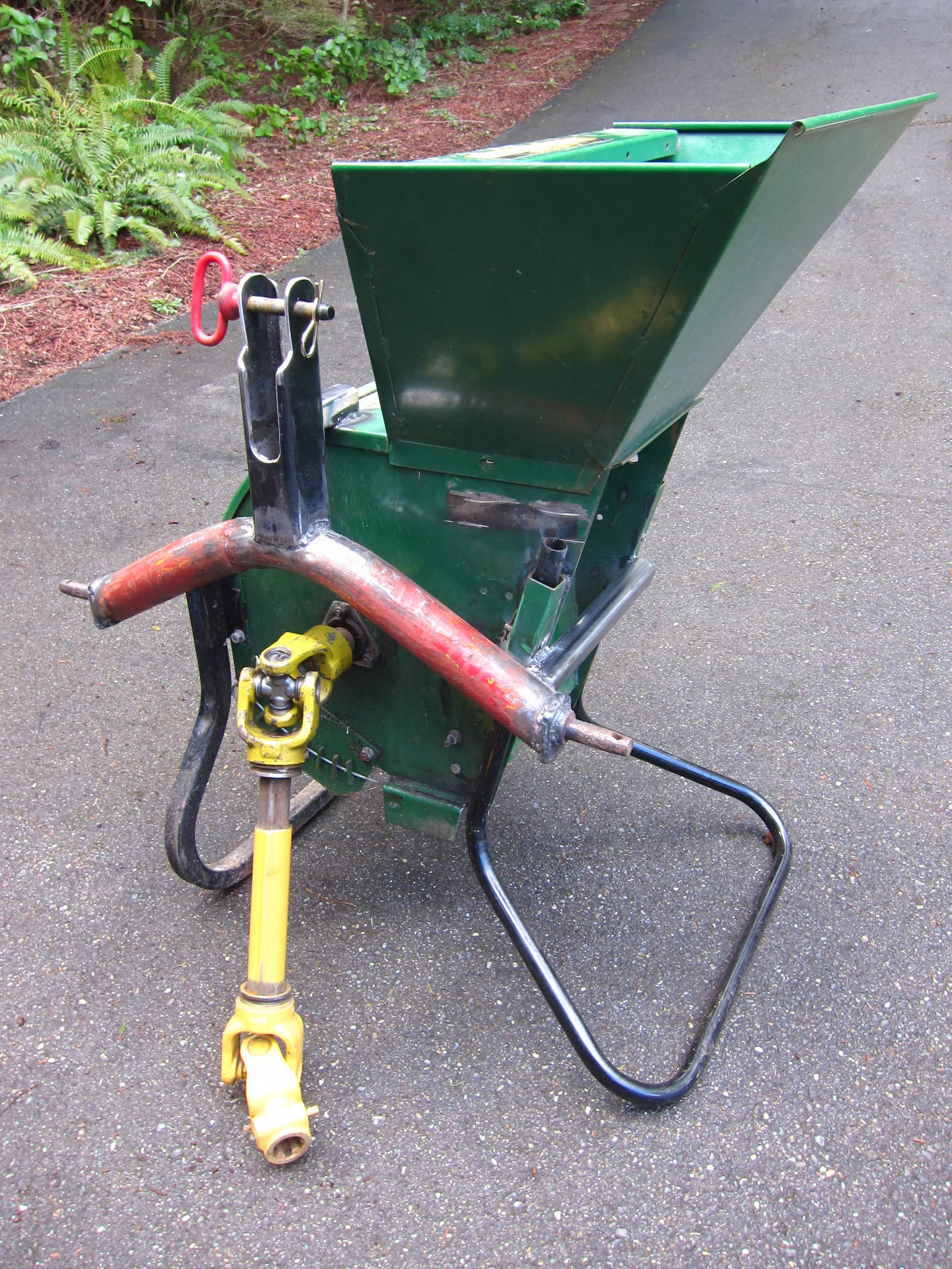

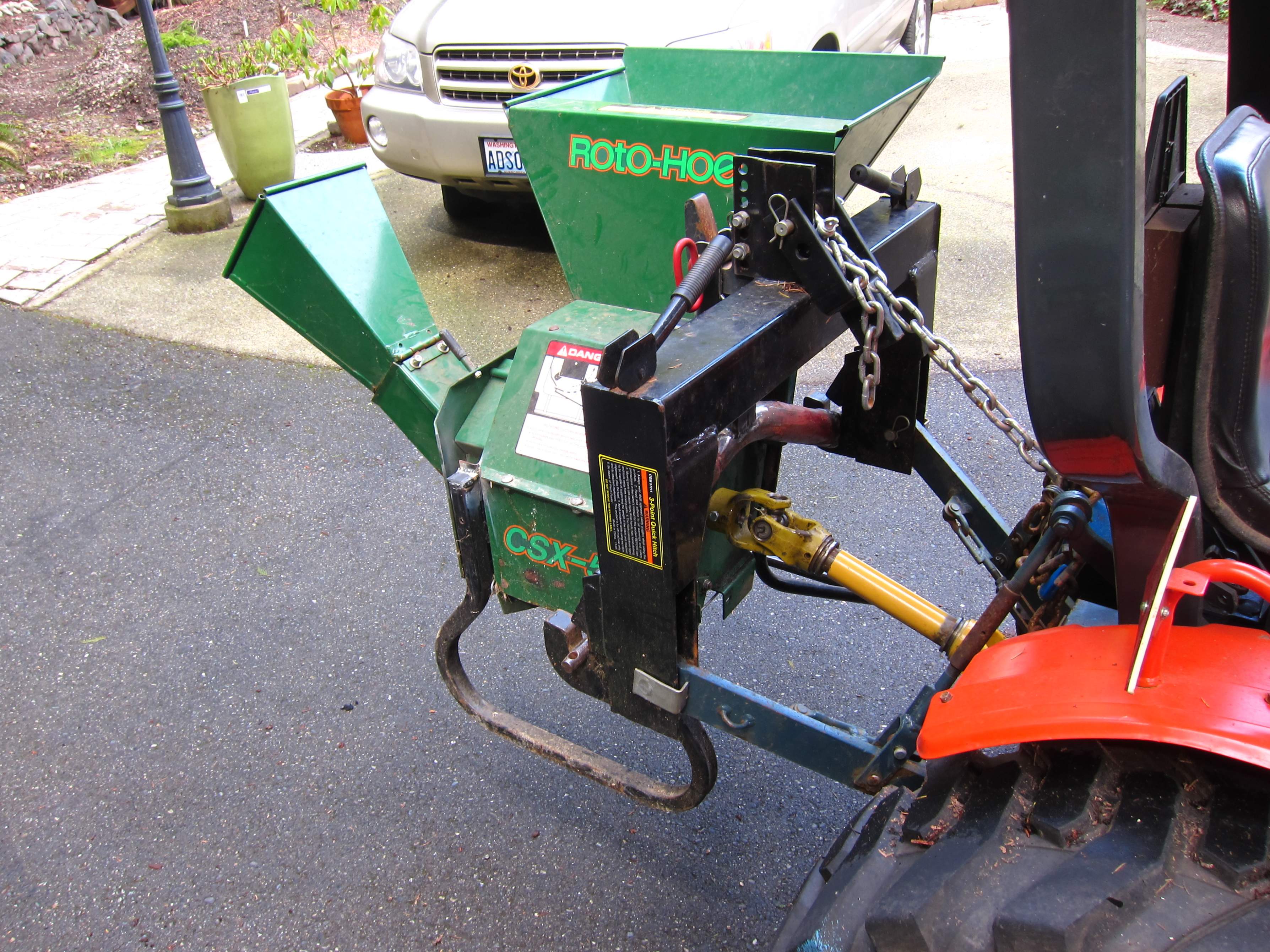

I Know this has been covered several times, but this is my version.
I live in a no-burn community, I have an old (5 HP) Roto-Hoe chipper/shredder that came very cheap from a rummage sale, I have an ancient Kubota B7100 with a three speed PTO.
I got really tired of coaxing the ancient Roto-Hoe into life the two or three times a year I wanted to tidy up the property. If it wasn't hard starting, it was a flat tire, or some other picky thing, the list goes on. After checking all the details such as direction of rotation, shaft sizes, condition of the working parts of the shredder, formulating a general design concept, I tore into the project.
The bottom line, it works like a charm. The top PTO speed of the B7100 is listed at 1000 RPM but I assume that is at a higher engine speed. With the tractor engine at idle speed, during initial testing, the shredder works just fine for the typical annual prunings and yard waste to be converted into mulch.
Final thoughts; it took a couple of days and lots of fiddling to get this done. If I wasn't retired and only had limited time to work on such a project, it might be a tossup. There are a number of places to recycle yard waste nearby. However it is nice to have a way to easily shred/chip usable mulch for the yard, the tractor runs MUCH quieter than that 5HP Briggs, the shredder is way easier to move around, with the wheels and Briggs gone it is much more compact and easier to store, and last, there is little left to go wrong when I go to use it.
One more thing for the safety police, in the pix, I have not reinstalled the PTO shields yet, as I just finished cutting down the old shaft and done the initial testing. Paint, shields, and final little tweaks come next.

   / Converting chipper to PTO (one more time) #2
Hey, nice work ! Looks like it was always meant to be on a three point hitch. :thumbsup:

I'm impressed. :thumbsup:
Was it difficult to attach the yoke to the main shaft? Can't quite see how you did it in the photo.
Good question ... I salvaged the PTO shaft from somewhere long ago, it had a 1.125" x 1/4" keyed bore. The main shaft is 1" x 1/4" key. I looked long and hard to find an available 1" metric yoke with no joy.
So, thinking that this thing is going to be pretty lightly loaded because after all it was designed to do it's job with only 5 HP, I made a slotted sleeve out of some tube, pressed it into the yoke, then reamed it to 1", continued the yoke set screw threads through the sleeve so that the set screw bears directly on the shaft and helps to lock the sleeve in place, replaced the 1/4" key with a 1/4" x 5/16" key, good tight fit all around, so we'll see. If it doesn't hold up, I'll redo with a slightly longer sleeve, and weld in place.
