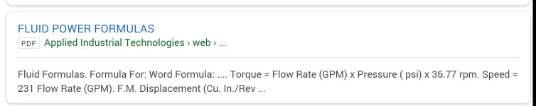

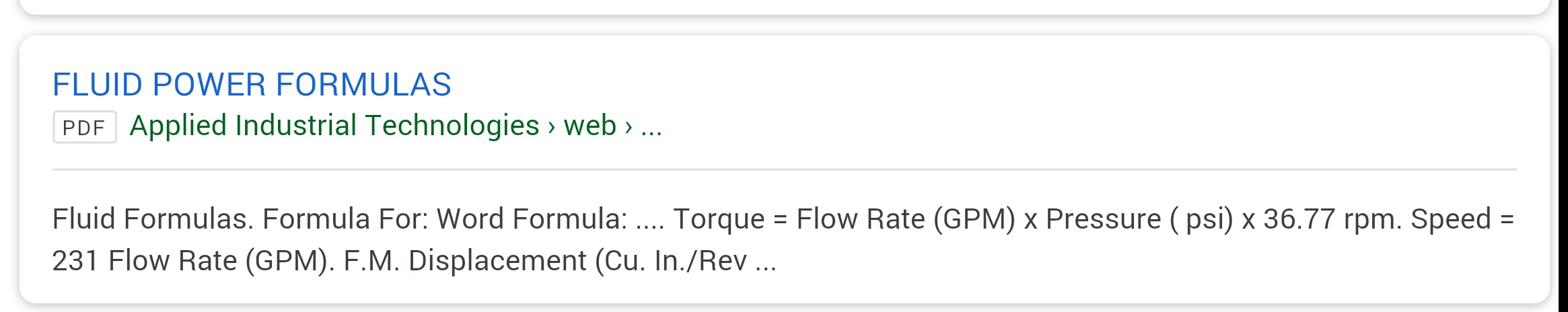

Torque is a product of gpm x pressure.
I disagree to that. Torque is not relevant to gpm. Its analog to the pressure, and analog to the displacement of the motor.
gpm do not affect torque (a measurement of rotational force) . It affects the final rpm (power) or how fast the job will be done. Not the force.
Torque is what he needs to be able to make the hole through the tough ground and rocks
gpm is what he needs to make it faster.
He can get almost whatever torque he wants by defining the motor displacement. Larger displacement motors output higher torque (in exchange for slower rotation)
Check out the brochure http://www.danuser.com/sites/default/files/FormNo_3403A_EP_Brochure_0.pdf
Reading the charts you can see that the gpm only affects the rpms.

Hydraulic torque formula below
