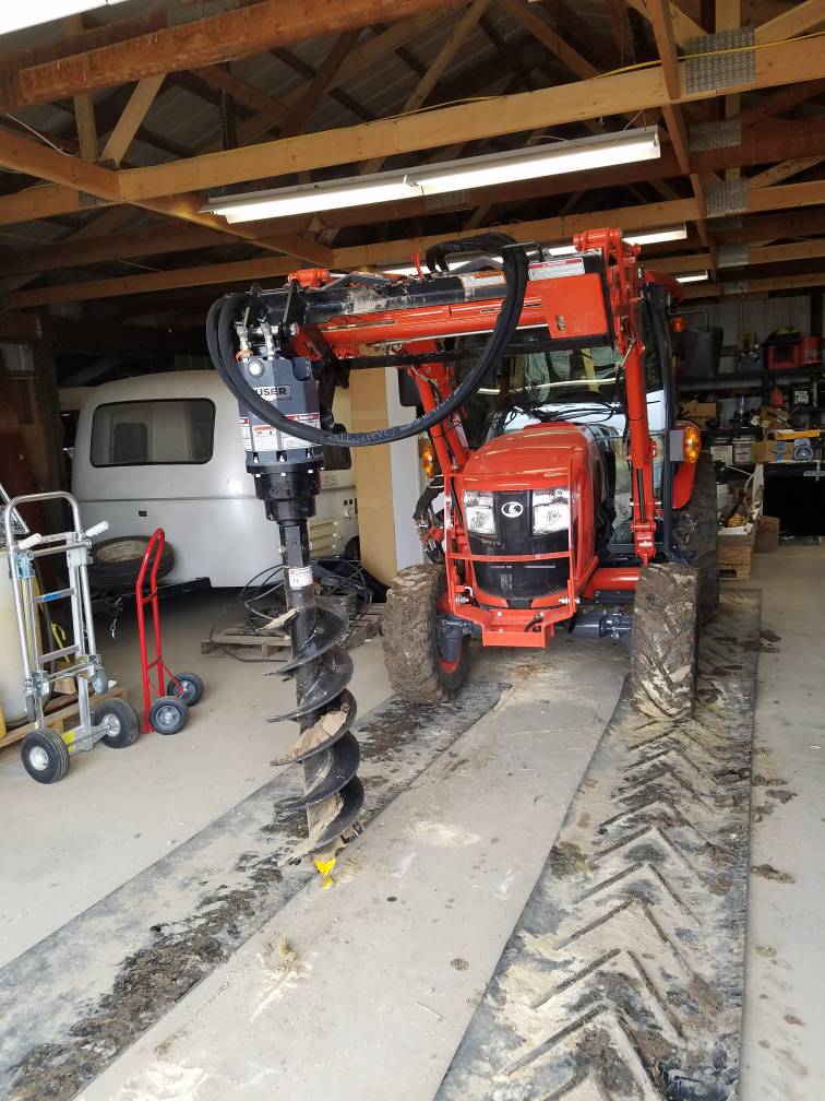

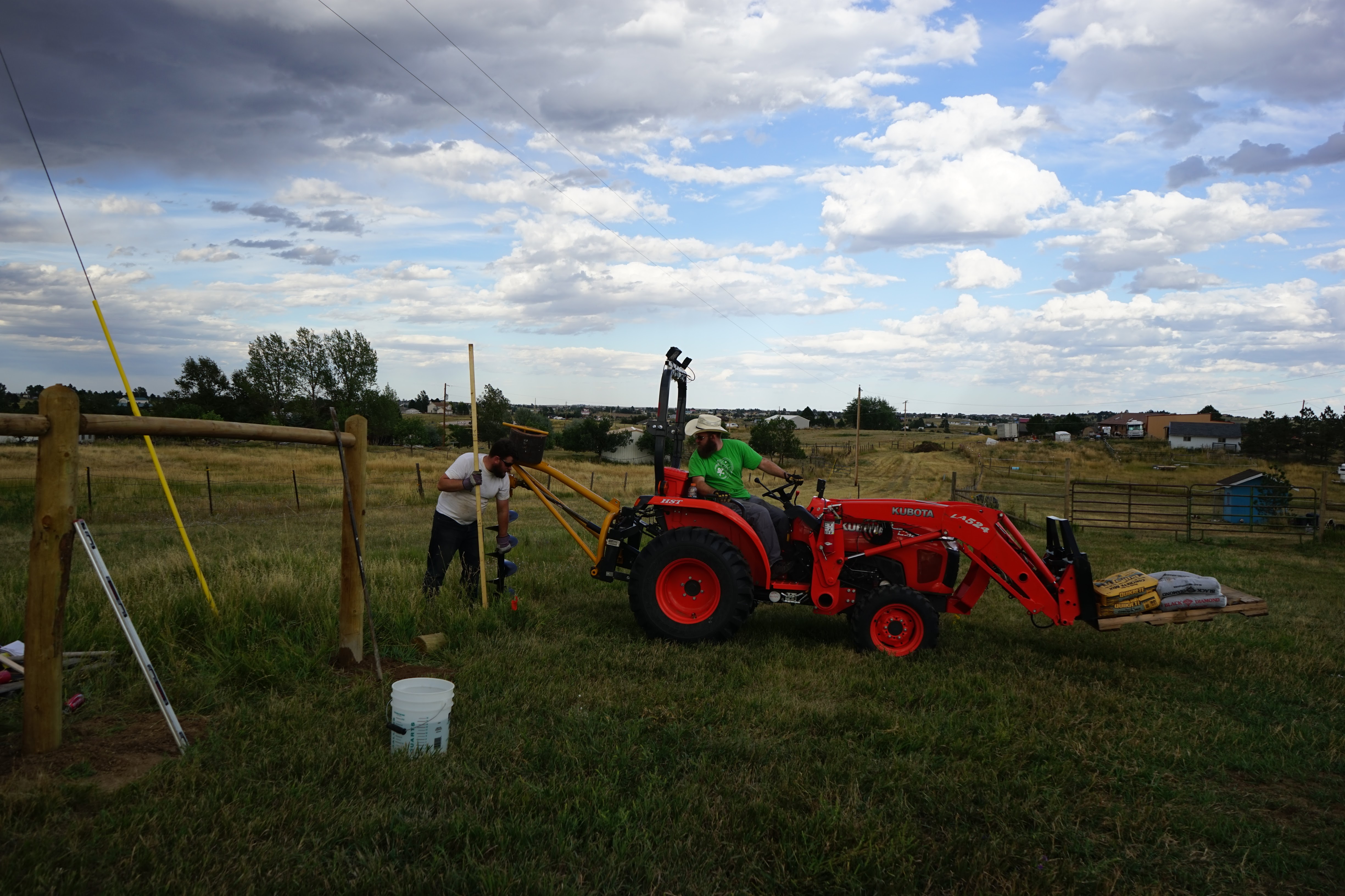

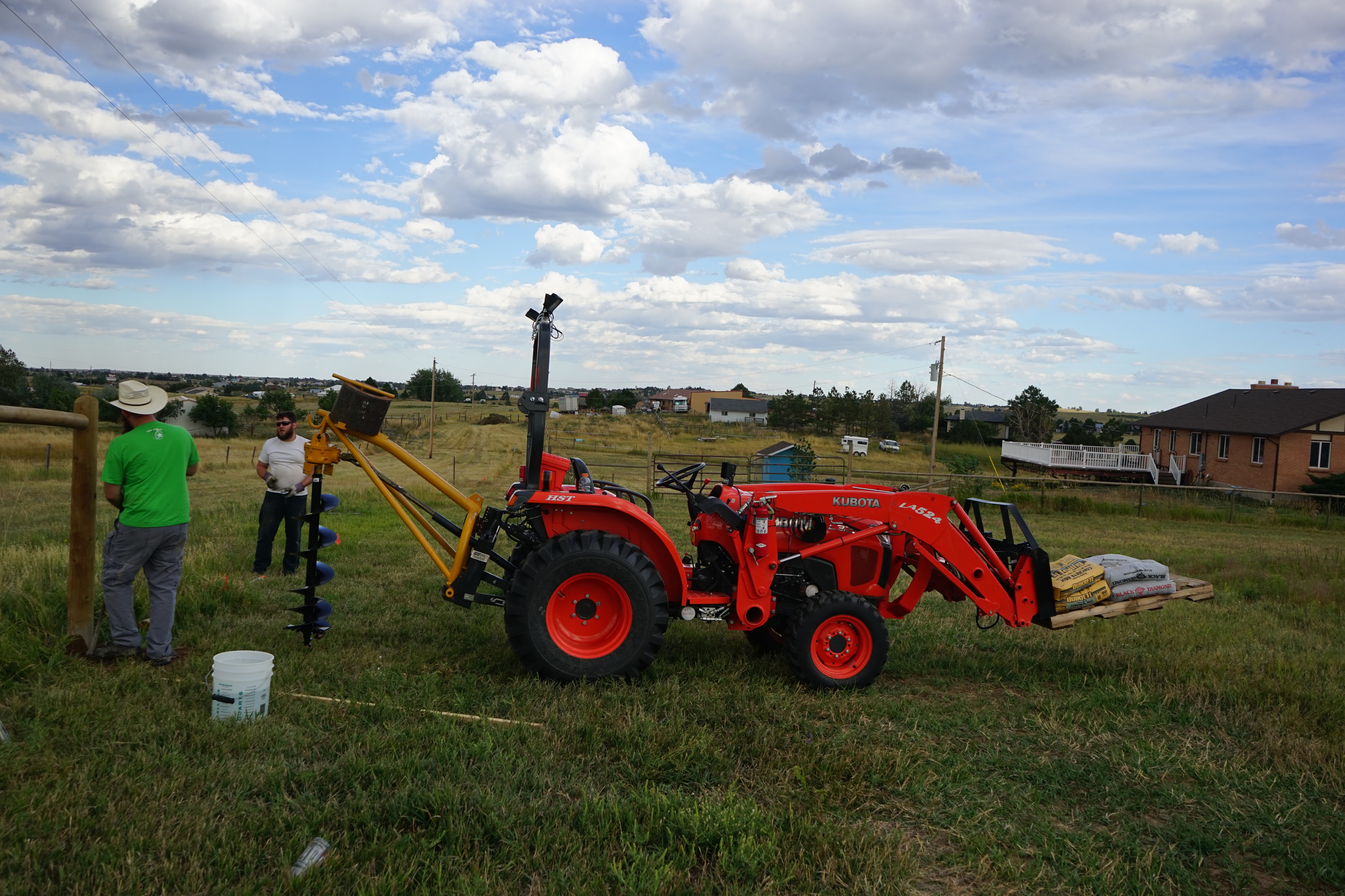

I had a L3200 with a 3pt PHD, 25 PTO HP. Several upgrades on the PHD too. Now have a L4060 with as hydraulic SSQA PHD. I have maybe 10gpm of hydraulic flow, which at 2,500psi is 14hp, tops. It's very noticably my hydraulic PHD is missing over 10hp. The downpressure, reverse, ease of attachment & visibility make up for the lack of power, but it's still missing & noticeable.
If you are going from 25hp PTO or so to maybe 7hp hydraulic I dont think you are going to be happy at all. It's going to be spinning really slow & will have less torque. A PTO powered hydraulic power pack would get you the power & flow for good performance, but will cost at least as much as a new hydraulic PHD. 20170401_133255.jpegDSC06433.JPGDSC06434.JPG
