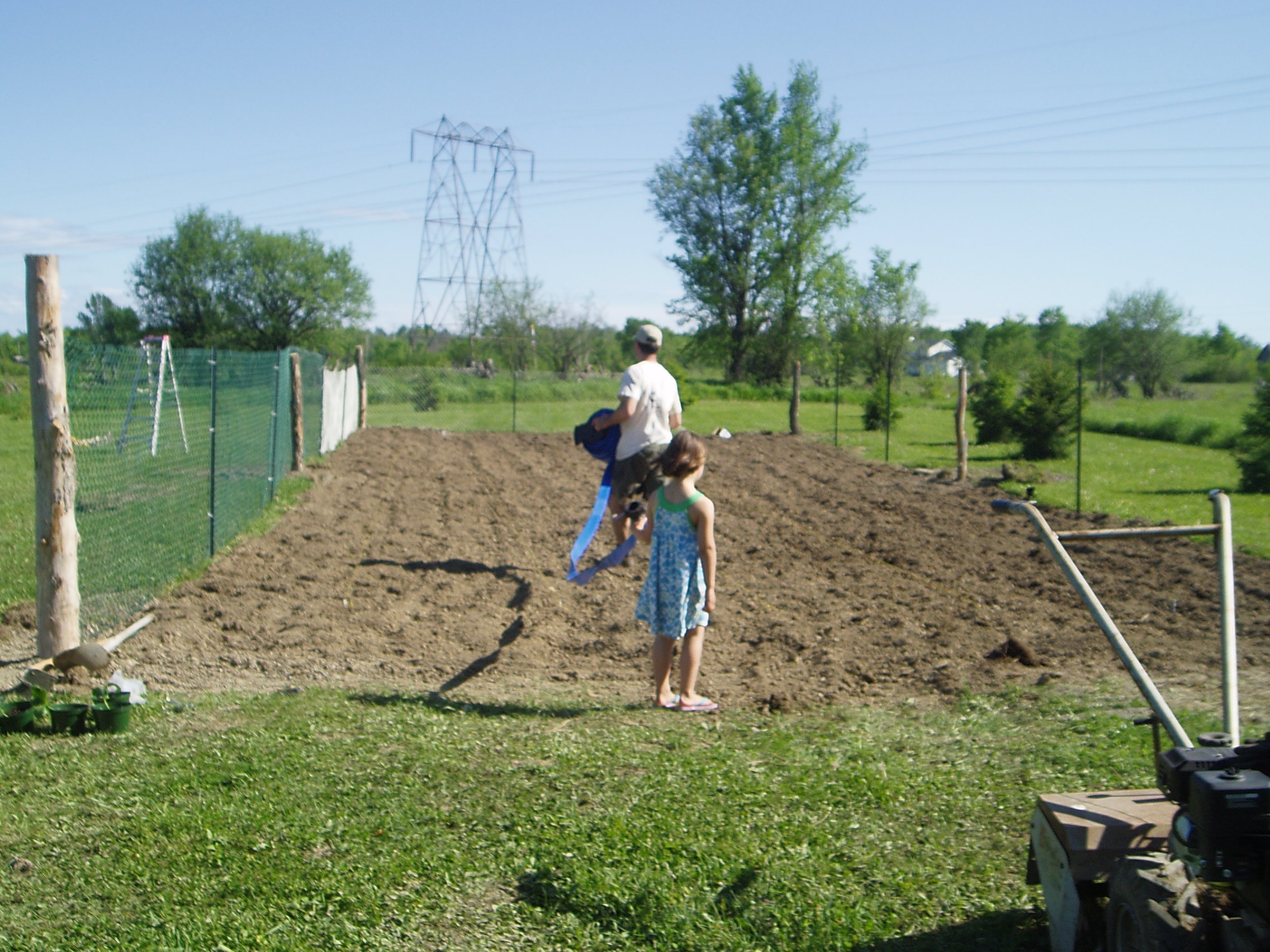

Well, I should have listened and sprayed the grass to kill it, but I scraped the grass off with as little soil as possible, but still too much. I tilled in a little manure, but it was too fresh, so I went very easy one it.
The garden is planted and the pumpkin plants that I started in the house seem to be doing well. Nothing else has shown itself yet, so the jury's still out on if I can grow anything yet.

Isn't that an old 'manual recoil' rototiller? circa about 195?'s
   / Converting a lawn to a garden
#9
I'm not sure, but it is old. It was my grandfathers and I remember changing the oil on it when I was around 16 or so, and it wasn't new then. I'm going to guess it's a minimum 30 yrs old, but not much older than that.

Thats a nice sized garden, and it looks like you did a very good job with it. We have two gardens that equal about the same size as the one that you built. I plowed the ground, removed the grass, and then built the boxes. We then added manure soil, and manure that had been composting from our horses for almost 4 years, so it was pretty rich soil. I did buy a Burpee electronic soil tester at home depot that tests the acidity, the PH, and tells you weather the soil needs fertilizer. It works really well. I did have to add fertilizer to ours, since we also had a slow start, and our corn did not start on its own, so we had to replant more corn. The seeds we had were older, and I did not really want the genetically modified seed, just because I am unsure how healthy it is? Anyways, your garden looks very good, and you may want to test the soil, or add fertilizer if you haven't. My grandfather use to grow about an acre of food, and he would always make a tea, with manure, and water, to add to the plants. He always had huge quantities of vegetables. I hope that the garden turns out well! Keep us updated.
