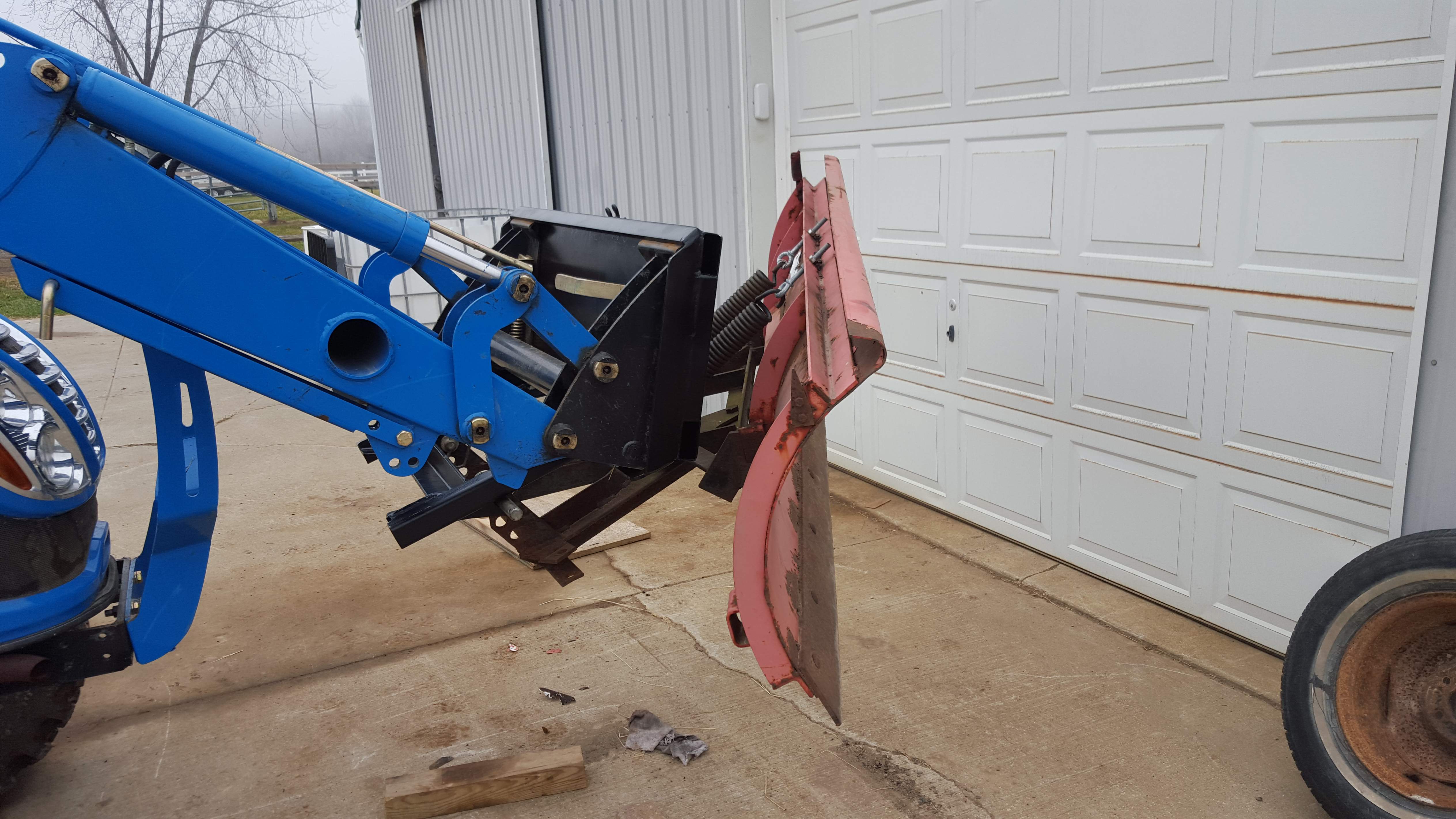

You might just have enough clearance there. This is my latest SSQA snowplow mount modification and it fits my Yanmar LX.

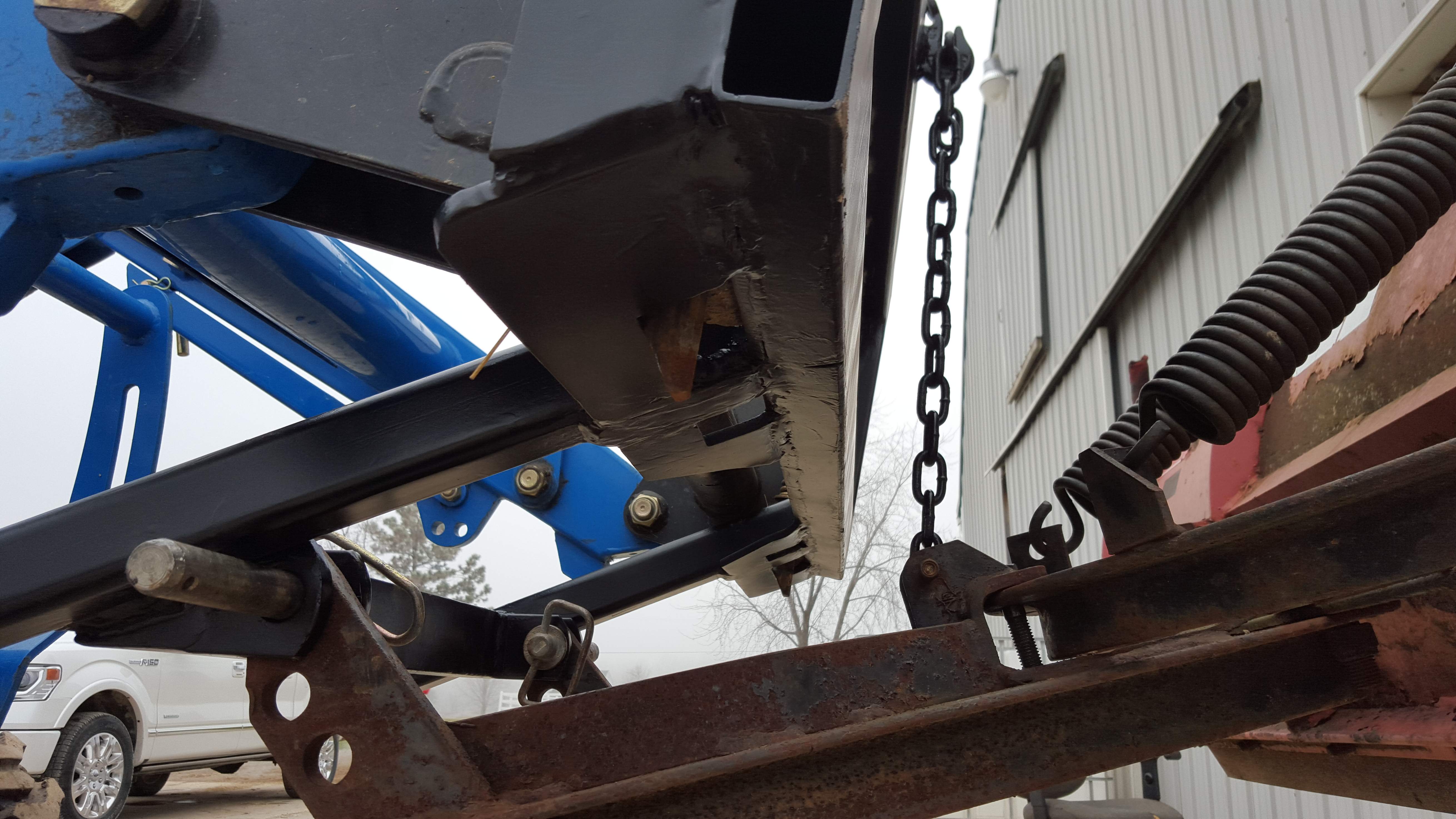

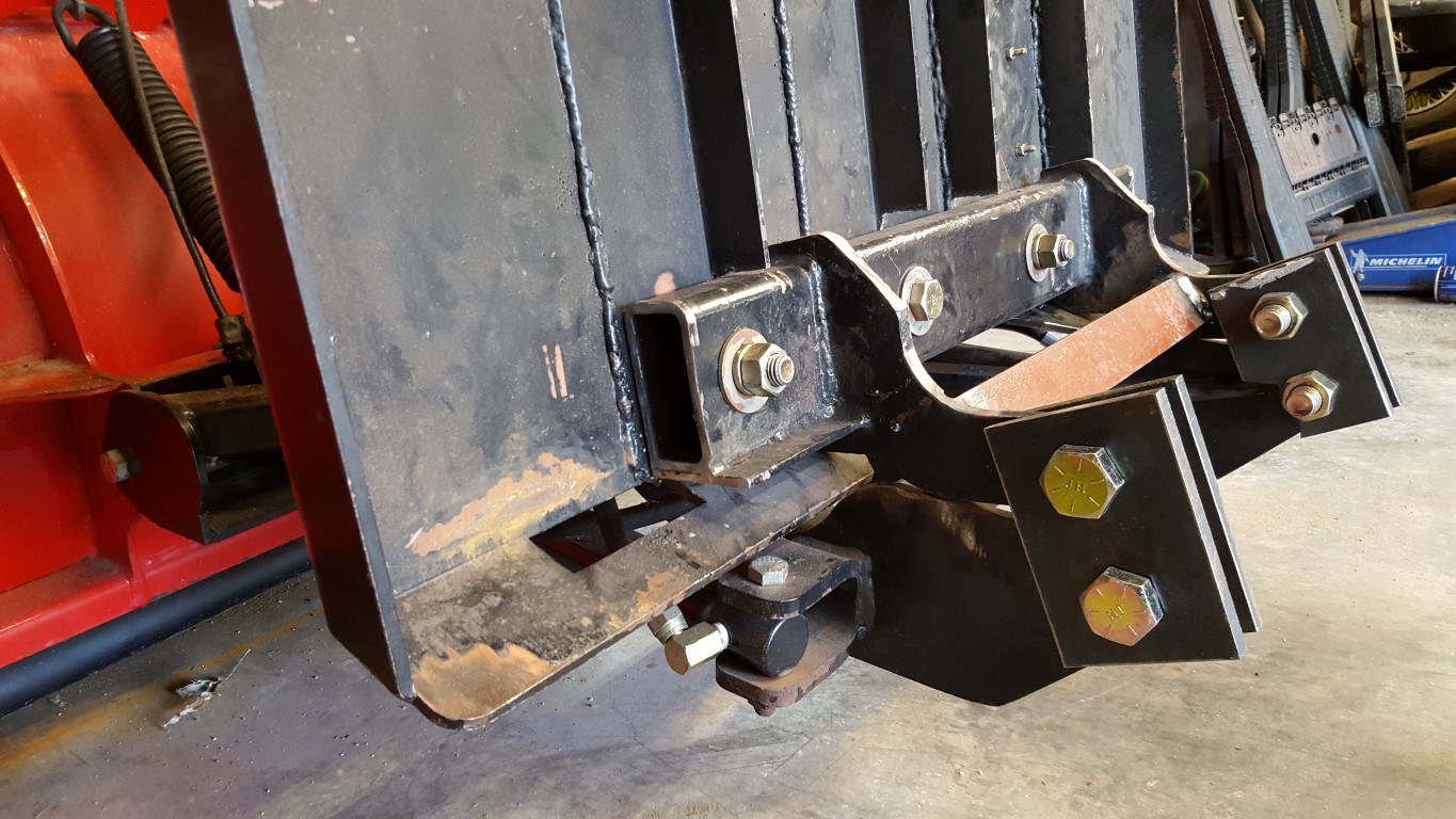

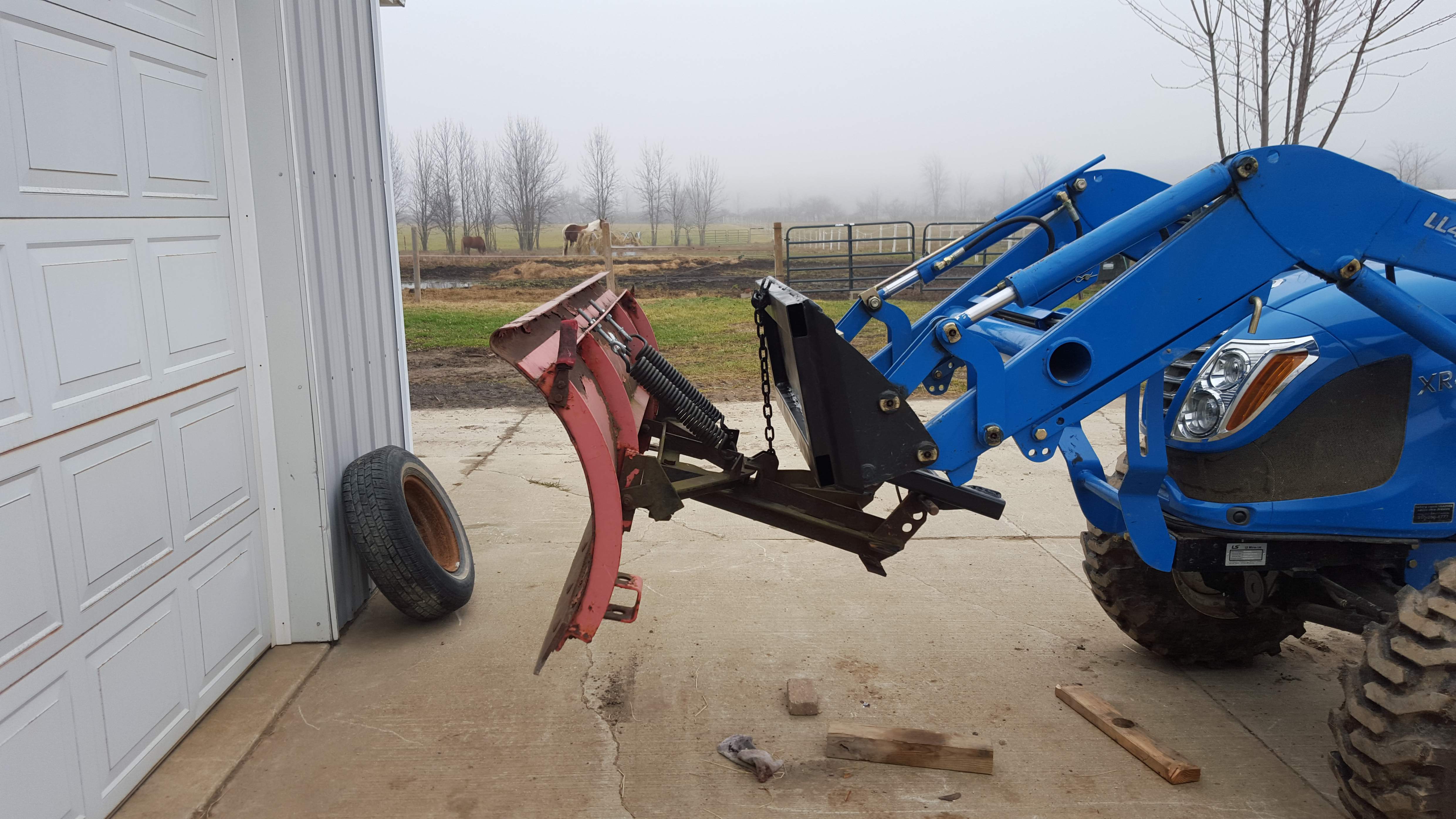

Ok, it works. Yes I test fit it on the LS. Pics below.

   / Converted a Western Snowplow to SSQA.
#13
The cylinders aren't on yet. He's going to use manual angle until he gets hoses made up to go from rear remotes. I cleaned up and painted the old cylinders but not sure of the conditions on the seals. The first picture above is full angle right.
It's a nice warm cab so if it were me, I would be getting the hoses right away. I'm also going to advise him on getting a cross over relief valve.
Probably should get skids for it too or all the gravel will be on the lawn.

He wanted to buy a new one ($1800ish) but I told him I would fab something up if he wanted. He's got $250 into the blade and about $150 into the SSQA plate.
I put another $100 into it plus all my labor but that will be a Christmas gift.
I'm really glad to get this done. If he doesn't paint the A-frame and the blade, I'll do it next summer.
