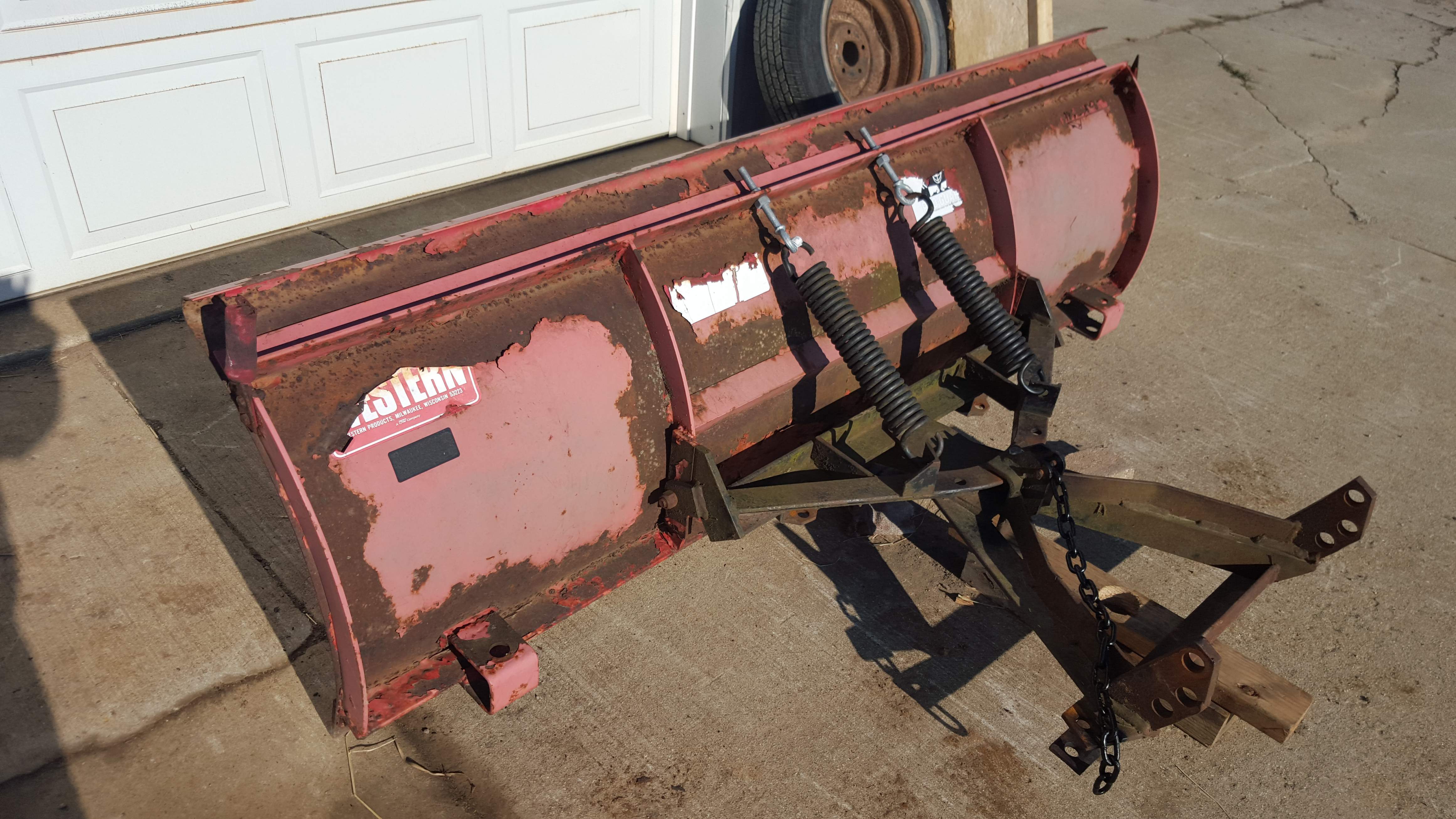

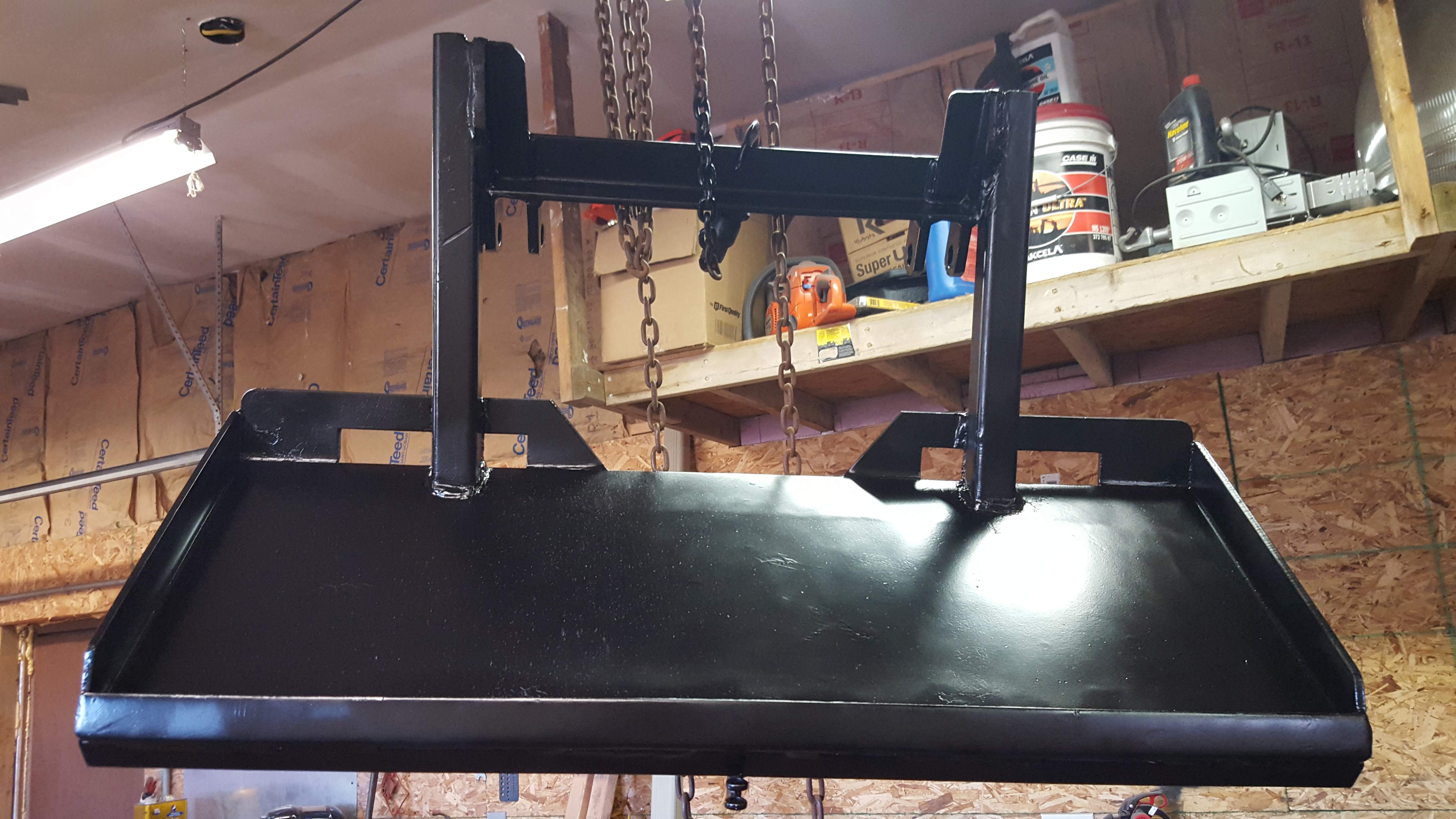

I am almost done fabbing a SSQA mount for my soninlaw 's fel. He has a 40 HP LS. The paints drying on the mount.

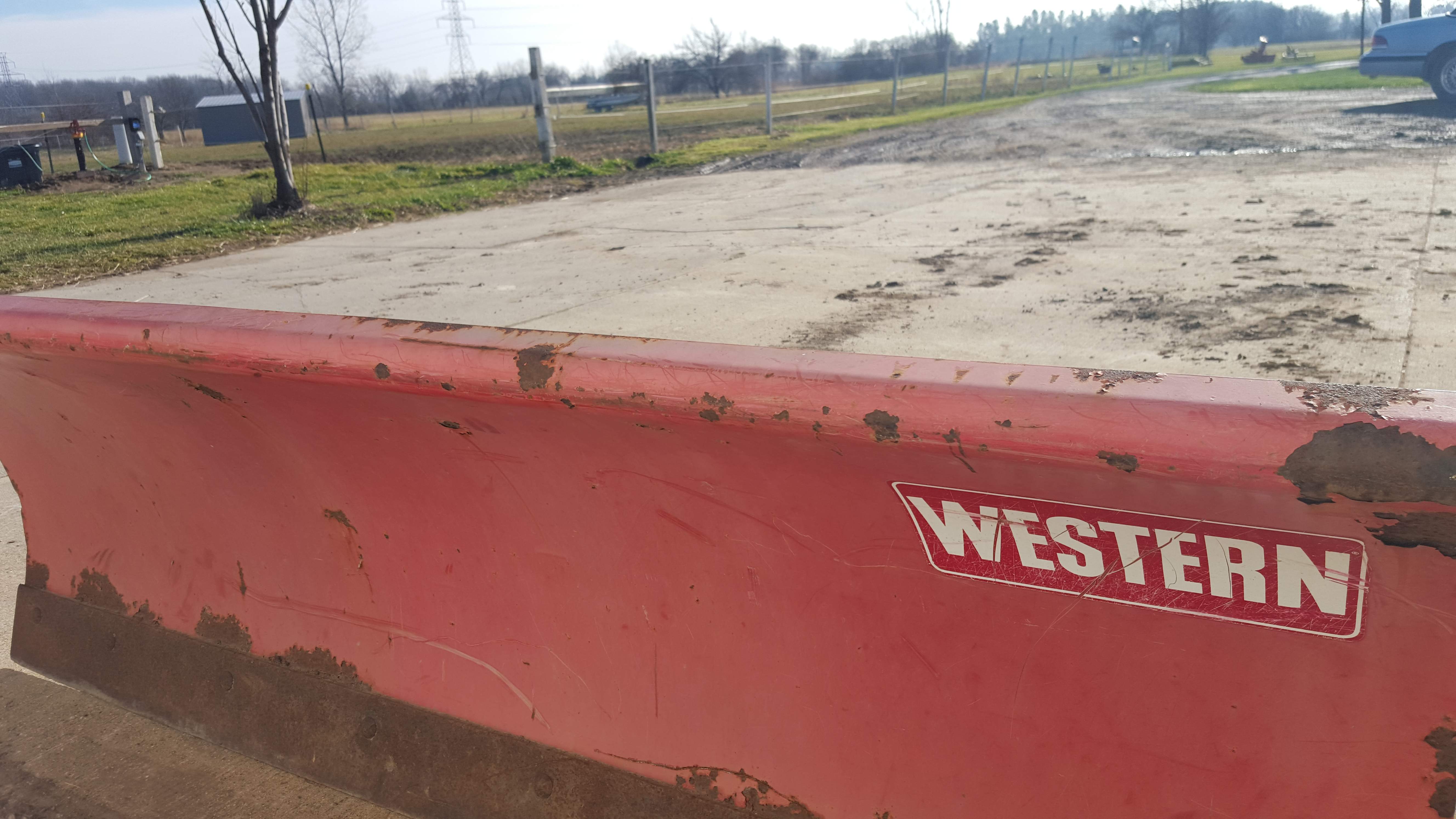

Now I'm looking at nice fresh black paint on the mount, and the blade looks pretty sad. It's an old Western and is faded peeling powder coat.
Will it work to sand the rusted spots and peeling powder coat but leave the powder coat where it is adhered, then prime and paint?

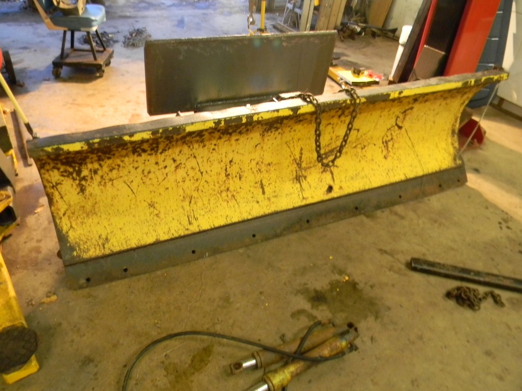

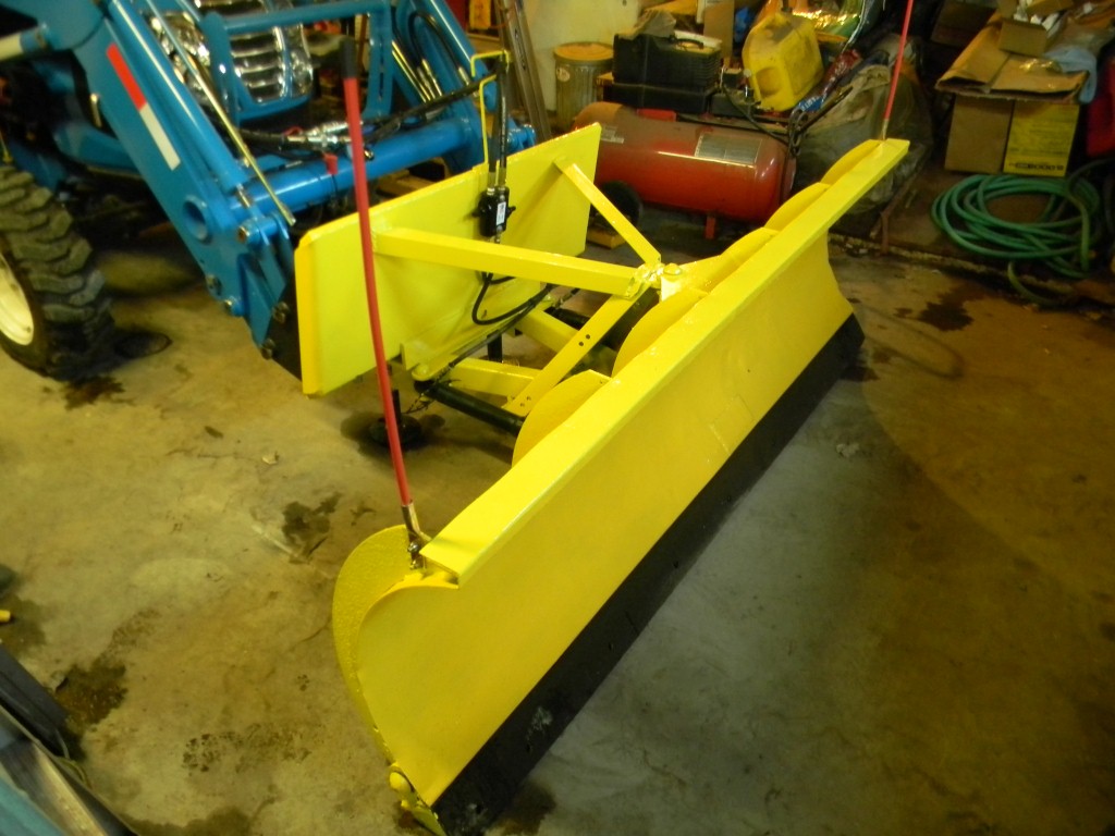

When I converted my Diamond truck plow to SSQA it was pretty rusty and had a hole. I welded a steel patch over the hole then took an angle grinder and wire brush to the rest of the rust and loose paint. Got off as much as I could. I scuffed the rest of the painted area with a scotch bright pad and some mineral spirits then used Rustoleum primer for rusty metal then top coated with Rustoleum industrial yellow. (Red is also available).
My SSQA plate was new as were the bracing. I used the same paint on them.
I've had good luck with this paint on previous plow blades. I brushed the paint on rather than spray.

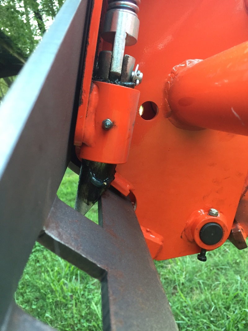

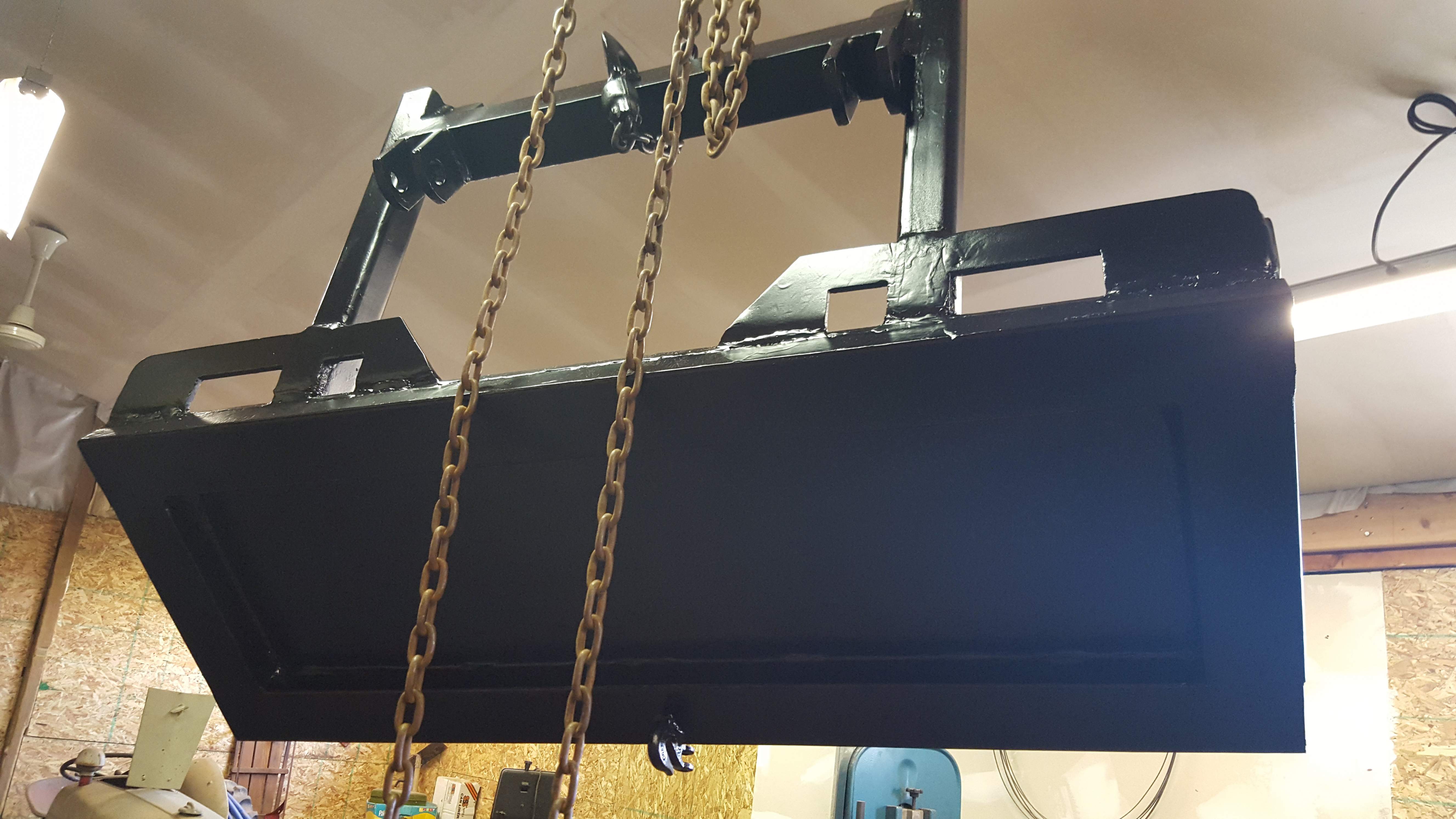

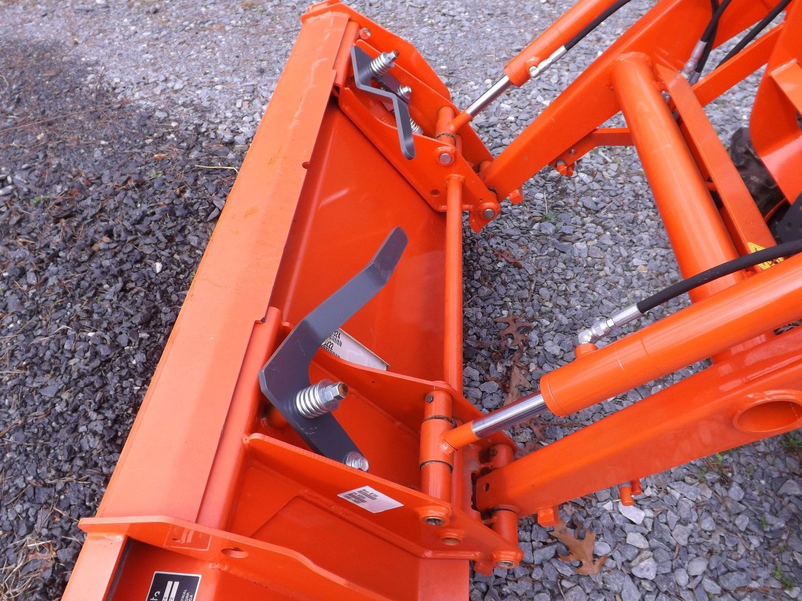

GP I don't know whether you noticed or not but I think you did the mount for the plow on the wrong side of the SSQA plate as I am guessing your son in law is wanting to use the plow on his loader to plow snow if so you have the plow mount on the side that goes on the loader SSQA as it looks in the pics the plow mount is blocking where the pins go in the plate for the SSQA.

We'll I've done worse I guess but I think it's right.
The back of the plow A frame will mount rear of the SSQA plate, so the plow will be closer to the tractor.
I'll post up pics of it mounted soon. Maybe tomorrow. Gosh I hope I got it right.
Ditto, your braces are going to interfere with the QA plate., you are going to have to cut them off and move them unless there are reliefs in the tractors mounting hardware?
   / Converted a Western Snowplow to SSQA.
Maybe. I mounted the 2 inch square tubes along a 2 inch steel section of the plate where the qa rods poke through the slot. The slot had 2 open sections, 1 large and one small, rather than one continuous opening. I test mounted after tack welding before going full bore.

You guys have me worrying now. It's pretty heavy and I was going to wait til sil got home to carry it out of the shop. Maybe I'll do it now.
I'm not that familiar with ssqa. Do the openings for the rod usually have only one opening? Are the arm widths and pin spacing different one various machines? Hence maybe the wide slot?
   / Converted a Western Snowplow to SSQA. #10
Did you test fit on the LS tractor?
It might work on a tractor QA.
It sure won't work on my SSQA.
