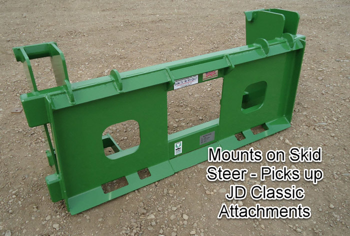

Good morning, I am looking at buying a used 5 series tractor and I am seeing all three kinds of quick attach on the loaders. JDQA, SSQA and global. I am NOT asking about the benefits of one over the other. I am looking for information on removing a SSQA and installing a JDQA.
Any reason to not use an adapter? That way you could use both styles.
   / Conversion of loader from SSQA to JDQA #6
Cost I can't help you with but to switch it out is just knocking out the 4 pins holding the SSQA adapter to the FEL, replace it with the JD adapter, and put the 4 pins back in place.
   / Conversion of loader from SSQA to JDQA #7
Once you get the correct holders and timing bar for the model FEL you have, it is as simple as removing the 4 pins. Which FEL is on the tractor?

Most 5 series loaders come from the factory with the JDQA brackets. They are removed to install SSQA brackets. They are attached with a couple of pins. There are probably some stock JDQA brackets laying around that could be bought cheap at dealers or on farms. Depending on how old of model the loader is, hopefully they are still available for purchase new.

Or he could find someone that wants to swap carriers.
