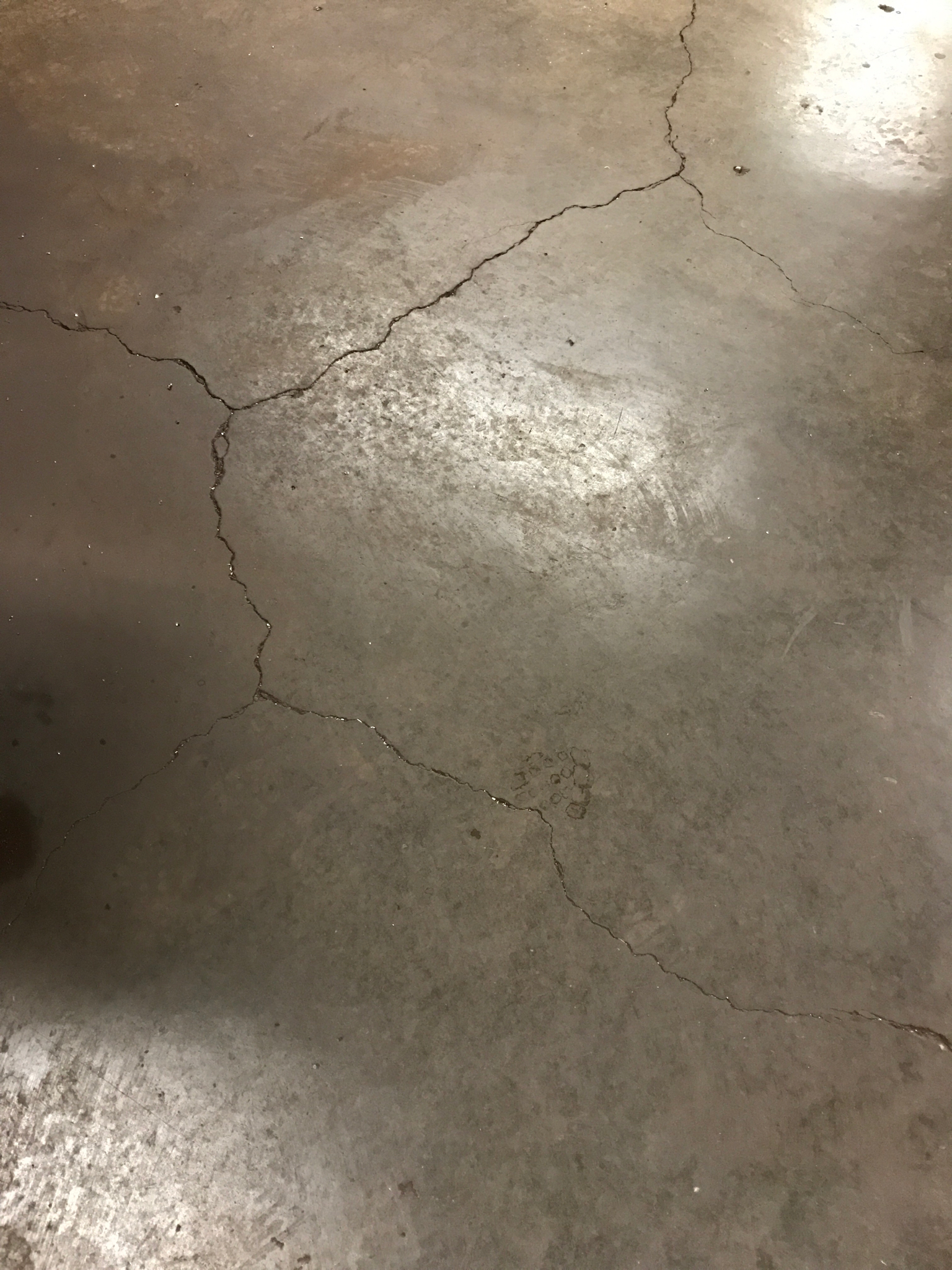

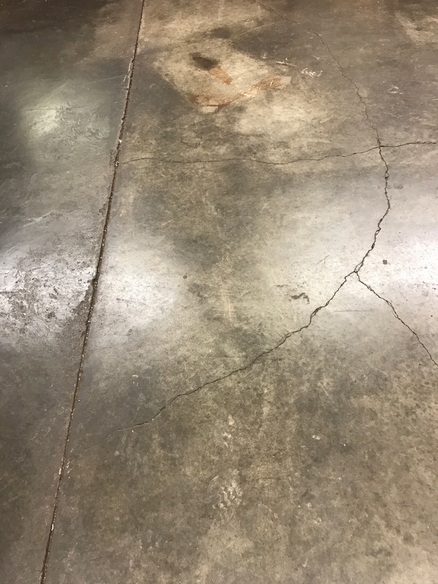

Tomorrow is too late for cutting expansion joints. The concrete will have already begun to crack but it will be months before you see it. Tomorrow's cut lines will help some, but 2 down the middle will mostly be for aesthetics. They should have been cut early this morning. I would have cut your floor into approximately 12' squares.
Exactly , needs to be softcut as soon as you can walk on it .
