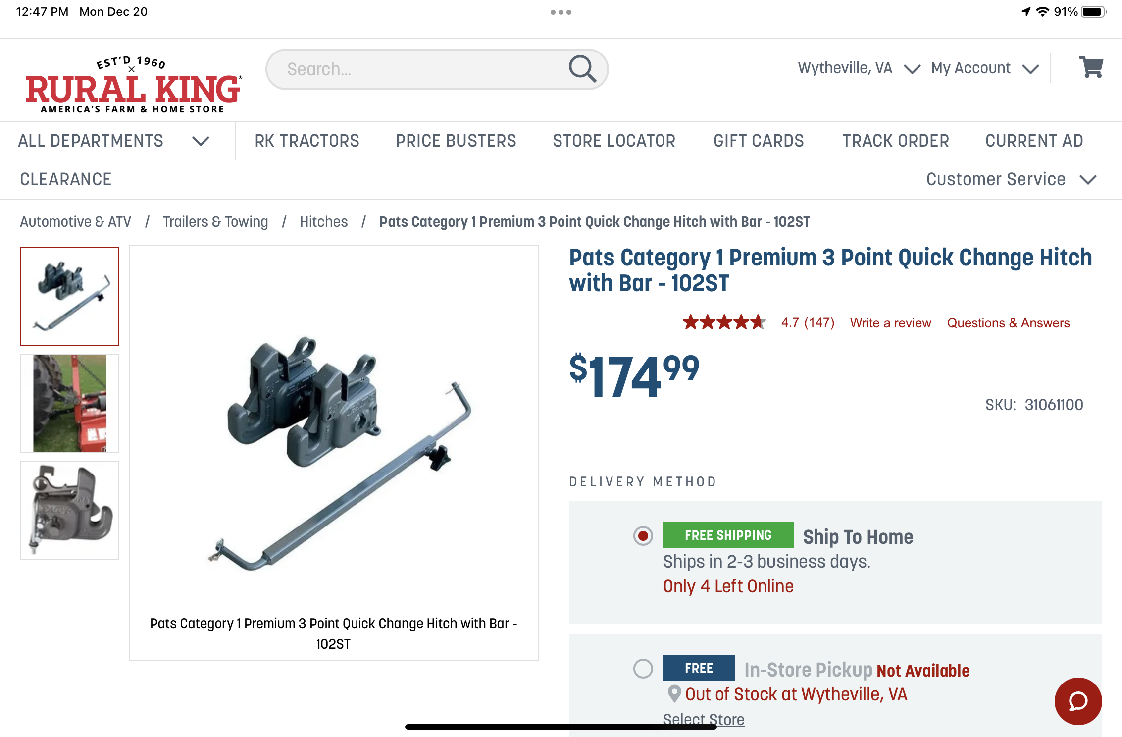

Try out one of these for raising gravel back to the top on a gravel driveway. It will save you from buying a lot of extra gravel.

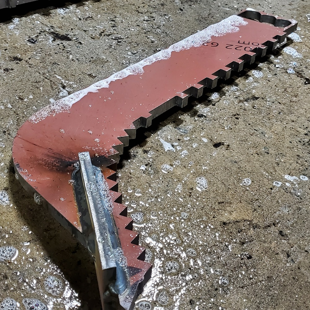

Yes, Everything Attachments is behind, mainly due to a sketchy supply chain and constant demand, but hopefully the new facility we're working on will help to remedy the wait.
As far as box blades are concerned, we've upped the bar, big time, with our new WICKED easy adjust ripper shanks, which are 100% Hardox 450. It eliminates the need of those pesky, welded on tips, which are known to pop off.
EA Box Blade Full Lineup
We can talk about it, but it's more fun to prove strength..

There could be much improvement in ripper design. I’ve lost points or broken shanks before I could wear them down. Improving the adjustment helpful. Impressive video demonstration the strength of design and materials. Us mountain folk are better at breaking stuff if you want it proof tested ;-)

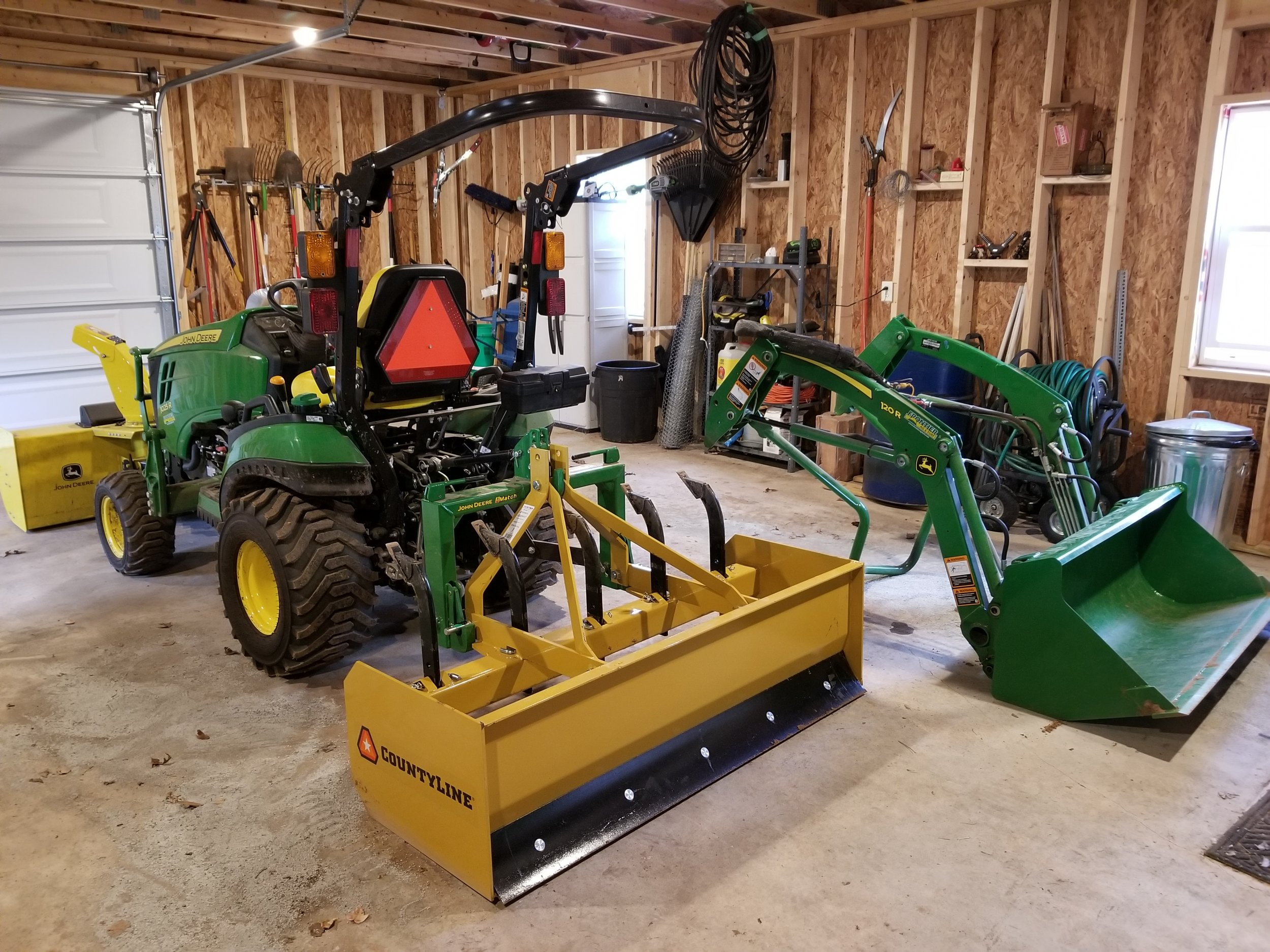

I was really impressed by how abusive that video was. It was a good sales video in the sense that if *THAT* didn't break it, *I* sure wouldn't break it!
I posted earlier about how a hydraulic top link lets you use the rippers or not use the rippers without having to get off and adjust them. I don't have a whole lot of need for hydraulically moving rippers, BUT.. if you have rippers that power up and down you can also have them swing through an arc that can dislodge any muddy/clumpy stuff that is stuck in the box. Ive seen at least one like that before.
Here's a picture of a tiny tractor pulling an 'oversize' 60" box blade full of dirt, and the electric-over-hydraulic top link. I've found the limit of what I can pull with the box blade is when i drive right over a big pile of dirt and drop the box blade and its trying to push forward the same big pile that my rear wheels are trying to push backwards.. THAT's the limit :ROFLMAO: So I can pull a pile of dirt that sticks out of the front of the box (box already full), but if i jam every inch between the rear tires and the box with dirt, i can't pull that.. Also my poor 3pt can't actually lift the blade under this condition. I have to reverse a bit while lifting to be able to empty some out and be able to lift the blade again. I think the 3pt on this thing only lifts like 500lbs. Still, i find this totally workable. The picture is only showing about half that pile of dirt in the background and it all got put there with 2 tiny Kubota tractors with 48" buckets. Bigger machines would be faster, but this thing is almost like a skid steer in terms of where you can place it and maneuver it.
The power top link actually helped maneuverability for me last couple of days because i've been digging around a 24" culvert to build some retaining walls and i was driving the tractors down in the creek bed a little during the process. The tractor that has a backhoe on it was sort of difficult to maneuver, not because it was too long but because I couldn't turn it very tightly without jamming the backhoe into the banks on the side and unloading the rear tires, causing tire spin. I also didn't have room to stick the dipper way up off the ground and drive it like that either. It's 4wd with rear diff lock so i never got stuck, but it was a little annoying. The tractor with the box blade i could tilt the back of the blade up so high I could back right up to the bank and not be hitting and unloading the rear tires. That angle is shown in next pic.
