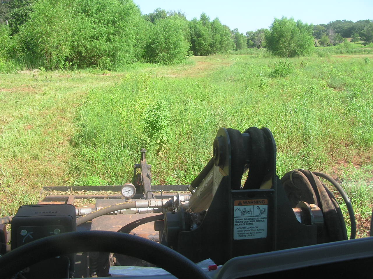

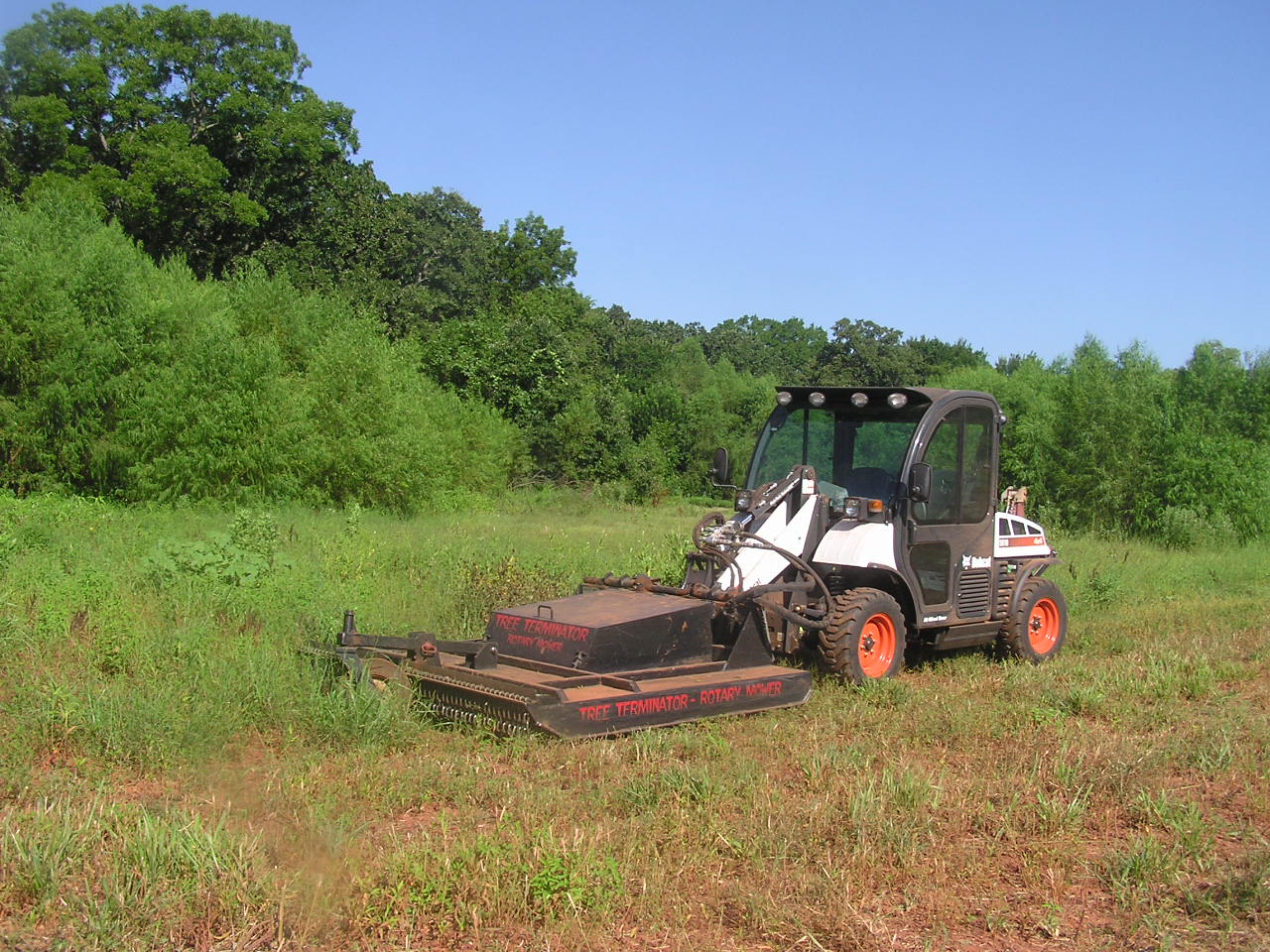

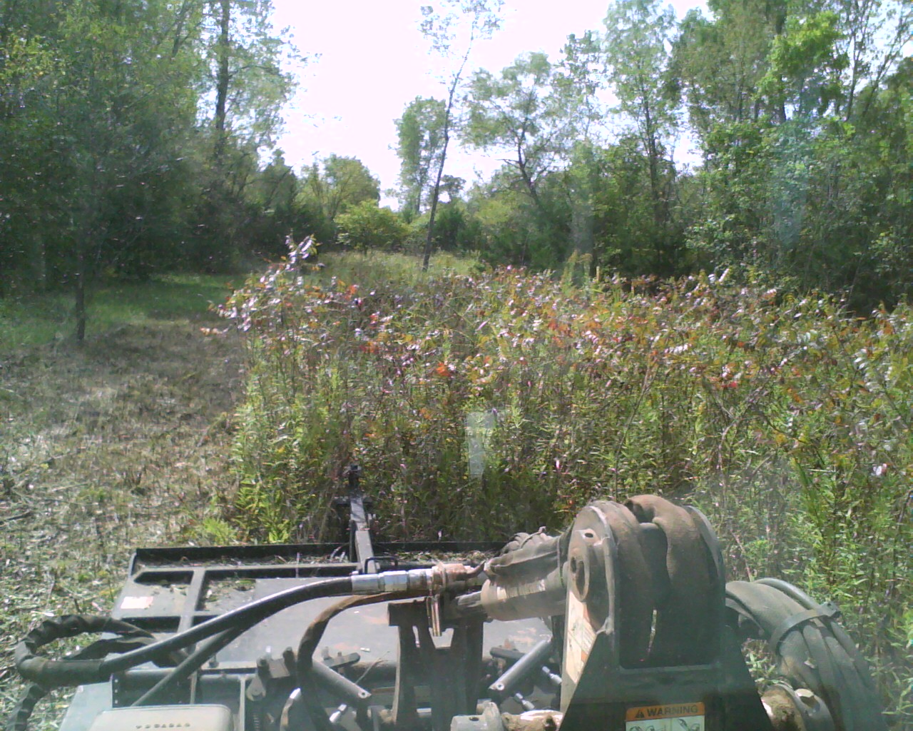

The only thing I have used on the PTO is the neighbor's post hole digger with a 9" auger. And it did fine in the red clay here.
The Toolcat will easily lift more than the 1500 pound rating on the loader. It gets used mostly with the 7', 1800 pound brush hog:
   / contemplating a 5610
That's one mean lookin mower!!
   / contemplating a 5610 #8
Yep, and the blades are sharpened on both edges. I use normal rotation for the pasture and reverse rotation for brush. :thumbsup:
