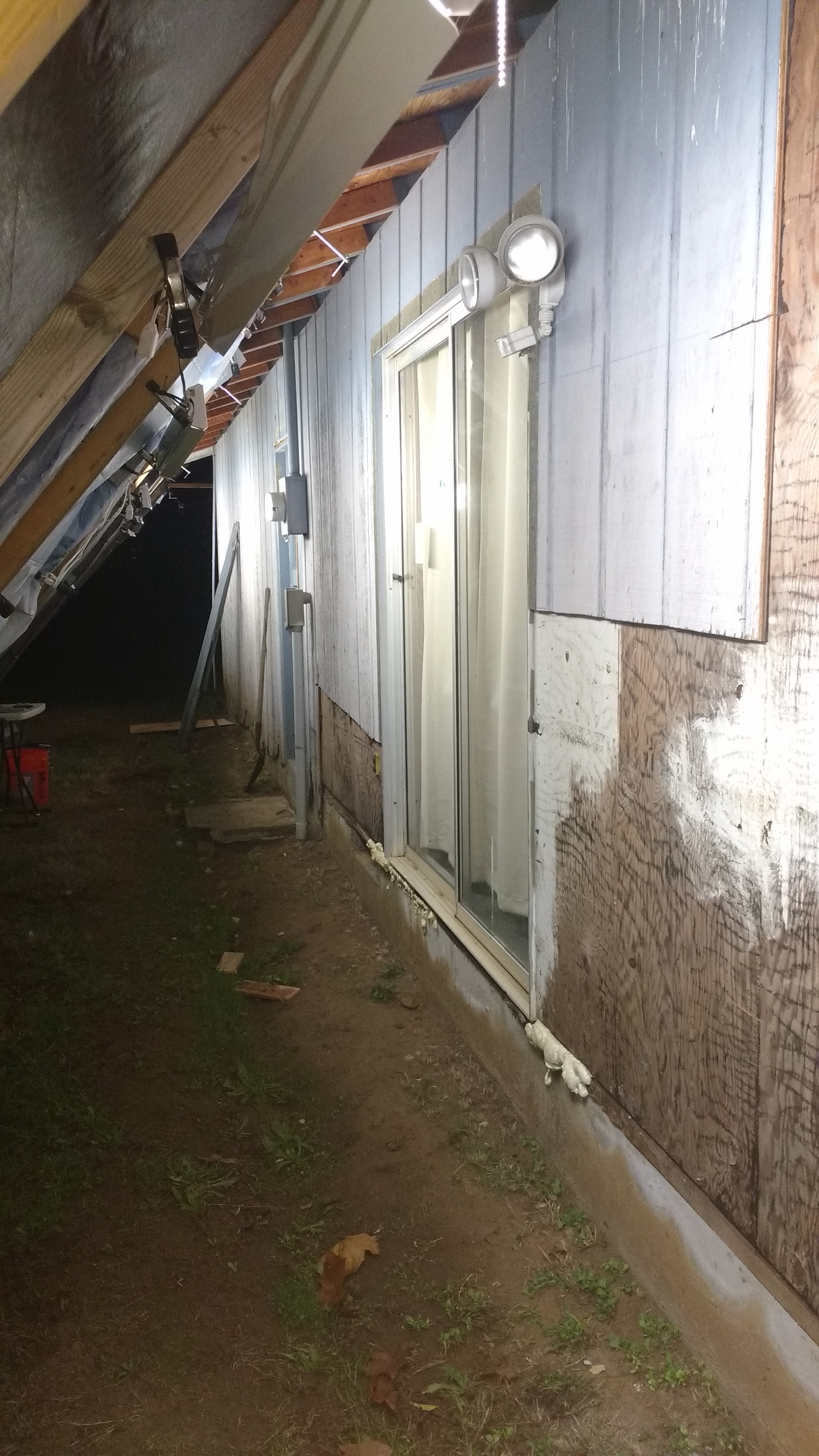

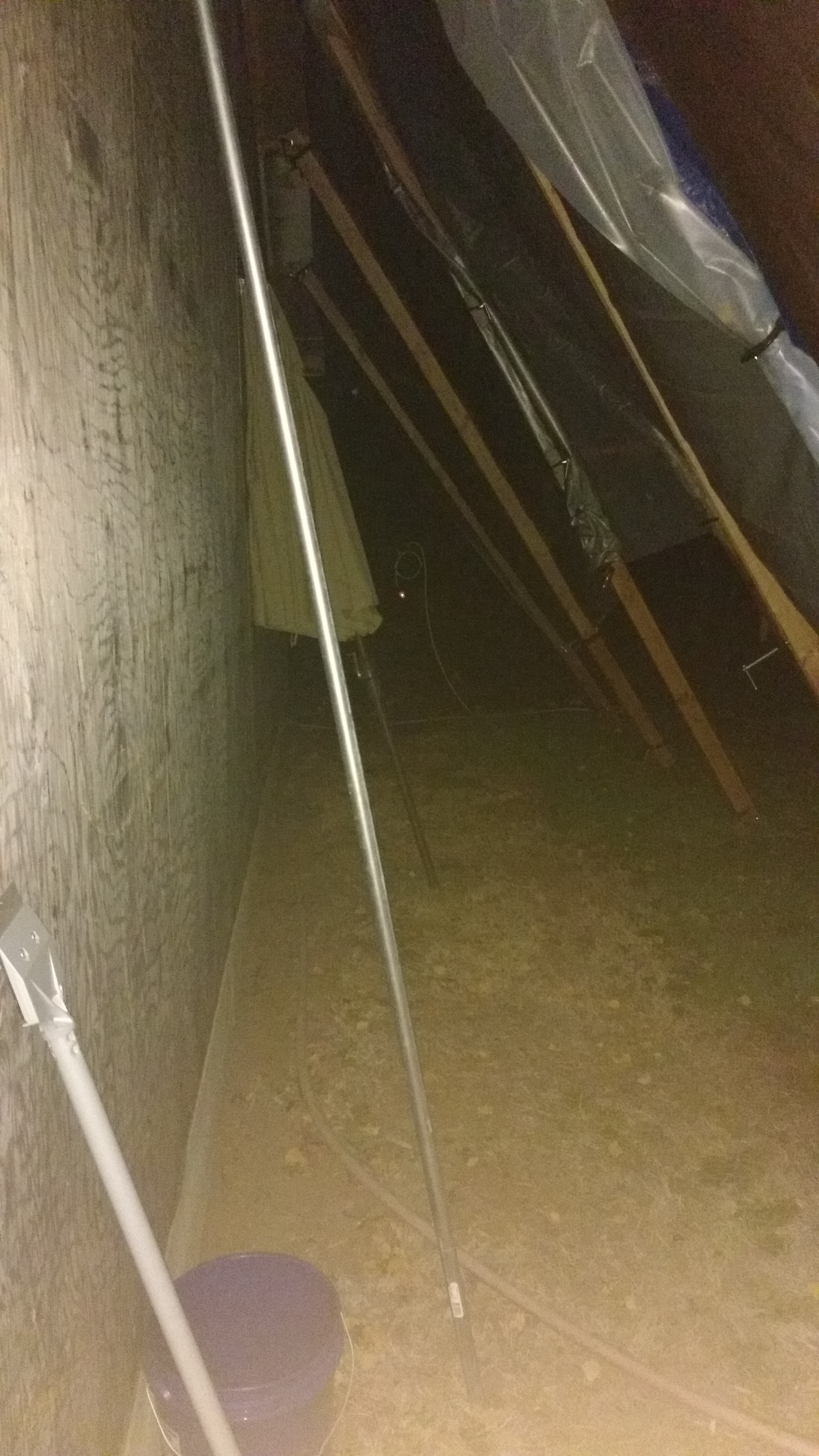

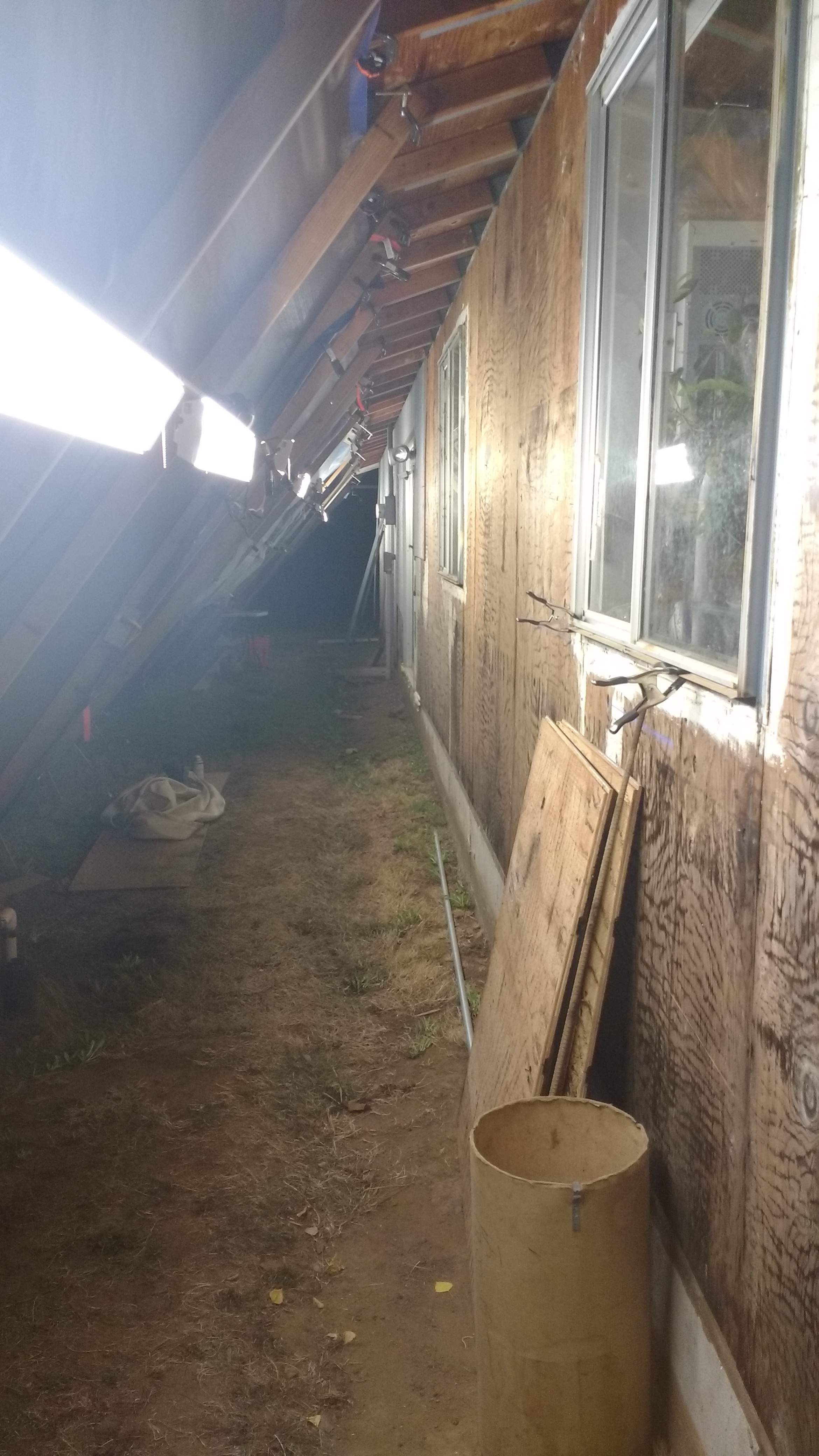

OK, since I've been a bit lazy I thought a few night shots might be a good plan; (Besides, it quit raining just before bed :D)

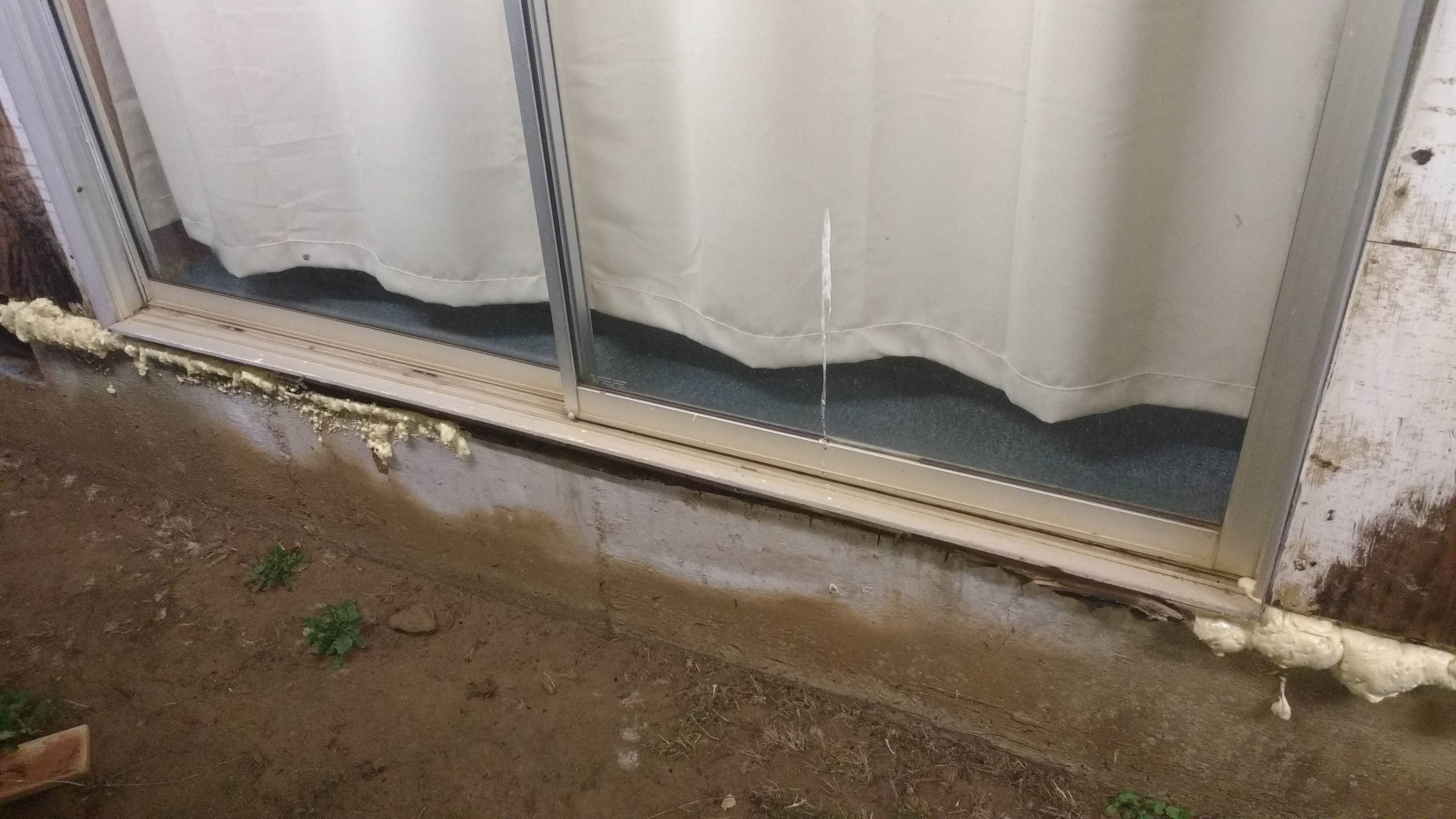

South sliding door; foam is plugging up the completely GONE sill plate and some of subfloor - this is the "wait for spring" part, will likely require replacement of about 10' of sill plus up to 4 ft of subfloor and a few studs. Will get a new sliding door at that time. Will also require shoring up with double 2x12x12' temp header OUTBOARD - HousTentNite-4.jpg
Six of Costco's LED shop lamps aimed horizontally give me PLENTY of light for night work; now all I need is the ENERGY to take advantage of it :rolleyes:

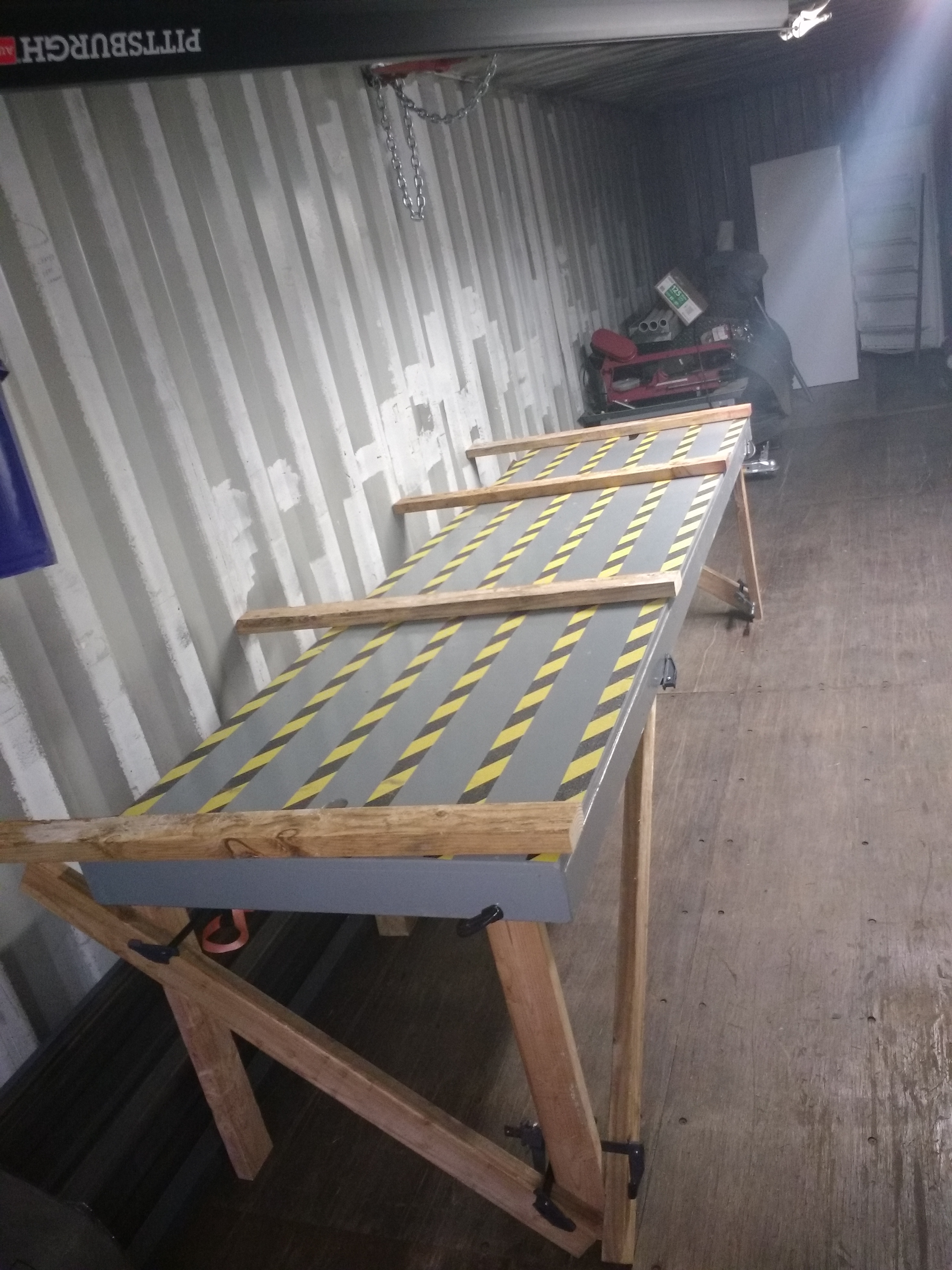

On another note, Frank (the plank) got some temporary legs the other day, not shown are the two 4'x12' 16 ga. sheets leaning against the right-hand wall of the container, that're now sitting on TOP of "Frank" with a butcher paper pattern, to be cut out with the cheap HF skil saw and a metal cutting blade - those will get painted, edge punched and will close off the upper "wedge" areas of the roof (where the HF crane got modded a while back) - later, the lower parts of that area will get their tarps replaced with square tube-framed doors -
