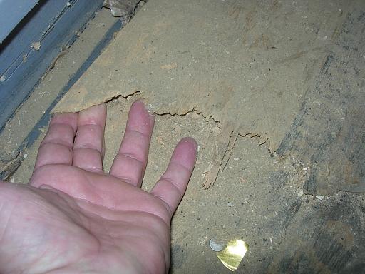

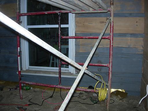

Picture "F1" shows a window and scaffolding with a red circle. This window is going to be knocked out and widened to become a doorway into this kitchen extension. This means, it will be a high traffic area.

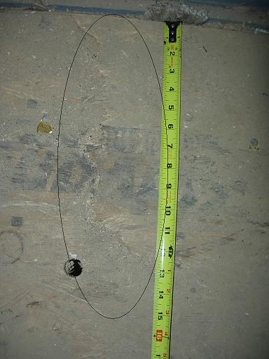

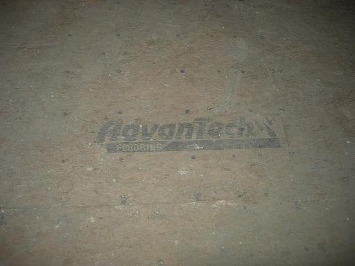

Note the red circle...though maybe not exact, it's close enough. There is a crack in the floor here. Seems it's made of some kind of chipboard (Advantech?).
1st: Is that an ok subfloor substrate? We used normal 3/4" plywood throughout the rest of the house so this is something I've not seen.
2nd: The flooring on top of this will be 3/4" x 6" T&G pine
3rd: There is a crack in this and since this is going to be a heavy traffic area, this concerns me a bit. (see F3).
Since this will have 3/4" pine on top of it, should I:
a) not worry about it
b) replace this sheet since this is a high traffic area and it's not worth any risk for giving way or perhaps floor squeeks because of this crack?
As I've since found out, my builder is new. I'm his FIRST remodel... he has built some new construction but as for an addition...I'm his guinnea pig. Also, the contractor himself is not doing ANY of this work, he's hired it out to a guy who's pretty good with wood so I don't have any issue with HIM.
The sad thing is, regardless of any conversation I might have with the wood guy, the contract is with the contractor so I'd have to go through him and frankly, I've come to be guarded with what he tells me on some things to the point that I'm not inclined to take anything he has at face value without further research.
This (floor) might not be an issue, so I'm doing my research prior to bringing it up with him.
Any thoughts on if I should replace it? BEFORE the final flooring goes down?

Kinda hard to tell from the pics bit it looks like osb, which is commonly used as sub-flooring as it is a lot cheaper than ply-wood. Typical is 23/32 which is basically 3/4". I would replace the damaged peice just for peice of mind. 23/32 osb is usually around $10 per sheet in my area...about 1/3 the cost of plywood

I also feel that the damaged section should be replaced, that way you do have piece of mind ! Then your contractor will be installing 3/4" pine over all of that, that makes a pretty strong floor long as you dont have any elephants in the house ! :) As long as your floor joists are solid, which can be checked when the bad section is replaced, you should be good to go IMO ! ;)

Well like my Dad tought me, you can do it right the first time, or you can do it again later... I find that my first instinct is usually the correct one, and if you are even asking these questions, you already don't think it is right. Trust me, you are really gonna kick youself later if that area of the finished floor develops issues.

Easy to fix and cheap to fix now. Impossible to fix without tearing out your finished floor later.
Pop that sucker out and put in a new sheet.
/ Construction question...(subflooring) #7
Locate the joists, generally at 16" center.
Drop the saw blade 3/4" and cut out the damaged area over the joists.
Since in the other direction there are no joists to attach to, slip a 3-5" glue strip of ply under and screw from the top.
Make a suitable patch and screw it in place using construction glue in a tube at all contact points.
Just as good as a new sheet!

I was also wondering should the entire 4x8 be pulled out or maybe cut a (for example) 3x3 that will be a subsection of the large sheet but still large enough to cover this break and fit onto some floor joists.
Interestingly, this might open up an opportunity for me. Unseen in the picture and not commented on... on the other side of that windoe is a floor register. The register would have been right in the walkway since the window will be removed and enlarged to be a doorway.
If we cut a section out, instead of the entire 4x8 sheet, I could make the section... how to describe this... I could make the section the 3x3 or what ever it needs to be as well as leave a tongue on one edge of it that is 6"x15" long (making that up) and this tongue would slip into the spot where my OLD register was and be part of the initial floor support for the hole that is going to be filled in there (we've moved the register)

cut out the cracked section and replace as described by others in this thread. i have done this many times when building hotels and such right before gypcrete is instaled. as long as you glue and screw the edges down to exisiting floor joists, you will be all set. glue important to eliminate squeaks

I'm a contractor and I make my living doing remodels and repairs to homes. If I see something that I find suspect in a home, I bring it to the clients attention and explain it to them. If the client mentions something to me that they are concerned about, I address it right away. If they want something done a certain way, or fixed, then that's exactly what I'm going to do. Usually it's something small, like your floor, and I don't add anything to the bill. If it might be fairly involved, I tell them so and give them a price. Your contractor is working for you, he's being paid to do what you want him to do. Tell him what to do and if he doesn't want to do it, fire him and get somebody else.
When doing the repair, insist that they use glue and screws. Be sure they cut out as big an areas as possible. Ideally, you want a full sheet of plywood in the repair so that it covers several floor joists. The big no-no here is to have it span from two floor joists. That will sag and make noise for all eternity. Span as many joist as you can!!!!
Be sure of your width. A small difference in thickness will show with years of use. Insist that it is perfectly flat and that the seams are filled. There will always be gaps, it's the nature of cutting out the old stuff that it will never be truly straight or true. I use a straight edge for my lines, set the blade for 3/4 of an inch at try real hard to get a straight line. It's never happened, but I try. After the new wood is installed, I fill the gaps with Bondo. I like Bondo better then the other wood fillers. It's proven to be indestructable and impervious to bugs and weather. It sands quick and easy too!!!
