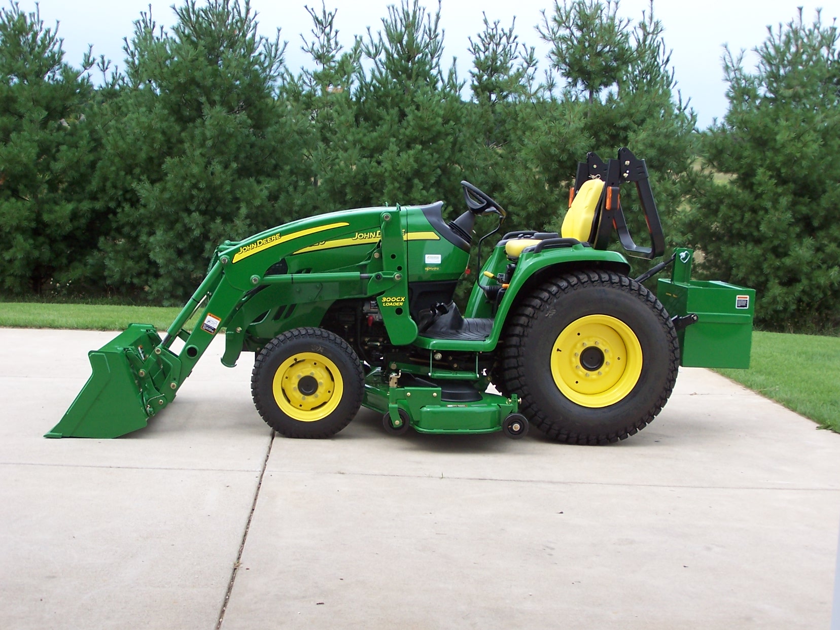

hpc said:
Galaxies won't fit the 3520 equipped with the 72" deck.
I gaurantee you they do. See photo of my tractor.
   / considering trading-in 3520 for 748 #16
Those are sho' nuff R3 "turrfies"!
Looks like the MMM could have worn off the little rubber thingeys' when the tires were brand new --- not a great deal of clearance...
Good lookin' machine. And -- just guessin' -- the pic wasn't taken last weekend...
AKfish

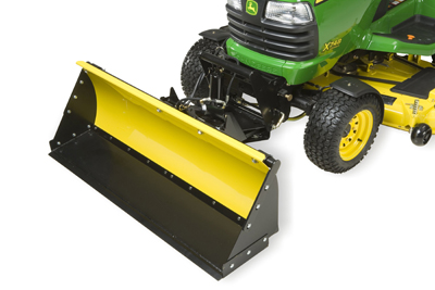

HPC,
Lets clarify some things. The 7 iron drive ( deep 60" ) driver over deck is available on the X748, awesome deck. I would add a blower for those few times that requires. In addition, order the add on lift bucket that mounts to your blower hitch and front blade, it will act as a loader, the only downside is not much lift height. But you can carry mulch, dirt etc. and pick up just like a loader bucket. ( being 3 acres I do not see this as a requirement)
Turbo recommended the AWS, do not if severe slope, you do not want this with an abrupt spin on sidehill, dangerous. This tractor would handle the slope, the wetlands and give an impressionable cut.
THE WIZARD
