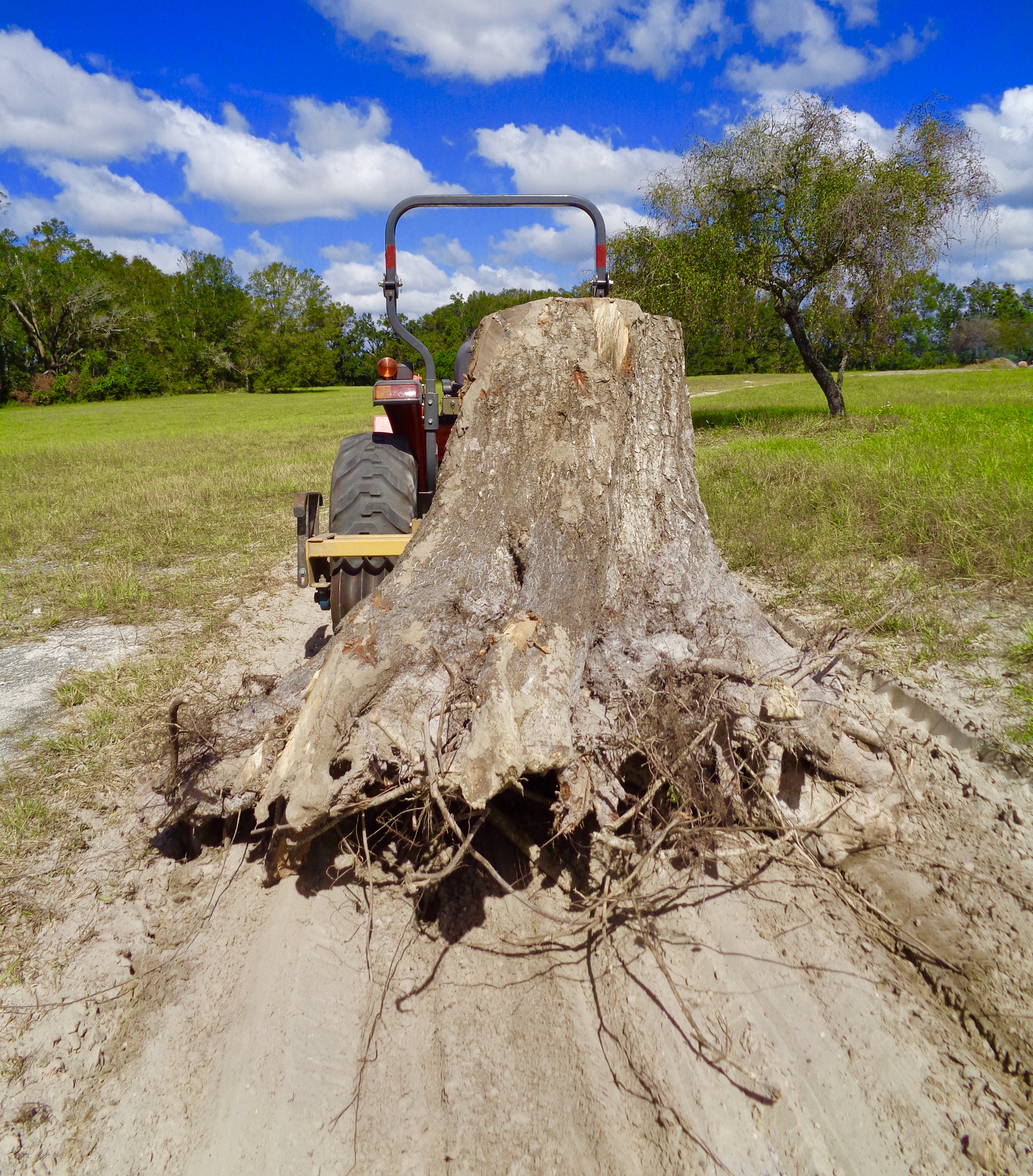

I pulled a hurricane downed 40" Oak section about 12' long the other day. I got it out of the woods and moving over the hard road fine. I stalled out when I reach a short 5 degree dirt slope at the burn pile. I halved trunk there with my Stihl MS461. I did not have my camera, unfortunately, as it was my max timber pull to date. My tractor is heavier than what you are considering and has 37-horsepower. Power to weight ratio probably similar.

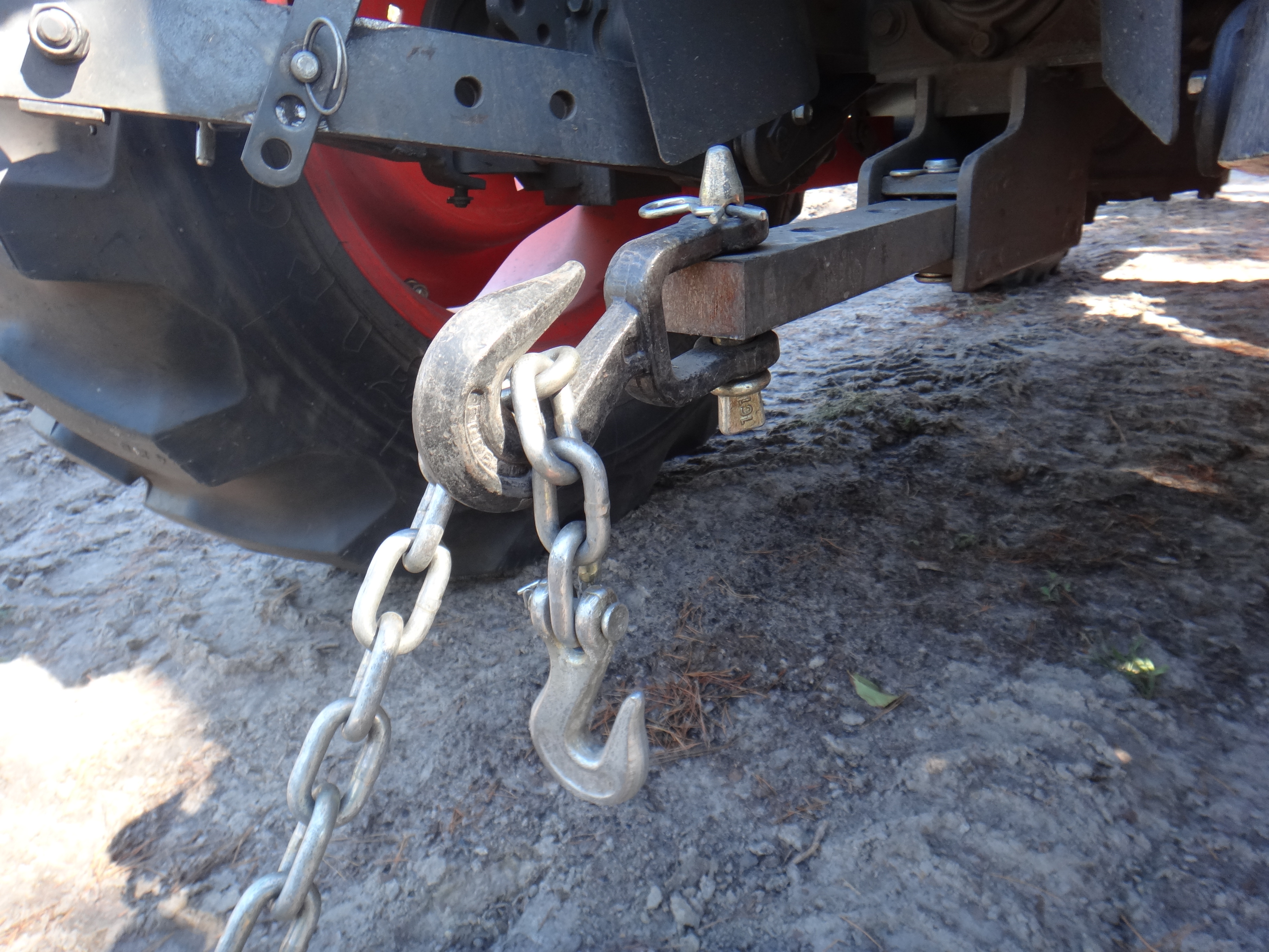

Tractor rear/center drawbar is directly attached to tractor. Rear/center drawbar withstand heavier loads than a cross-drawbar, but is fixed. Photo #1 - #3, Post 7, Photo #6
http://www.tractorbynet.com/forums/...ar-center-tractor-drawbar-use.html?highlight=
Few would use a boom to pull timber. You have to pull heavy loads low, or the tractor will roll. Nothing with weight center above rear axle. Also, bouncing over rough ground can produce huge transient loads which could bend or break a boom. With a boom, your load elongates due to boom length when load is low. When operating any tractor close to max, hazard quotient escalates.

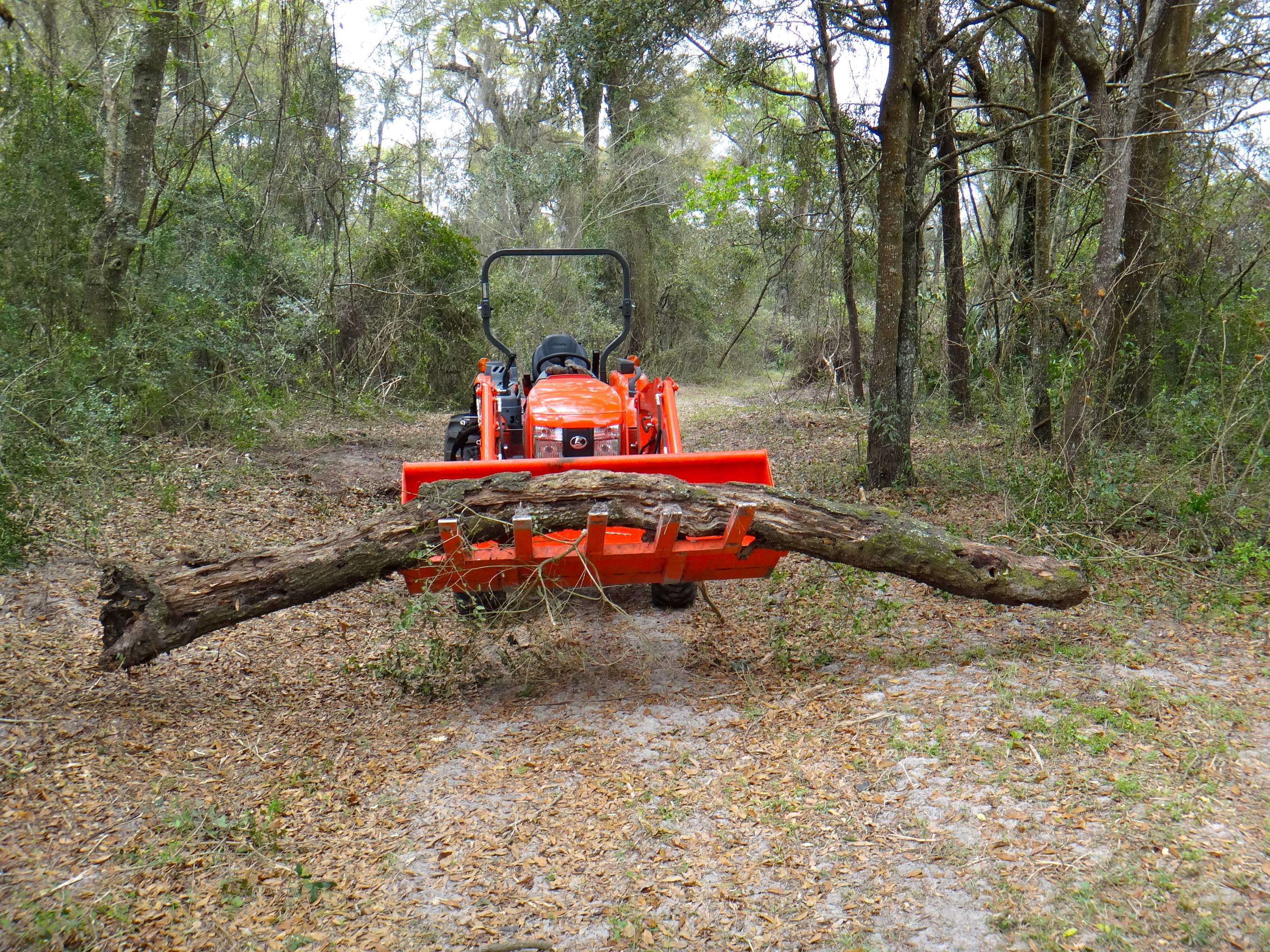

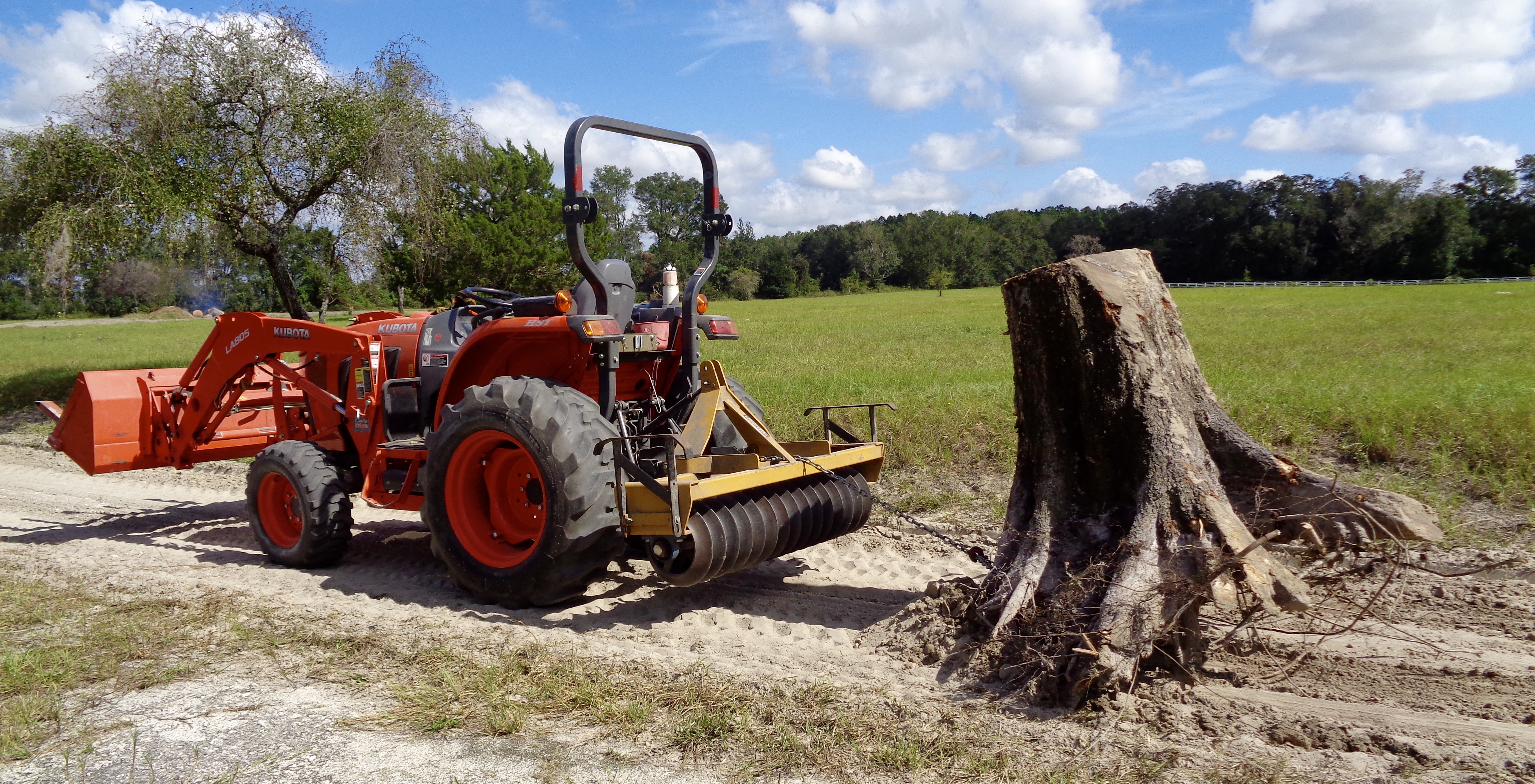

With a heavier tractor with more FEL capacity you can move timber in front, keeping it dirt free for the sawmill. In Photos #4 - #5 I had a 630 pound Rollover Box Blade as Three Point Hitch ballast, even so the rear wheels were dancing light. Approximate FEL lift 1,700 pounds.
