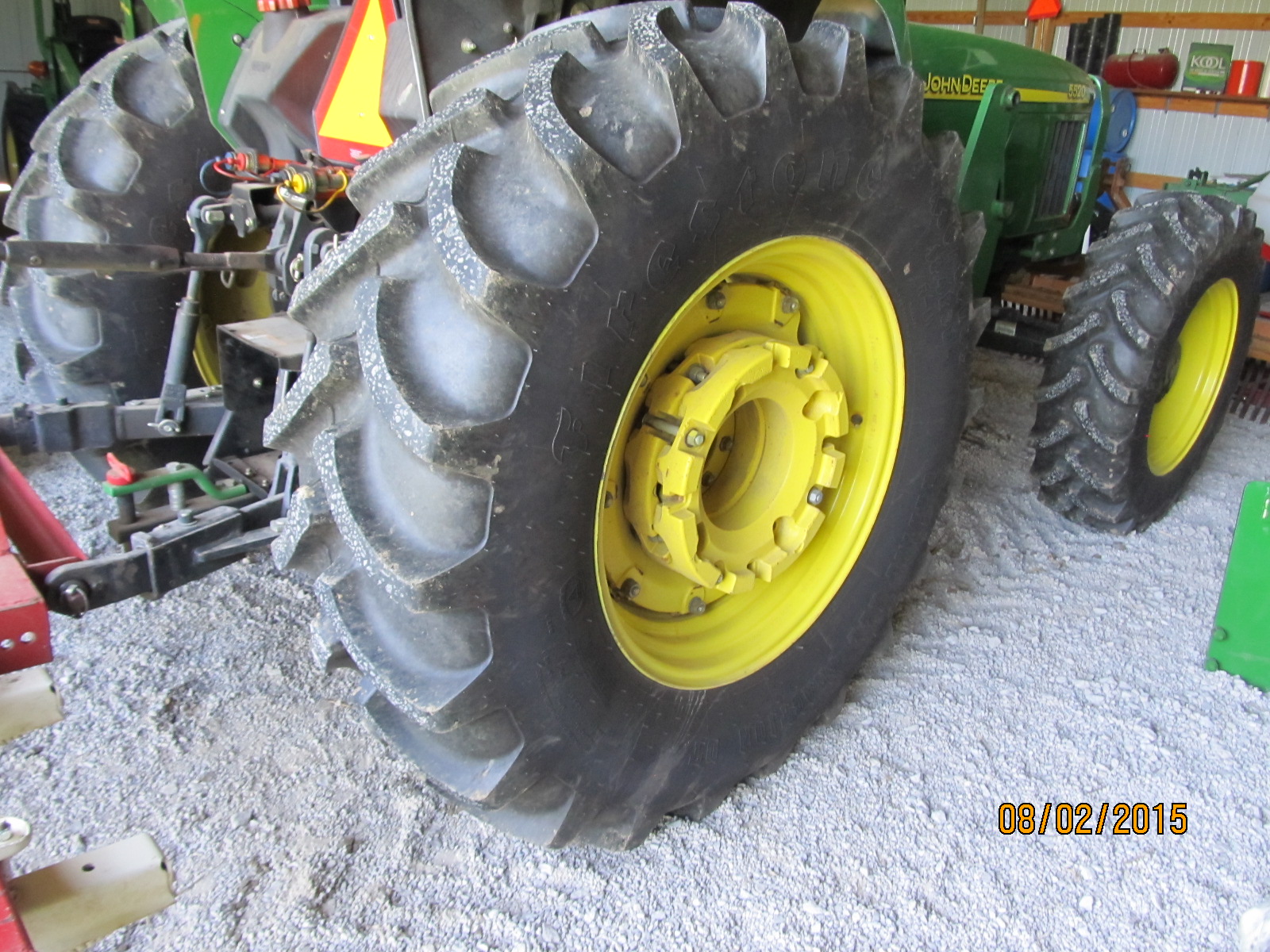

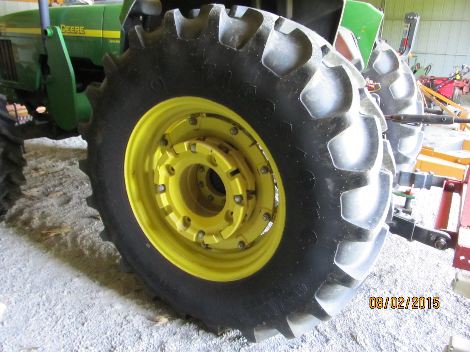

These first pics are off my JD5520. I have two rear weights on each side and they are a great counter to the loader when I pick things up. On the front I have the starter weight block. I think it's 285 lbs. I think the back ones total 500 lbs. For the front I used to add up to 800 lbs of suitcase weights for tillage things or heavy lugging but since I got away from that they haven't been on since. Those are radial tires and that adds a few hundred extra lbs.

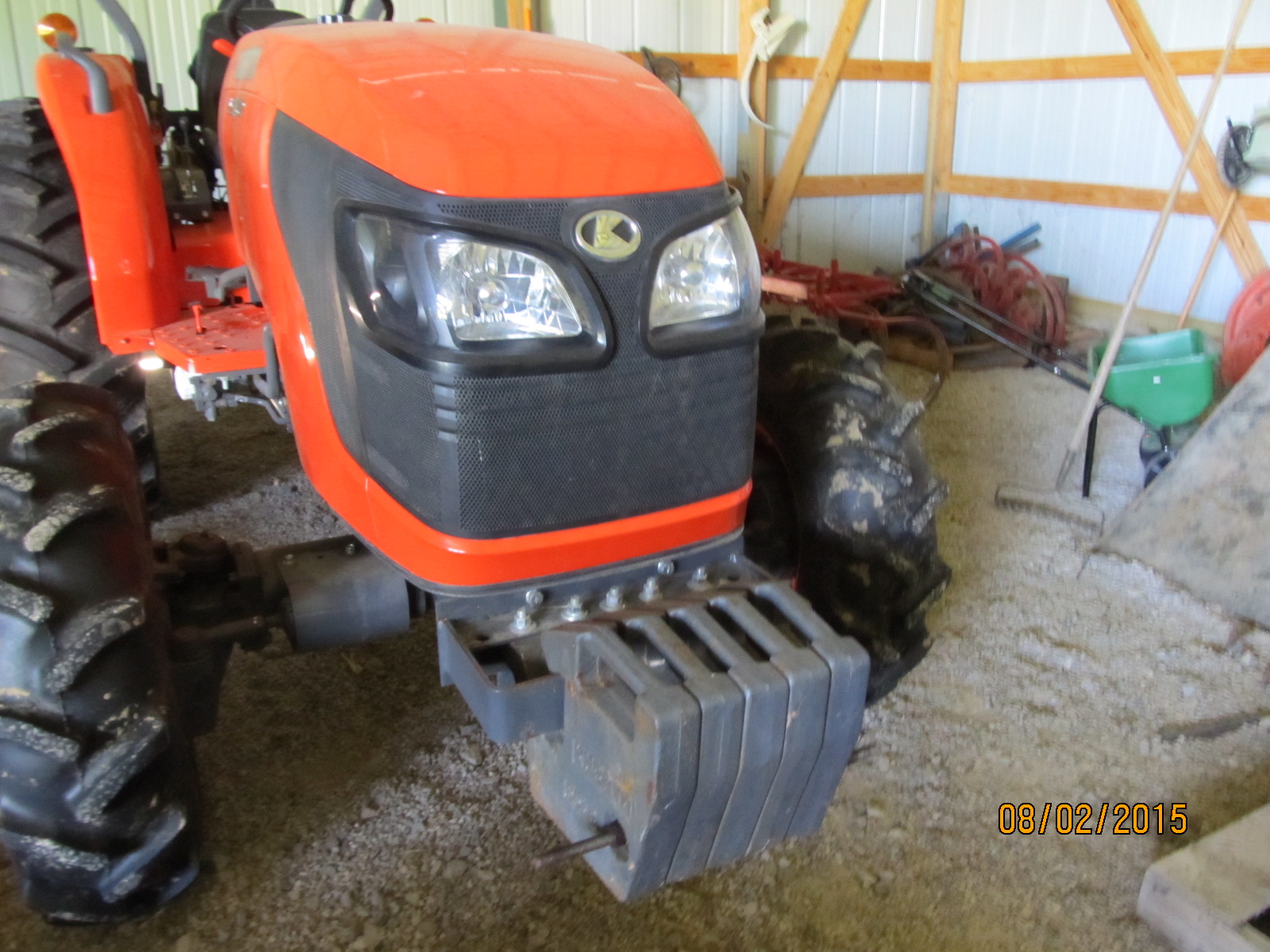

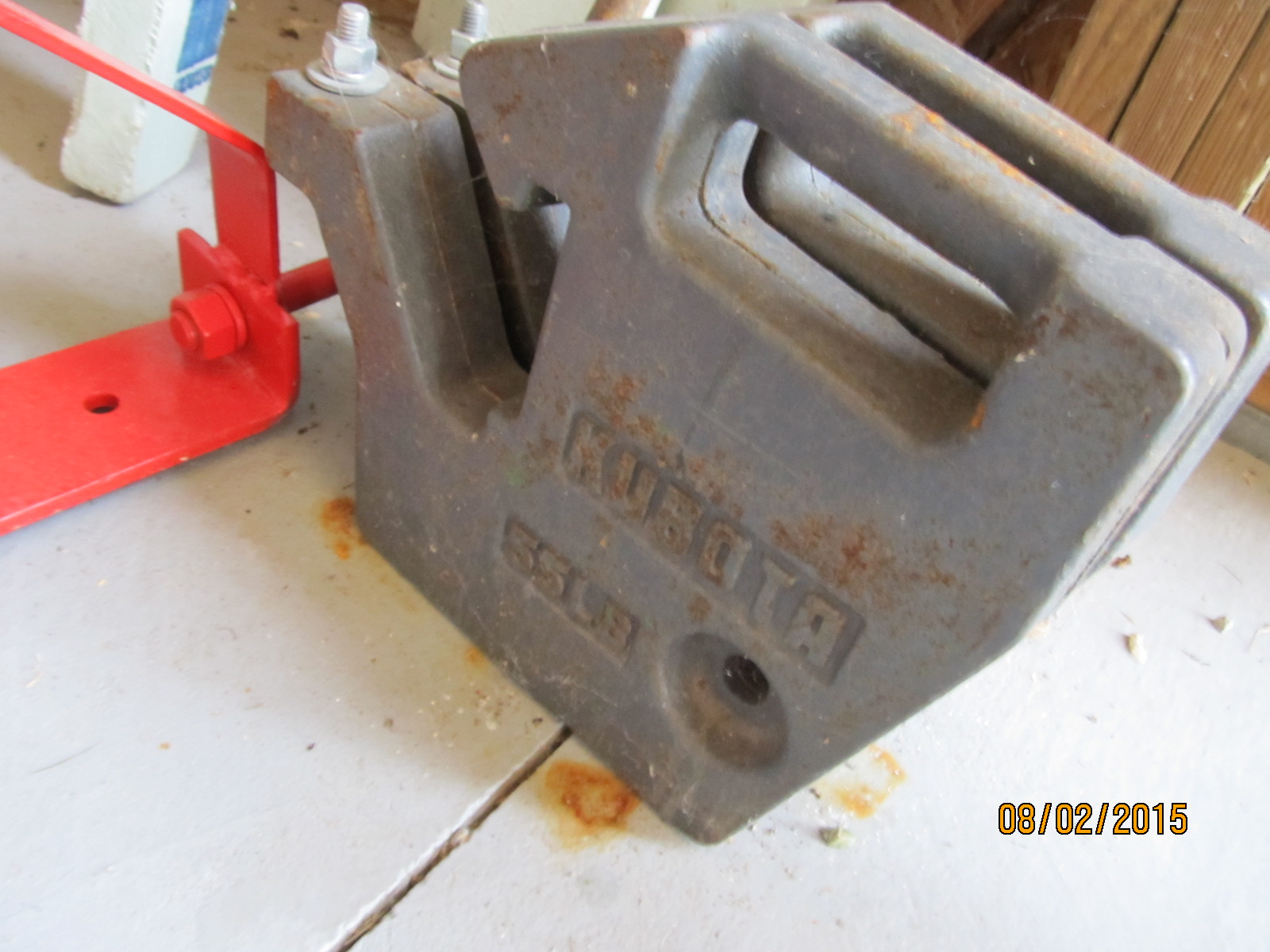

These next two are of my Kubota L4300. It's FWA but is light in the front end and I often pick up 1000 lbs. Without the weights, it's bouncy. Sometimes I bolt some or all on securely and sometimes I just run a threaded rod through and put nuts on. If I'm around the house I will do that and in decades have never lost a weight that was just hanging there. Oh, this is a homemade front weight bracket and NH skid steer weight knock offs. I had the weights so made it work.

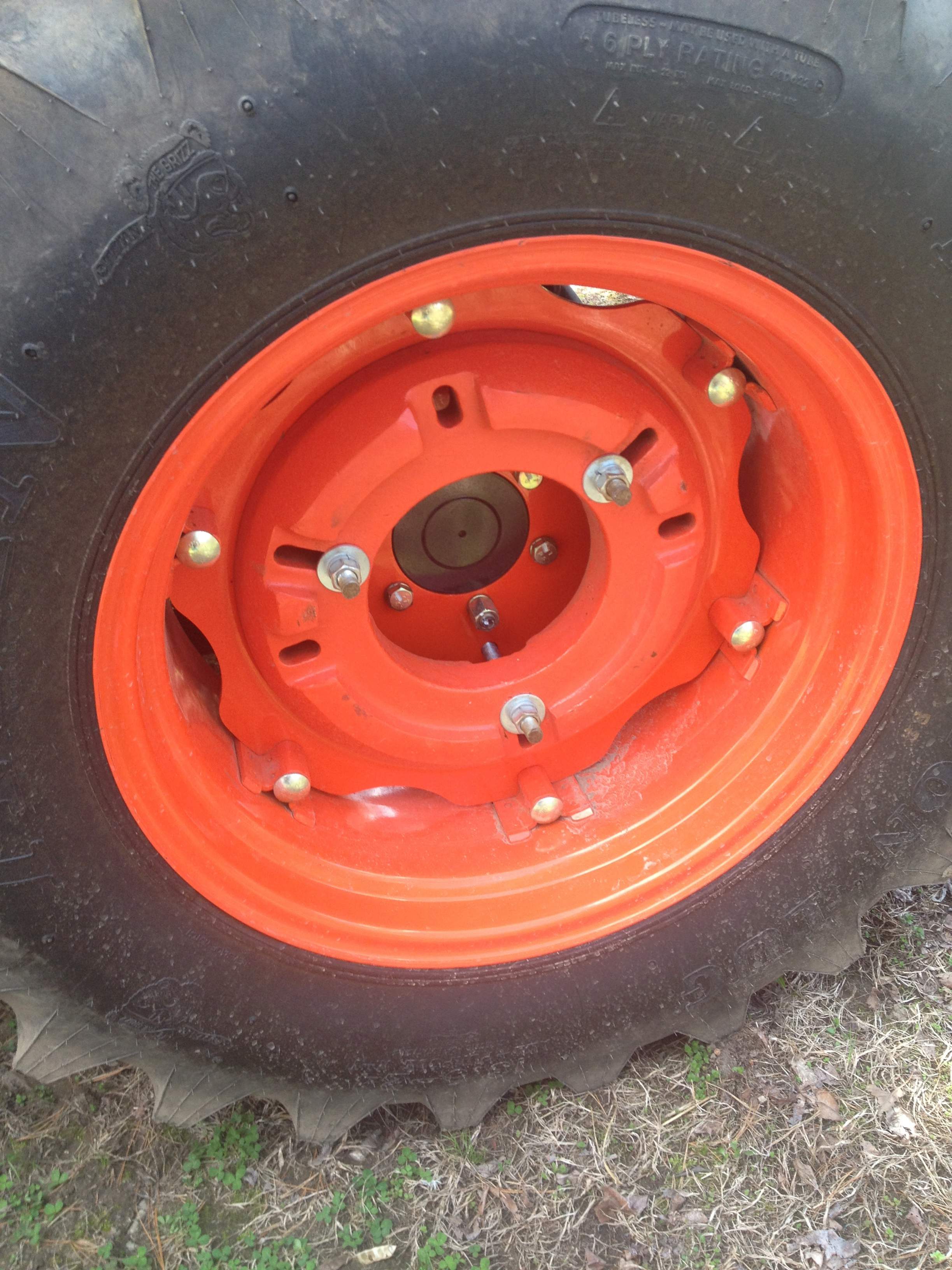

These last two are on an MX5100. Sometimes I take two off so I can hook tie-down straps for trailering. If I'm not on concrete, the weight stays on and it makes the tractor handle much better when it has a heavy implement on the back.

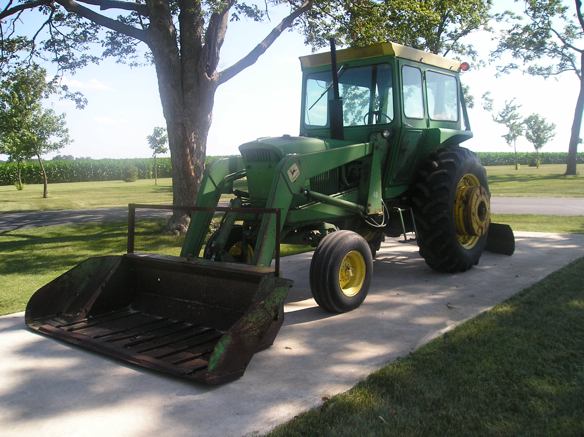

I like wheel weights too. I had 5 on each side to cover the stub axle on my 3020.
