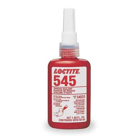

Use this on water, fuel, oils, and anything with tapered threads...
