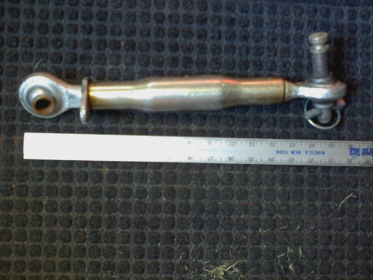

You can buy a Tisco short toplink and get the lift you need.
I wound up mounting the Cat 1 pins facing inside on one of my blades. It works fine.

If you are looking at a standard back blade, as opposed to a box blade, you can certainly buy a Cat 1- 4 or 5 footer and mount the pins to the inside.
I don't have the part # of the Tisco toplink but it has been listed in other threads. You might want to do a search.
The short toplink should give you plenty of lift, as the act of lifting also tilts the blade up.

Here's a pic of the short toplink:
   / confused about a bx 1500
That toplink seems to be almost the same size as the one thats on it from the factory
