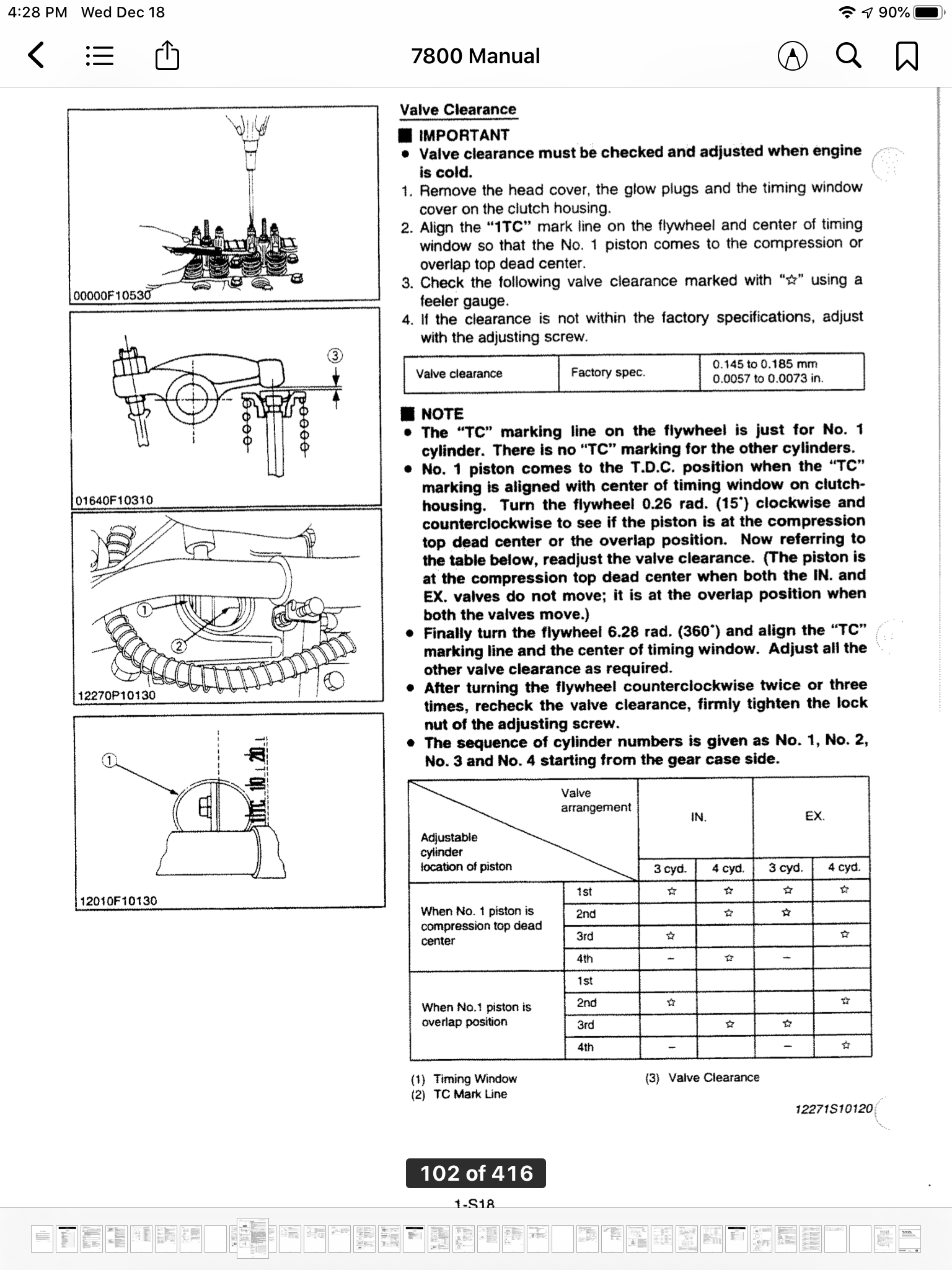

First time to do this...
I've got 0.145mm to 0.185mm as the adjustment spec on both(?) intake and exhaust: reference here; I found this in a thread here on adjusting B7800 valves, but there's no clear model spec and I don't feel comfortable accepting this blindly. Can folks verify that this is correct?
Also, no way am I going to be able to follow the procedure's recommendation to turn the crank in rads. I've only ever adjusted valves by slacking both intake and exhaust valves. Pretty sure that this is sufficient but want to run it by others just in case/for feedback.
   / Confirmation on B7800 valve adjustment specs and procedure #2
Here ya go.
Thanks! Seeing the page header (identifying it as being from the B7800 manual) is assuring!
Maybe one day I break down and get a manual for this tractor. I've got one for my NX (and everything else).
I think I "get" their instructions for setting up for adjusting the valves. The "3cyl" and "4cyl" columns were confusing until I realized that they're showing for two different engines (a 3 cylinder and a 4 cylinder): duh. And after adjusting the specified valves when at true TDC just do one complete crank/revolution (360 degrees) and adjust the rest of the valves. No matter, I am pretty sure that if necessary I could get it done a cylinder at a time if necessary (though a bit slower).

While juggling a bunch of stuff I managed to finally get the valves adjusted (lots of other maintenance on the B7800 as well). Three of the four intake valves were in-spec, with one being out at 0.305mm. All exhaust valves were loose, ranging from (approximately) 0.203mm to 0.356mm.
