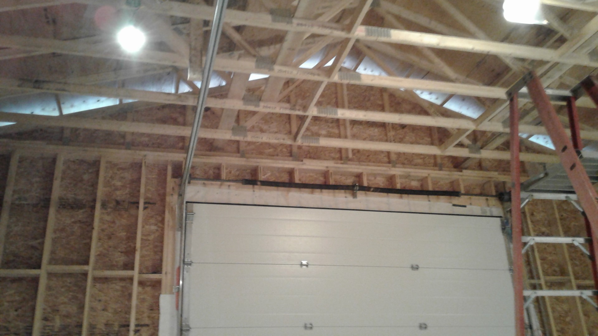

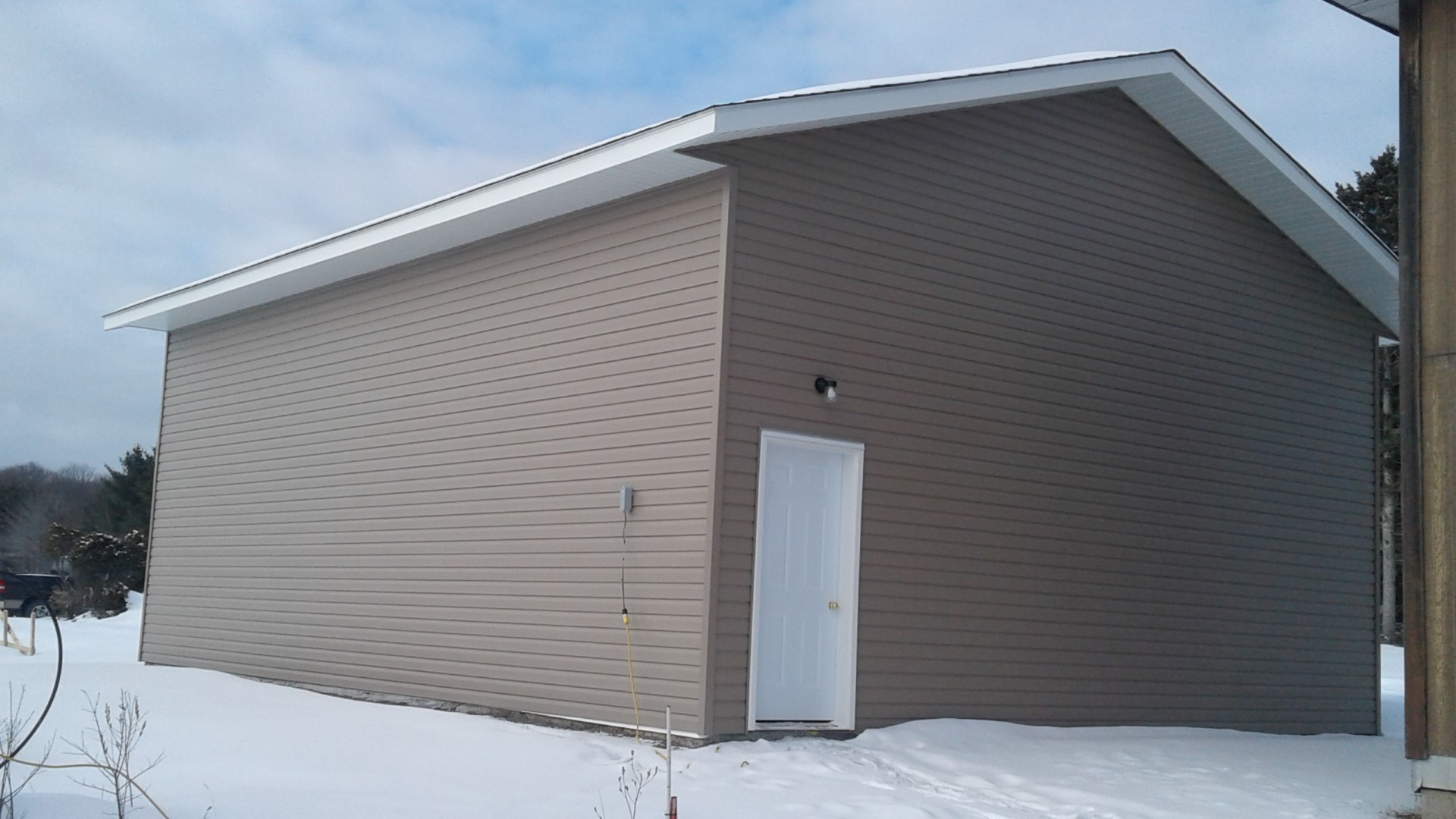

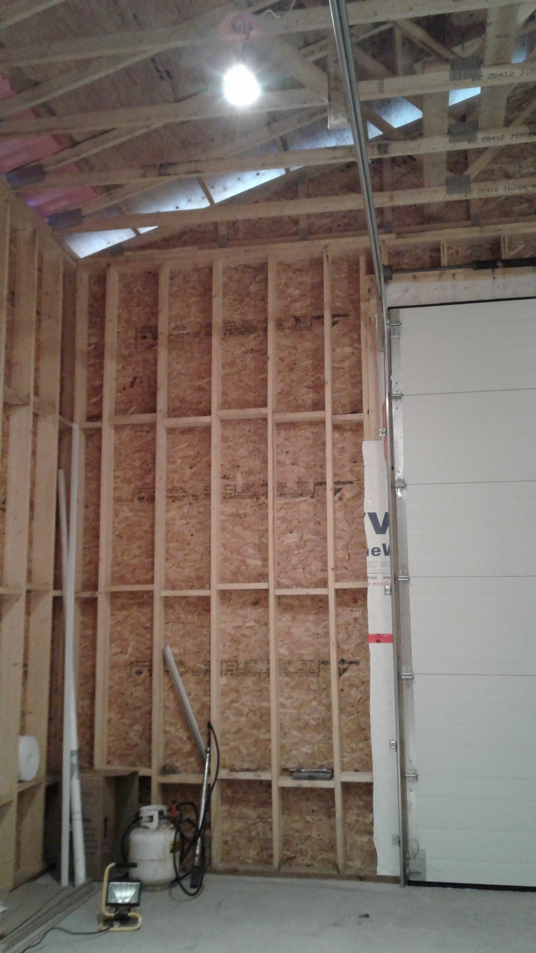

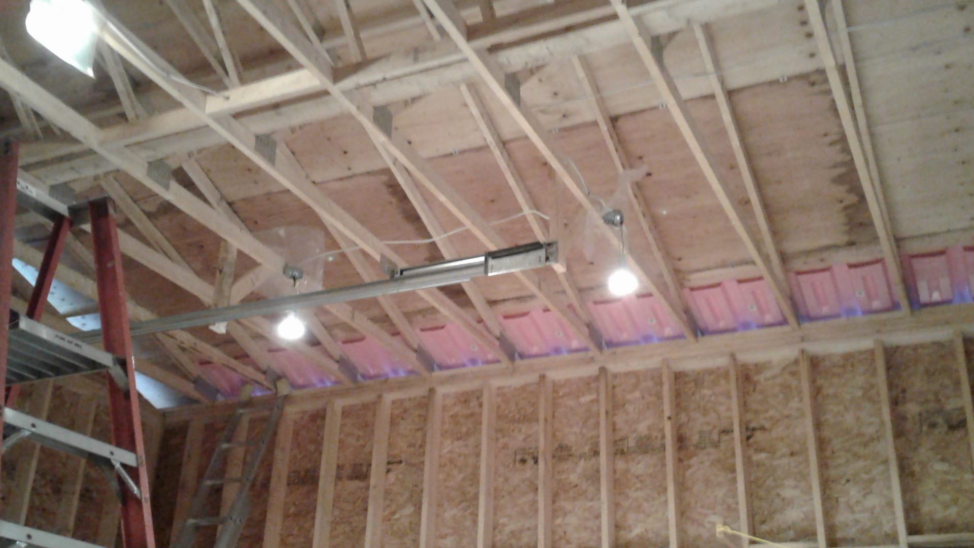

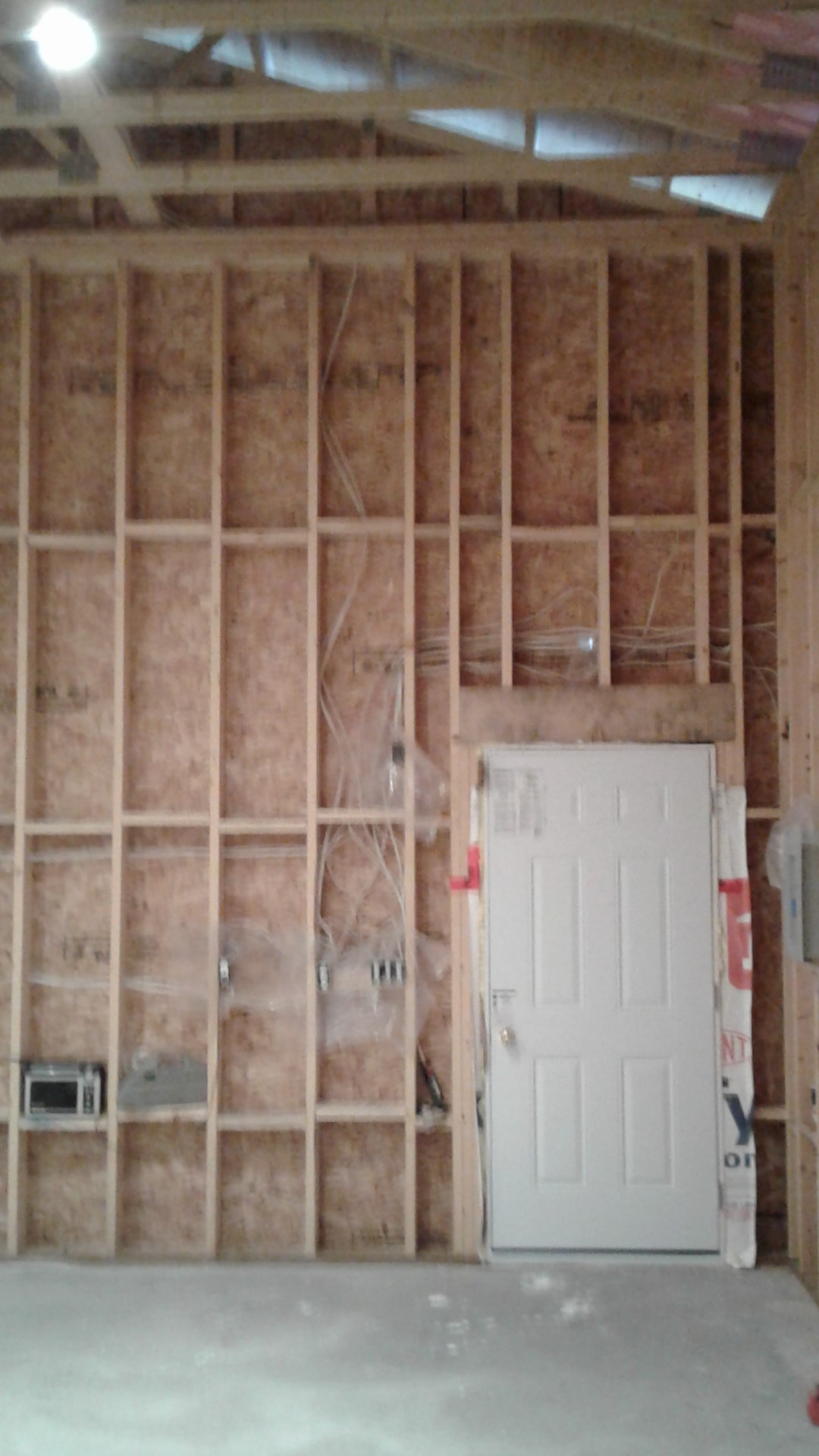

This one here is 30 grand, and that was with the cheapest builder that could be found. 36 by 28, 14 foot ceiling, 12 foot door.
Slab is 5 inch thick with rebar, plastic and rigid insulation under it. That was $6500.
$16,000 for building package. 2x6 studs. Interior vapor barrier and insulation will be around $3000.
Will have 40 grand into it once the insulation and plywood is put on walls and ceiling inside.
It's built a little better than what was need for code around here. Didn't need that many fire stops in the walls and it has an extra top plate.

These guys did the labor cheap Eddie. I was really surprised. It took a bit longer because they had other jobs on the go, but no big deal. Was the only quote that low. But the building inspector said he was impressed so they did a good job as far as I can see.
No windows either. Just the big door and one man door.
