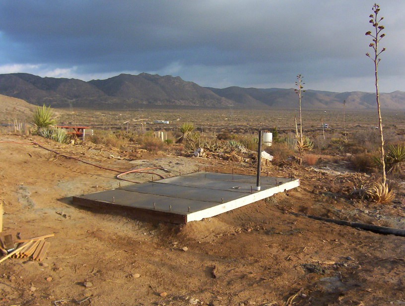

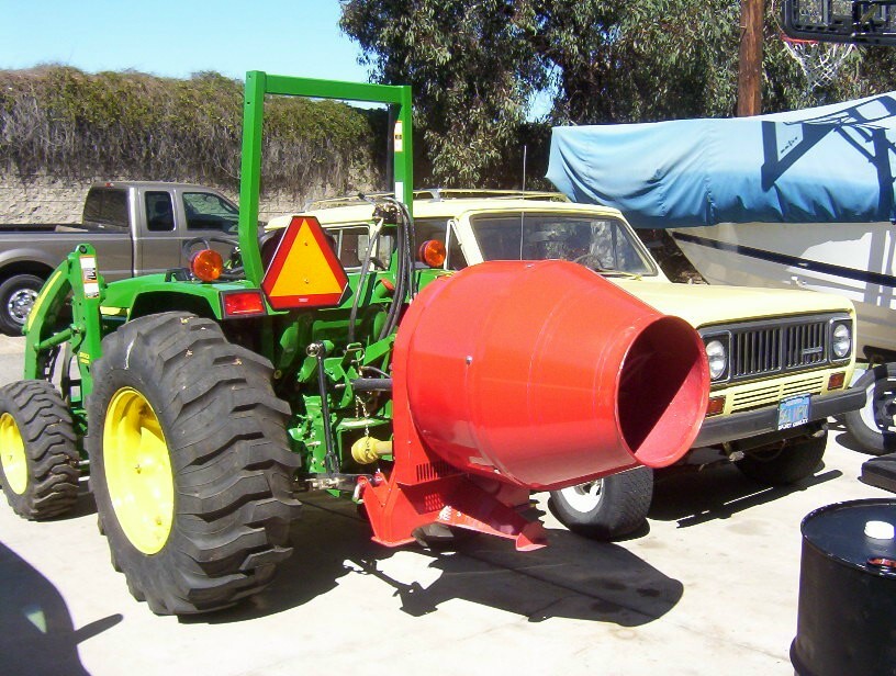

I poured a 8x12 pad last spring for a bathroom building. It was a lot of work. I bought the largest mixer I could get 1/3 yard I believe, but you can't get that much into it so it took forever. I also split the pour into fourths and used an expansion joint. The job took me over three days to pour. If I were to do it again I would just have a cement truck show up and pour it in a few hours.
I do like my mixer and have used it alot for smaller jobs, my tractor is a JD 990 and I have had no problems with the 3pt or the pto being too fast.
