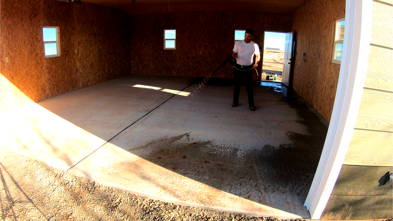

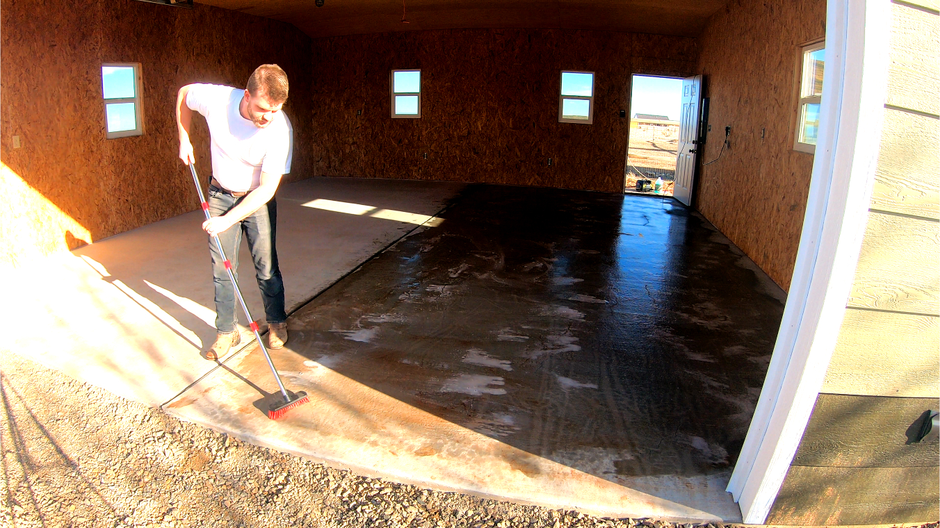

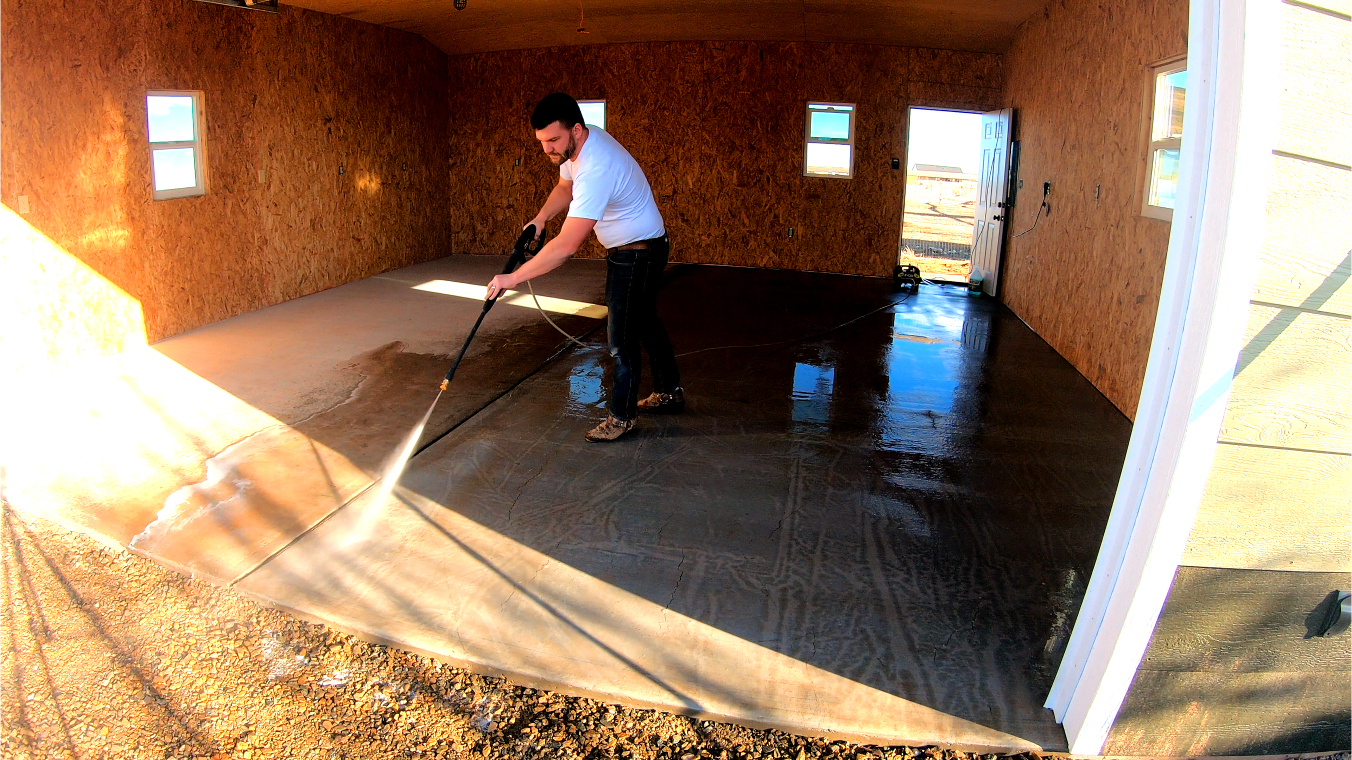

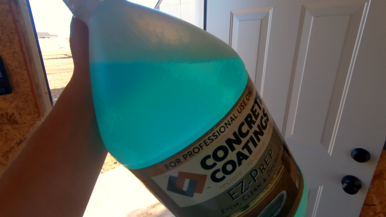

Here is a few pics of the garage floor prep and the solution used. It is a cleaner / etching solution. We didn稚 get to put any stain down this past weekend, the wind kicked up too strong. It will probably go on this coming weekend.

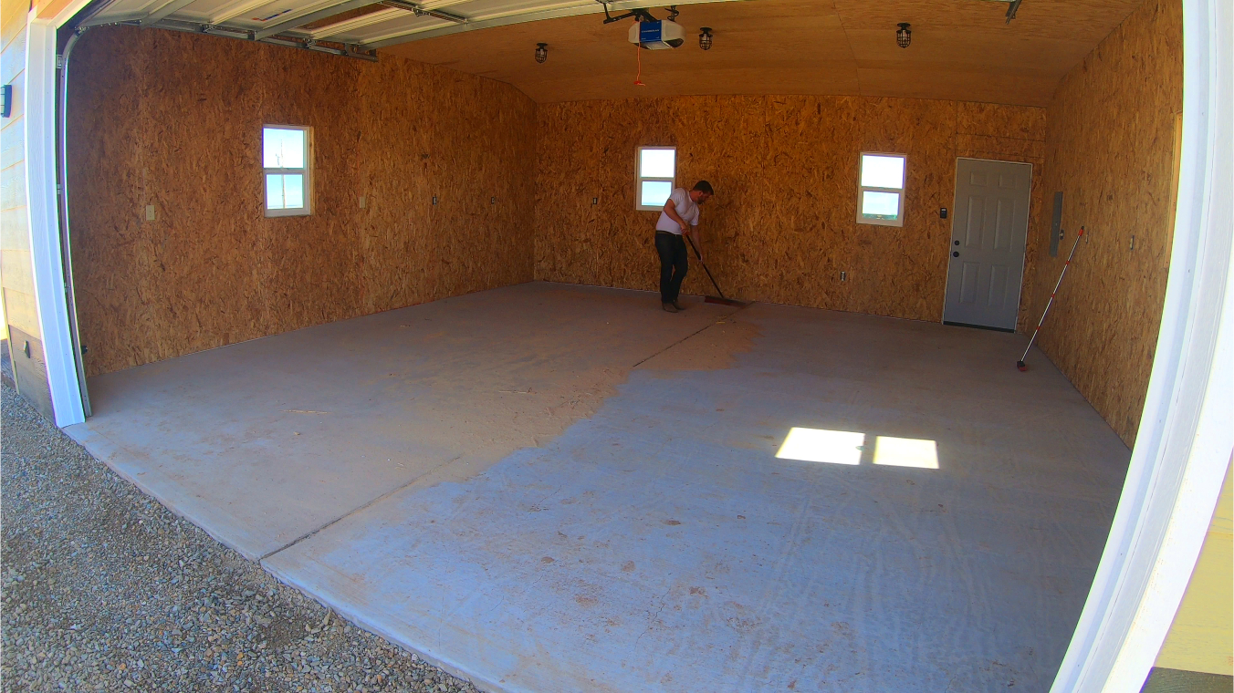

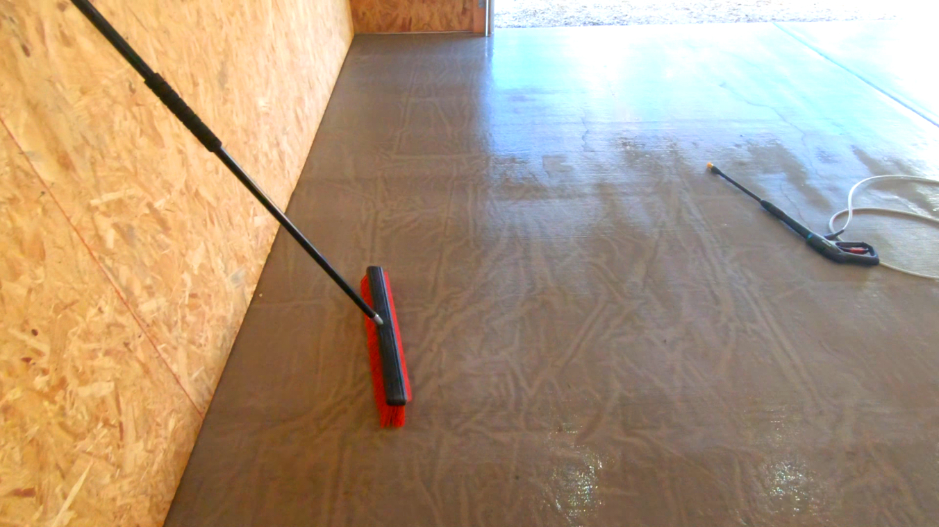

And a few more in process with the solution spraying and brushing on

The products are from a company called Concrete Coatings, here is a link:
Concrete Coatings
The reviews were very good, price was not too bad... middle of the road. My son did hours of research on all types of coatings. Being it will see very heavy garage use, he went with the acrylic top coat. When it comes time to reapply in a few years, just a good cleaning is needed. Some of the other epoxy coats would require grinding / sanding in order to reapply.

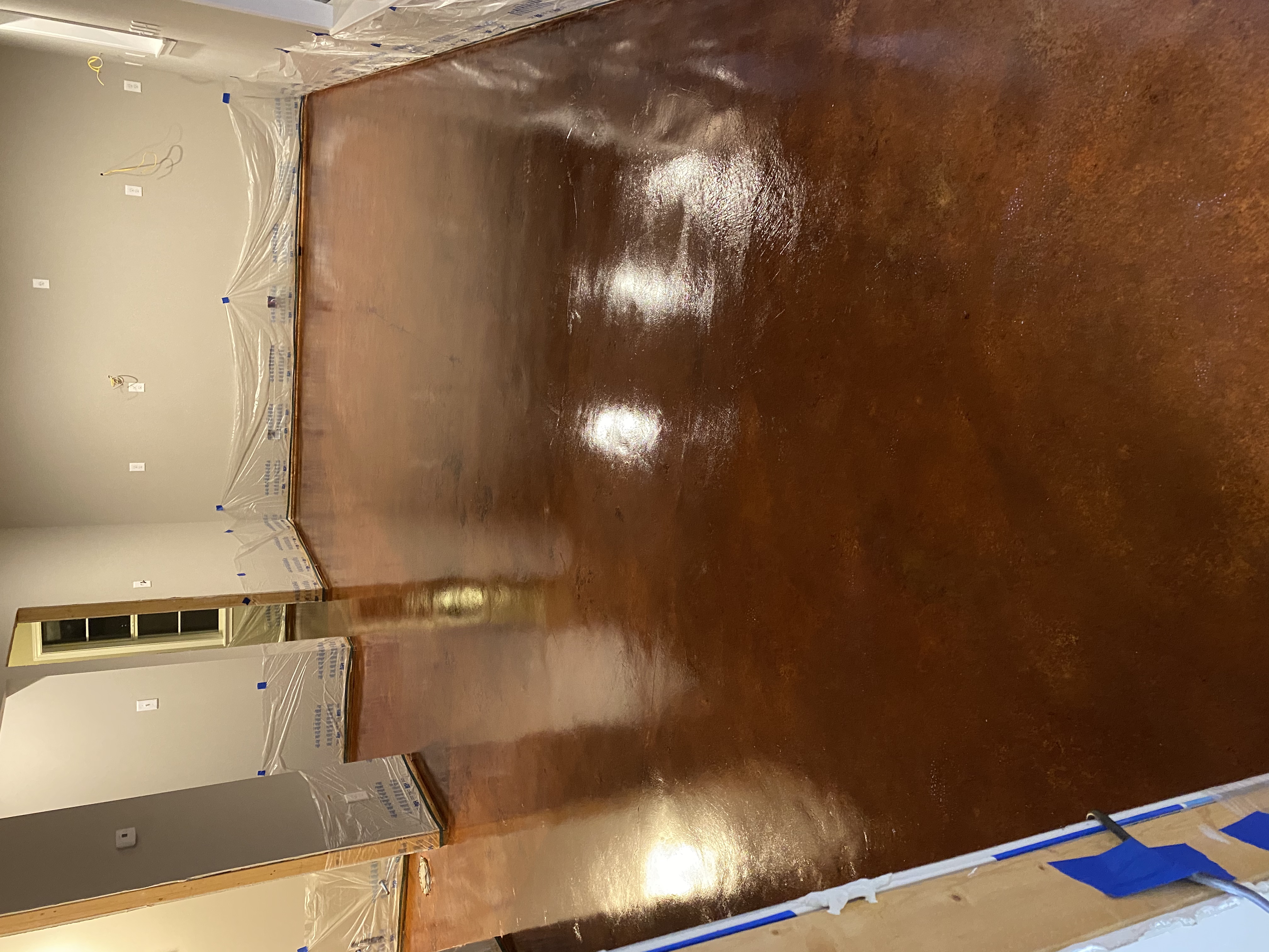

C3E13FA8-5F3B-4EC4-BFE6-C5CAF42AF50F.jpegI wanted to update this thread I started several months ago. Last night, I finished staining the floors of my cabin. I used TSP and a borrowed floor scrubber for cleaning and satin, sealer, etc from Concrete Camouflage. My total cost for everything was under $600. The floors turned out good but not perfect. For a cabin and my first attempt at staining, I am very pleased with the result.
