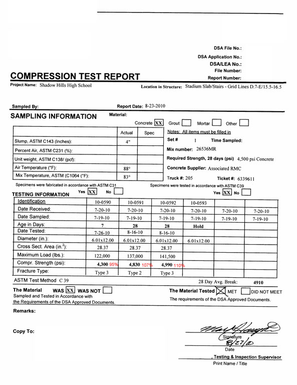

I pulled up one of our test reports for a stadium. See attached.
