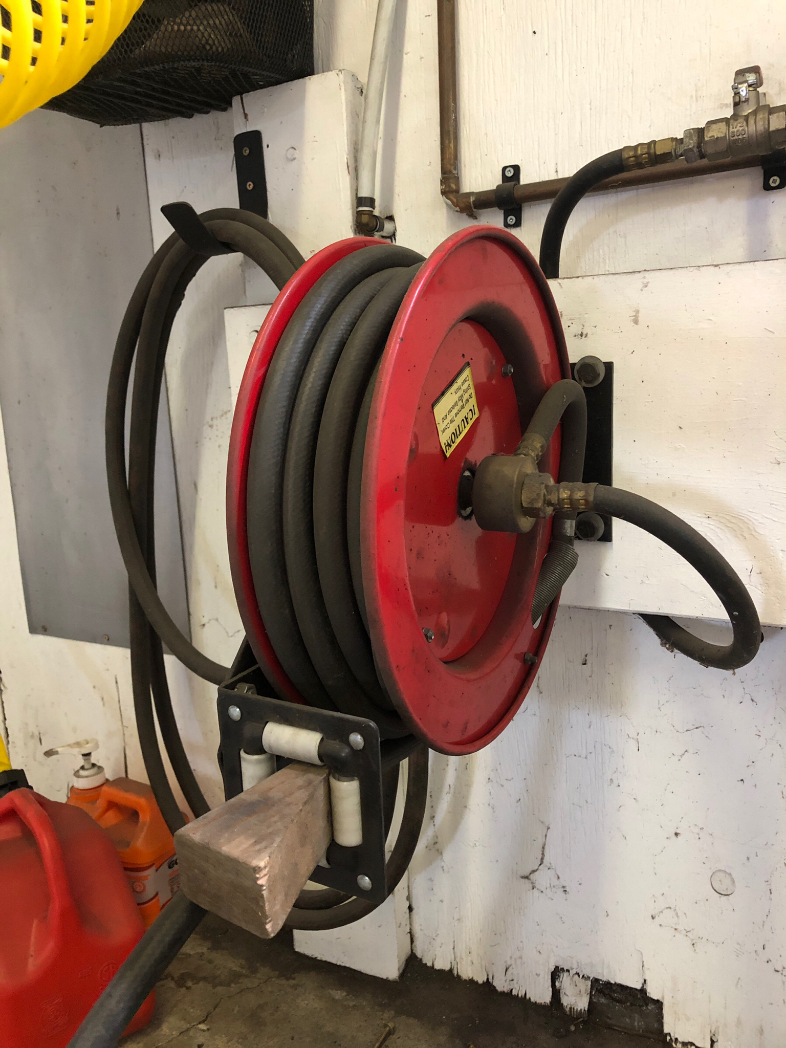

I’m not a fan of reels either. Mine has an internal spring broken or unhooked for the latching mechanism on one of my reels.
Taking it apart appears to be quite a chore so I have taken the low tech approach.
An excellent alternative to a reel is the overhead Festoon Cable system. I may take photos of my homemade setup and post on my retirement farm shop thread later.
   / Compressor & Air Hose Question #48
The disassembly process is less involved than you might be thinking... from your picture shut off the 1/4 turn valve at the top right of the picture, take off the hose coming straight out of the center of the reel, remove the bolt that that hose threaded into which is the banjo bolt for the main hose so it will be loose at this point. Now take out the 4 screws or bolts on that red cover with the yellow sticker which gives you access to the spring that has most likely just fallen off of the keeper like the one I got for half price... I bent the end of the spring to keep it in place naturally instead of wanting to twang out of place if the tension was removed.
Of course start all that by releasing the air in the hose...
Thanks! I will take a closer look. I was being lazy of course...
