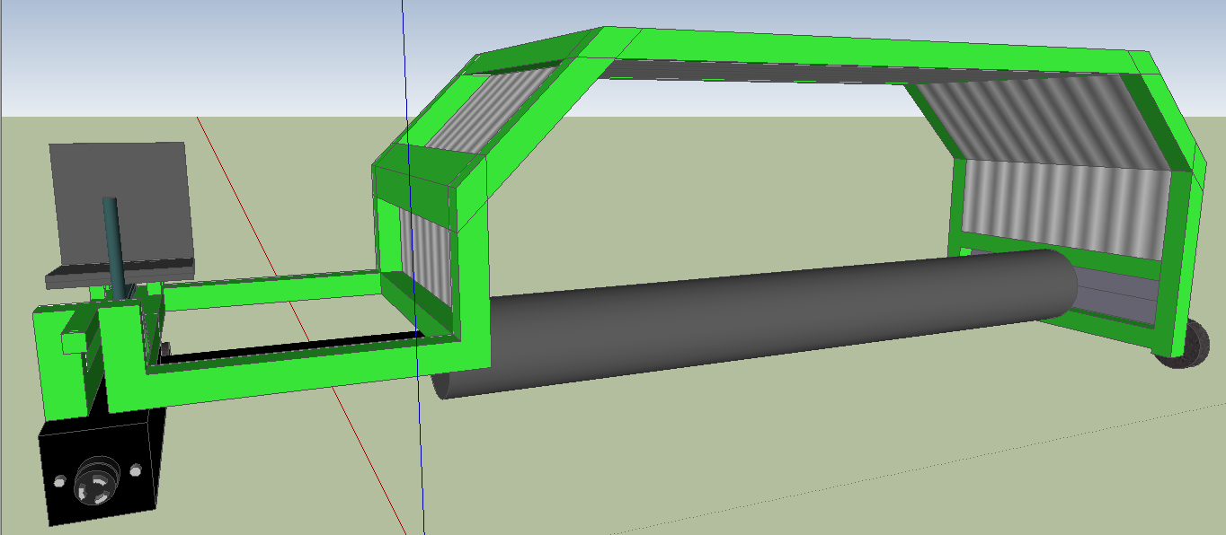

What do you think about getting a tiller gearbox and turning it into a compost turner like the big ones but on a small scale?

Never seen one before - how is it supposed to work?
/ Compost turner. #4
Great idea. If you look on YouTube the videos are impressive for compost turnersI don't think a 2 wheel machine could tow or push one side like a 4 wheel tractor, (see YouTube videos) but maybe ride on top of the compost pile?
Good luck
Sent from my iPad using TractorByNet
/ Compost turner.
The drum has flails mounted to it (not on the model) which are spiraled round the drum, to one side of center they are anti-clockwise to the other clockwise. So the compost on the outside gets 'sucked' to the middle and middle goes to the outside so eventually all the material gets a turn in the middle (the hottest point). Hope that helps.

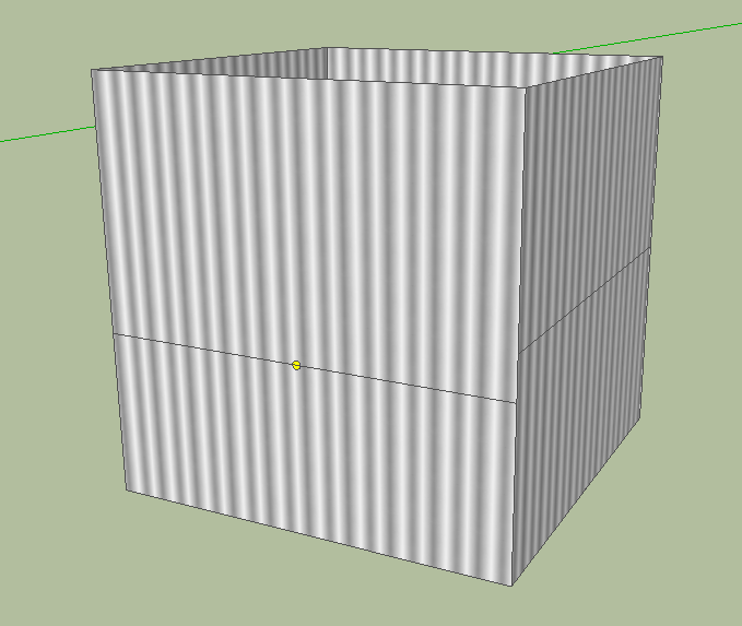

/ Compost turner.
#15

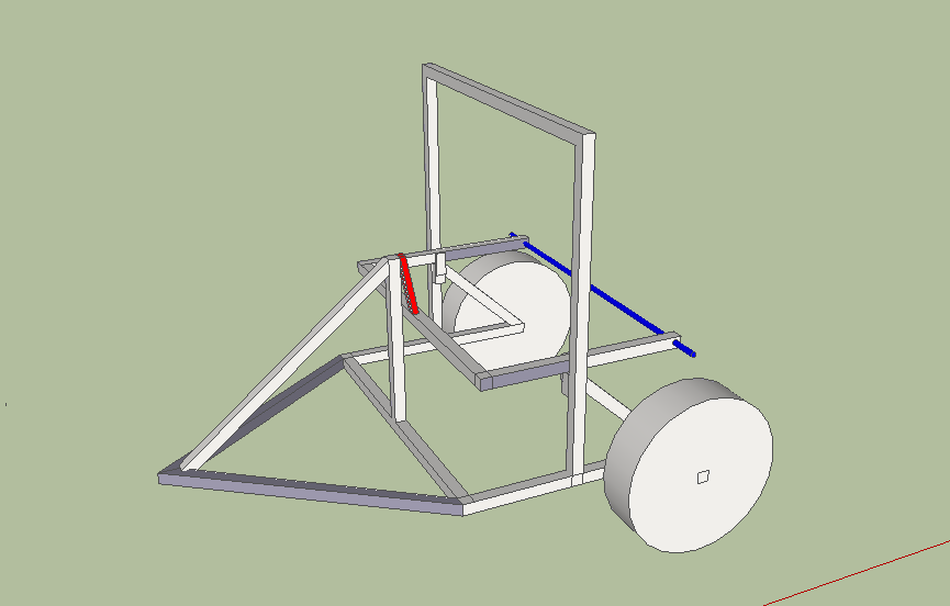

I had another idea, that is to have a trailer (see pic 2) that can move bins (see pic 3) and tip them. Then dig into the side of a hill (see pic 1) and so you can put an empty bin in the bottom and tip the full one from the top. The red thing on the trailer in pic 2 is a manual hydraulic and the blue rod on the trailer goes through the yellow hole on the bin. You will notice the rod is not in the center of the bin that is so that it is easy to tip.

#16
How much will a walking tractor (approx. BCS 853) tow with dual wheels and weights?
/ Compost turner. #17
The 107d has a 4wd trailer that can handle 2000 lbs. So maybe an 853 could do something similar.
