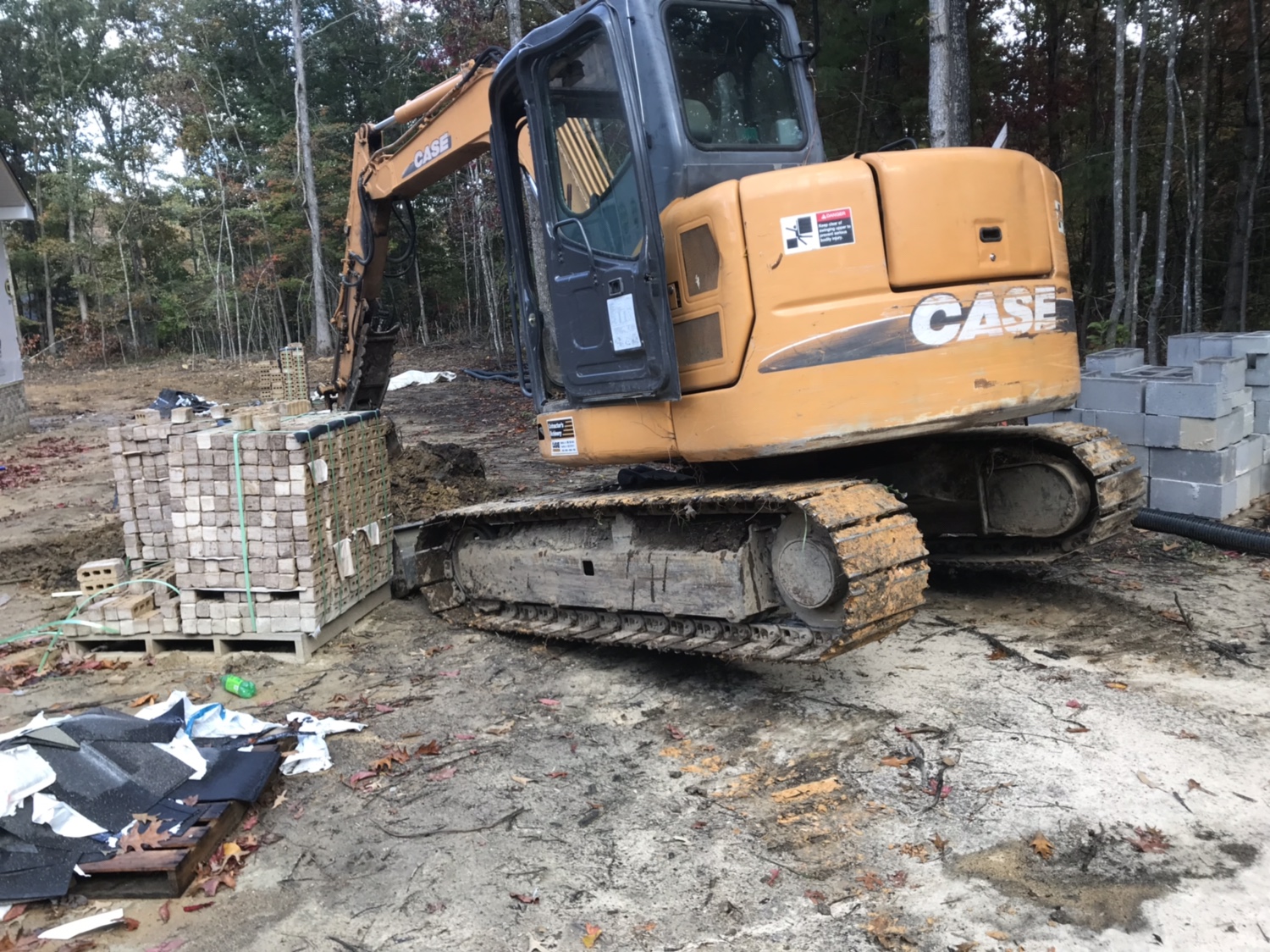

Which is pretty much what itç—´ supposed to do. Is lifting the rear 1/4 inch vs 2 feet any different?
The biggest and most damaging thing is the center of gravity of the machine shifts. The more it is lifted at the rear, the more the center of gravity (and mass of weight) moves forward. Get center of gravity (CG) too far forward and components and parts are subject to forces they are not designed to withstand and they become overstressed.
Not so stubble is seals on tensioners can blow and you throw a track.
Stubble, like the CG moving forward, is balanced weight on the turntable moving to one side and prematurely wearing out turntable bearings. It all adds up to $$$$ for repairs. It does matter, if you are paying the bills.
Brandi
/ Completely homemade excavator #44
Brandi
I wouldn't exactly call what he did, for a picture, as abuse.
IF that is done every time, and allowed to slam back down from several feet...sure.
But the machines are built to handle this. Id really hate to see you on one being paid hourly
You’re right that letting it drop and slam back down is by far the hardest thing about doing that which I’m pretty careful not to do. Lifting it the first 1/4” is the hardest part. It gets easier to lift the higher it goes. And the blade has like a 4” or 5” cylinder that’s pretty much a straight push without mechanical loss. It’s not working very hard to hold the whole machine.
/ Completely homemade excavator #46
Yeah, there always a chance there might be damage you haven't seen and doing stuff like raising the rear end on purpose just might snap that unseen damage.
If someone was paying me hourly to run one, I wouldn't be raising the rear end a foot or so off the ground. But I would be pushing the machine to it's limits. Then again.................I wouldn't be paying the $$$$ repairs either.
