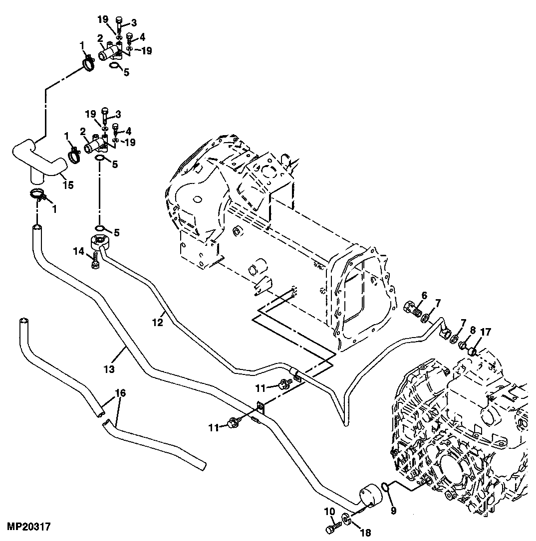

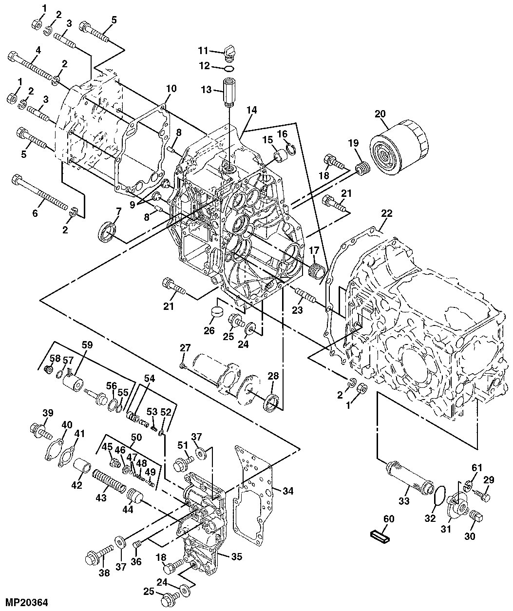

   / Complete hydraulic failure #4
Did you change filter(parts key #20) 1st photo PN LVU800097
Have you checked the filter(parts key #8)? 2nd photo M808624 Filter
