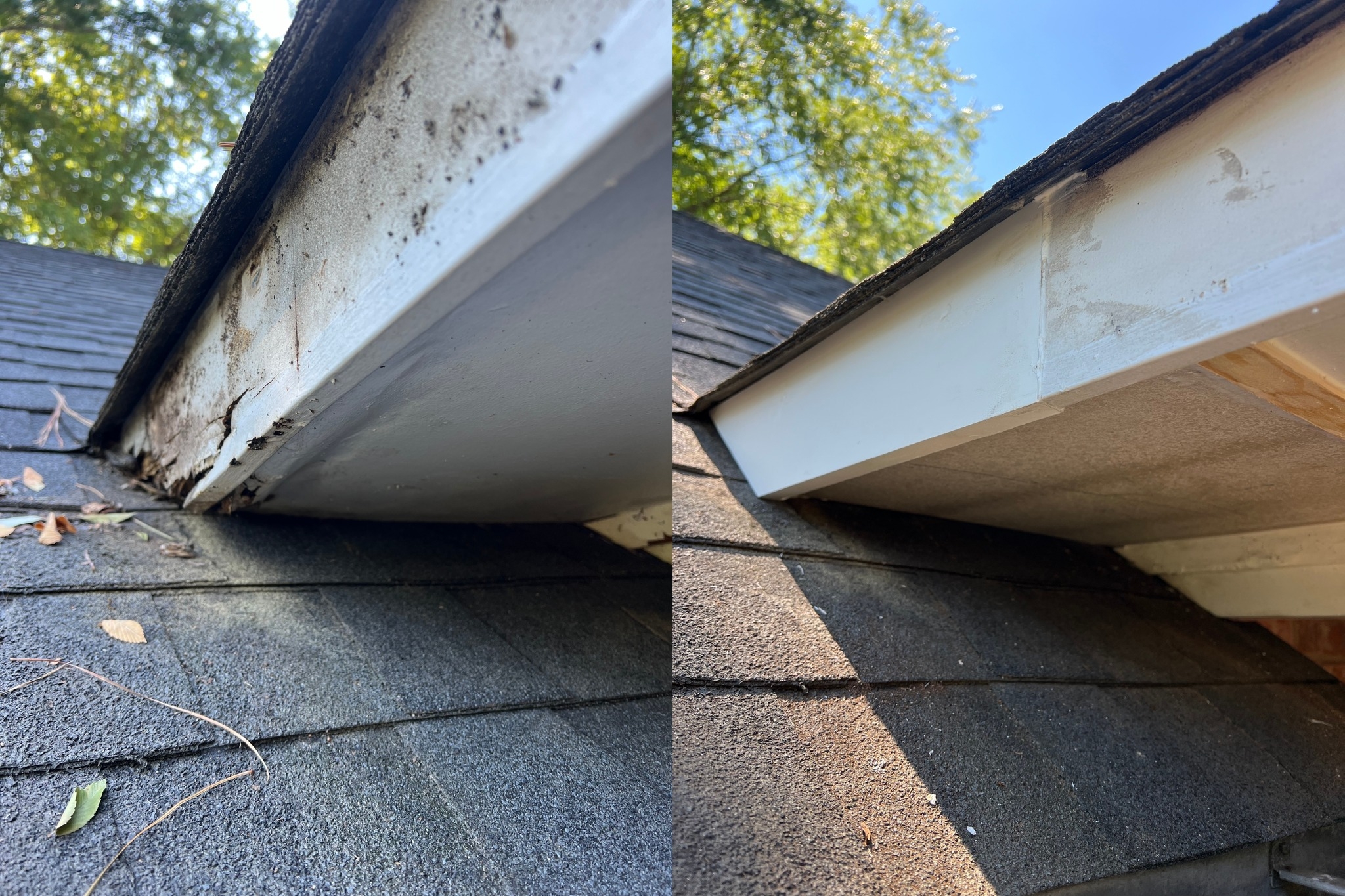

PVC is by far the very best product for wet areas that cause wood to rot.
I just worked on a house for a client that had some rotten soffit and fascia boards because they where installed too close to the shingles. This is very common, and a never ending source of revenue for me. When installed, nothing should be touching the shingles. Hardie says to leave two inches between shingles and their products.
If I have to touch the shingles because the home owner insists, or it's just too ugly not too, I used solid PVC. The cost has doubled, but so far, my clients are willing to pay it to avoid having it happen again. Nothing works as good as solid PVC in wet conditions!!!
I used Hardie 1/2 inch Backer Board for the Soffit repair because of squirrels. It's the only thing that stops them other then metal.
Gutters covered up the seam on the Fascia after I painted it to match.

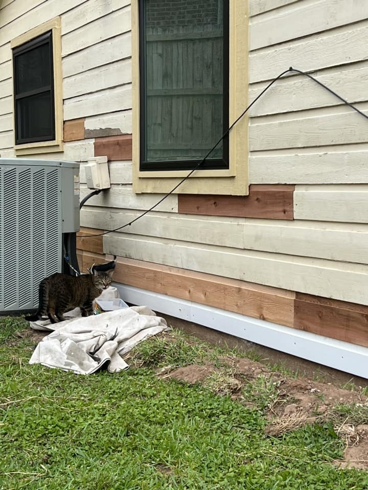

This house had Cedar ship lap for siding. The bottom row was totally rotten away. I replaced it with solid PVC. I had to buy three of them for this, which was expensive compared to wood, but they will never have to replace it.
Sometimes, it's best to just pay what it costs to have the very best materials. Otherwise, it will cost more in the future.
