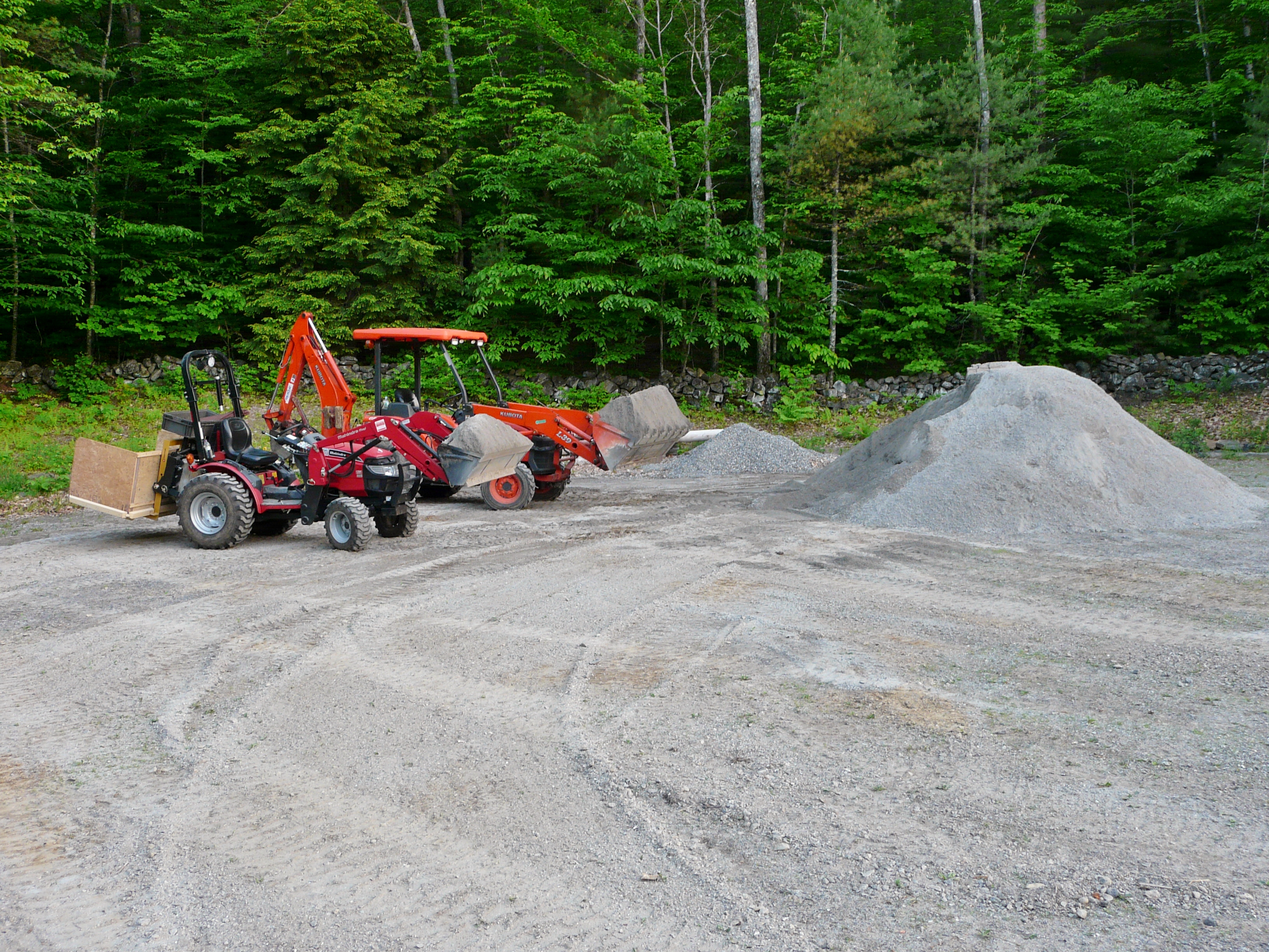

Reclaimed asphalt is goo stuff, and can be mixed with crusher run and gravel. I am cheap and have used all types of material.
1-1/2 works in high erosion areas, 3/4 stone looks nice. chrusher run looks good if of high quality, "Ledge pack" works well but has quarry overburden mixed in so it is cheaper but dies not give that 'stone look"
I use quarry dust or quarry tailing. Where I buy, i the Quarry dust has some small stone and packs well, but some plants produce waste that is pure dust and does not work well for driveways.
I buy loads by the dump trailer, usually 34-35 tons per load.
