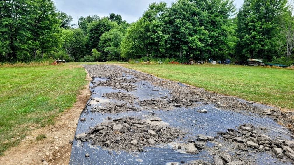

I've become a believer in putting geotextile under a drive.
My original 1400' drive does not have it and gravel over time disappears. It seems to slowly merge into the clay subsoil, in spite of having a 12 to 15 inch deep, 3 layer construction (4-6" base, 2-4" mid, 1" down to fines top layer). It was built in the 80's as a primary road for a sub-division, which was never developed.
I've added a ~400 foot extension using geotextile under the base. Then a build-up of mixed size asphalt millings.
It's still relatively new, but no evidence of merging with the clay underneath and no loss of millings or sinking of the driveway down into the clay subsoil.
At $360 per 12' x 350' roll, it was inexpensive - compared to adding more millings in the future.
(Photo while constructing one section of the extension showing the layers - before final grading and compacting.)

The only issue with doing it that way is that you have no base under the road. So if the soil under the rock/textile ever gets a little soft it will sink under a load and it will never get any better. Large rock followed by progressively smaller rock will bed in. What happens it that the large rock gets pushed down by traffic and spreads out to the sides. When it gets too low for you, you add more and maybe a smaller size. Eventually your 6" wide tire could end up pressing down on a rock / dirt mix the could be 12' or more wide. So less or no more ruts. Textile on dirt = no base. Short term looks good, long term?
Looks good does not equal what is good,

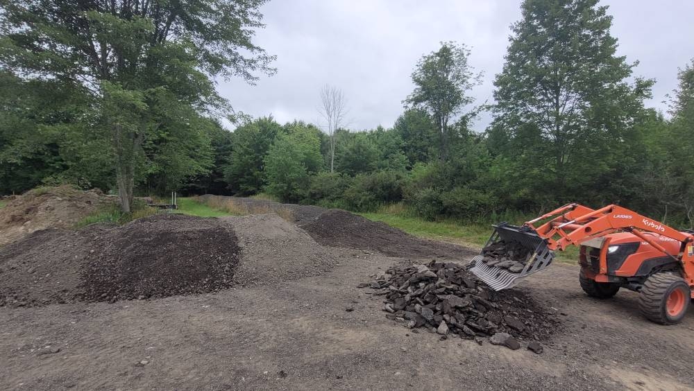

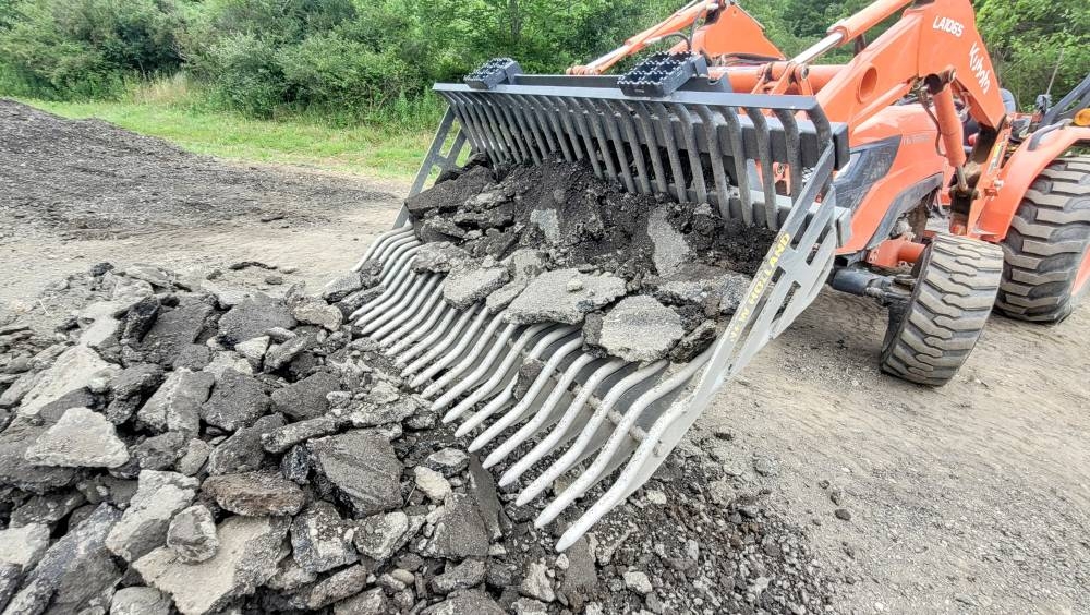

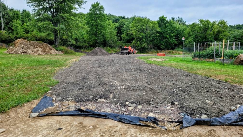

   / Compacting gravel driveway #109
Yup...
Used a rock bucket with 2" spacing to separate large milling chunks from the smaller stuff.
Built the drive with a layer of large milling chunks under the finer millings.
The middle photo shows piles of the larger chunks waiting to be spread. (This was done to hold the fabric in place ahead of the remnants of hurricane Beryl passing through). The entire drive got a layer of the large milling pieces. The base is 8 to 10 inches deep in the main section.
Then added the finer 2" and under as the final layer.
It's not going anywhere.
