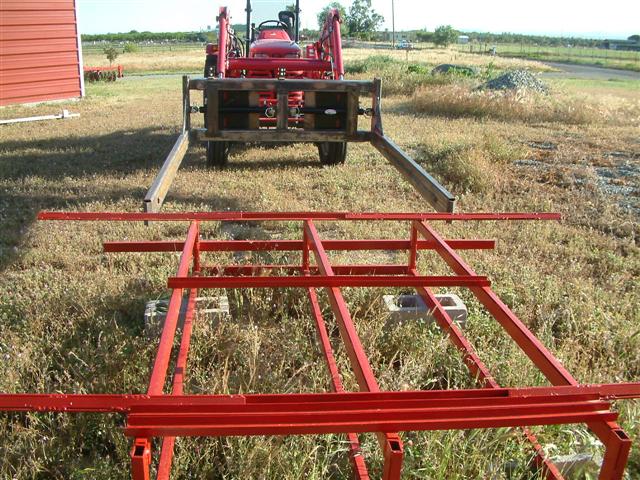

Haven't made a grapple. But I've made an 8-bale combo bale accumulator/bale squeeze for small square bales (14"x18"x45"L).
It attaches to the skid steer plate on my Mahindra 5525.
It's nearly finished. I'll post construction details one of these days.
