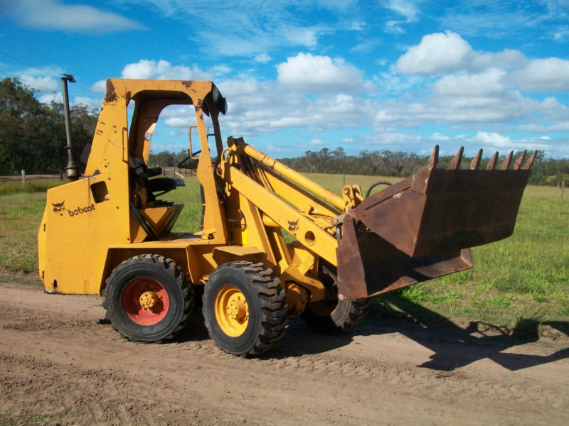

Thanks for link - We've owned exactly the same Bobcat model for years (3rd photo below) & I'm yet to come across another (which I'd buy tomorrow), they seem to be as rare as "hens teeth".

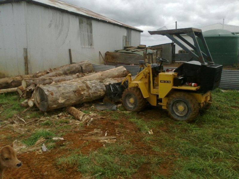

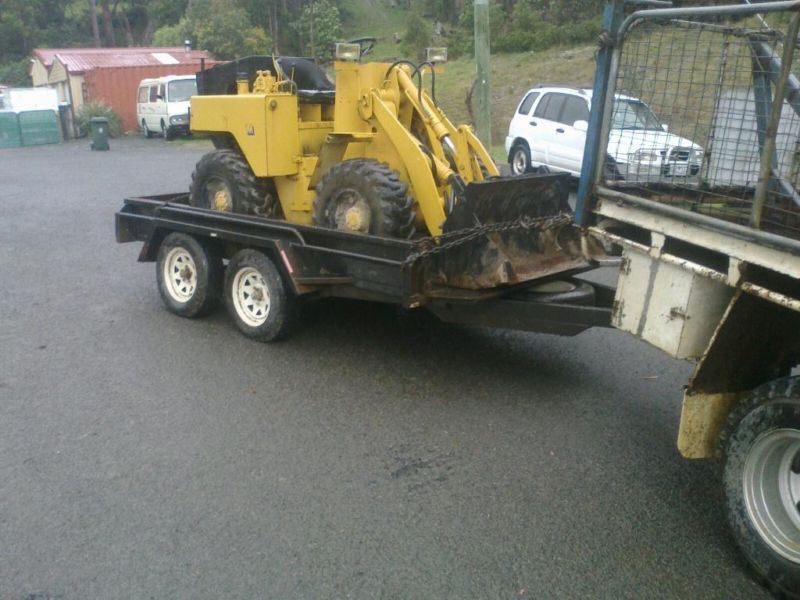

We also run on the farms two other compact articulated loaders (CALs) , a Kubota Rseries & the Mitsui in the frst two photo's below (weighing in @c.1.2Tonne it easily fits on a light trailer behind a Landcruiser).
CALs "punch" usually well above their weight compared with the skid steers we run, but like most things they do some tasks well & some not so great, having used them with4/1 buckets, forks, PHD's & QR backhoes:
- the big advantages with CALs vs similar HP Skiddies are they're a much easier "ride" on the operator, lighter footed/nimble(especially with clip on dual wheels in softer ground), don't churn up the ground so much, lift more weight with higher reach, ease of maintenance/repair, ease of entry & speed of operation + somewhat more ground clearance
- main downsides are, the centre of gravity is a little higher (though generally still stable in most conditions,except when turning @ higher lifts), larger turning circle, far less forgiving on an unskilled "driver" as it takes a while to graduate to an "operator"

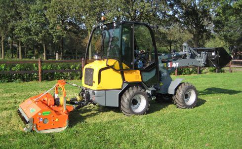

Looking at 3pt hitch+ pto, GIANT loaders have the option for that.
   / Compact articulated loaders #37
<img src="http://www.tractorbynet.com/forums/attachment.php?attachmentid=355928"/>
That's pretty cool.

That Giant with the 3PH has deffinitely got my attention. Any idea if the PTS is mechanically coupled or is it hydraulic? PTO Speed options? That would be one sweet machine!
EDIT: I looked on the Web Site. I have no patience for trying to find things on Web Sites. Usually just look for an 800 number and tell them to send me a link! I would like to know the exact model name and number for that machine pictured with the PTO.
