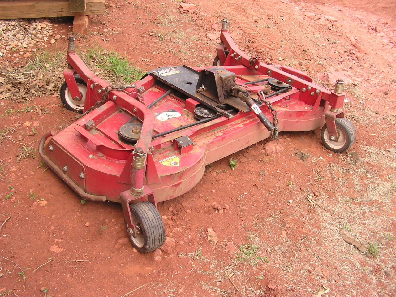

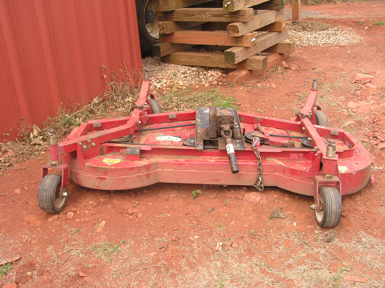

I have both types, but I like this third type, a 6' Recycler deck the best for most of the mowing that I do:

How limited is the recycler deck in tall/thick grass?
I've always liked the idea, but thought it would struggle to cut in thicker stuff.

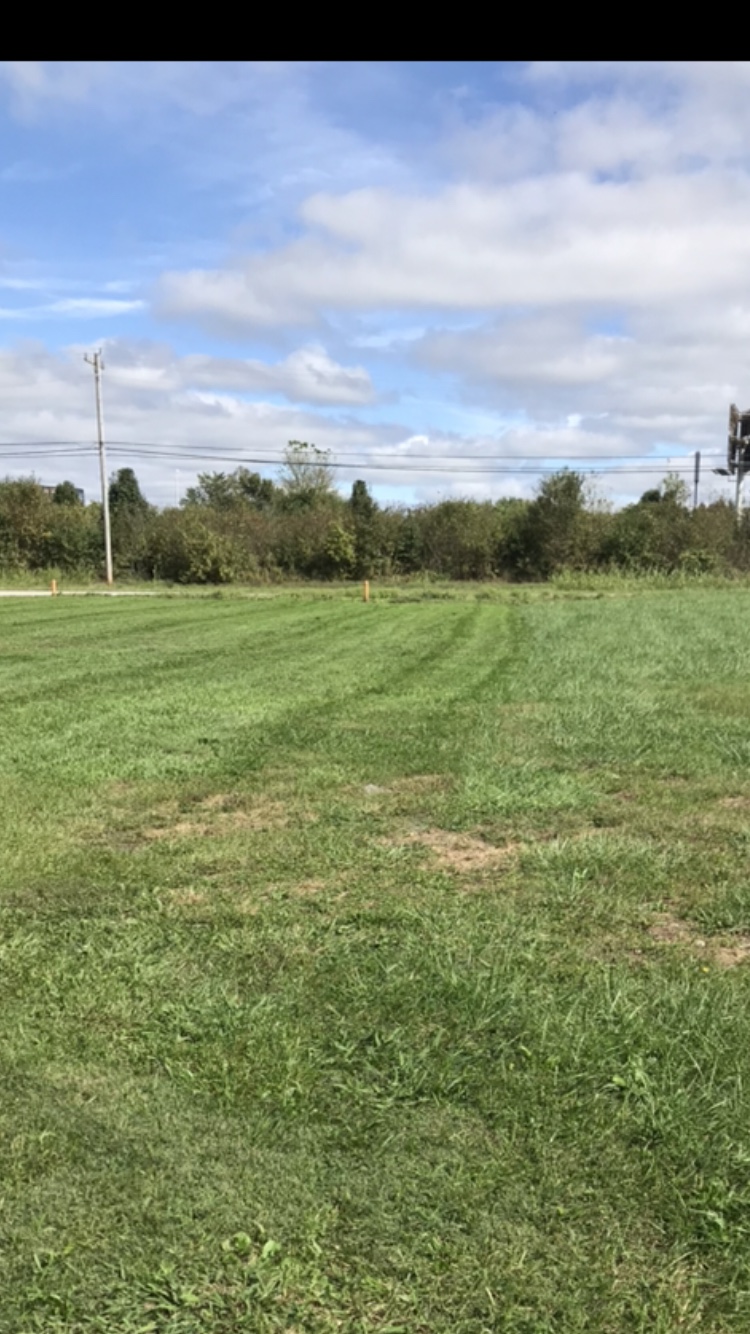

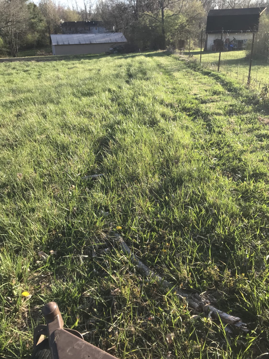

My SD Grasshopper does a better job than my RD Howse finish mower. The finish mower leaves a field full of golf ball sized clumps. The Grasshopper does a clean job until you’re into grass that really needs a bush hog. IMG_1881.JPGIMG_1883.JPGIMG_1860.JPG
