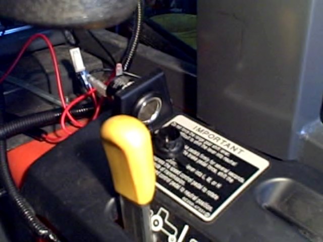

Man, all I have got to say is some of you guys sure sound piss for people with new tractors! Where I come from, if we want something built a certian way or want it to have a certian thing on it, we make sure it is there BEFORE we buy the product. A company can not anticipate every detail that a customer wants before hand, and just because a few people want it, that does not mean that everyone else is willing to pay more to get it. Everything you add cost money. It is not just buying the part, it is installing it on the line, keeping parts stock, changing wiring harness, safety testing, etc. If there was a plug, some people would gripe it stayed on all the time (without the key) and some would gripe if it was switched with the key. Can't keep everybody happy. Just a few thoughts.

Engineers try their best balancing reliability, cost, and features. Could be they didn't put an accessory outlet because they calculated the electrical load and found that with everything like lights, etc., on they were drawing max alternator output so they wouldn't put on the outlet. Combine owners never can have too many lights, so at Gleaner we found many adding lights beyond what our system could handle so combining at night they would draw much more power than the alternator could put out and by the time they shut down the batteries were too low to start it up again, so combines had to let their machines idle all options off while they slept to charge back up. Since we had the largest alternator available our fix was to make a dual alternator option until suppliers came up with an economical larger size. Now we have xenons so light 'em up without needing an auxiliary power unit.
At Case we had a 15 year old combine cab the customers didn't like so we spent tons of money developing a new one. After the first one was in place we asked everyone at the Hinsdale Engineering Center to try it out. We had the new and old parked side by side. The engineers, mechanics, managers, clerks, all gave the new one a big thumbs up. Lots of back patting. Then someone asked if we shouldn't ask the end user. We got 4 combines, our production, our super cab, our largest competitor, and the competitor customers talked about the most. We brought in 2 dozen operators, major operators who spent from May to December in the machine, and had them do the same rating game. Result - our new cab came out worst, worse even than our old production. The designers missed several points the guy who spends his life in the seat felt was important. It's not like our engineers didn't get their hands dirty - everyone was required to spend at least 3 weeks per year out in the field operating and working on the machines. So we turned the cab project over to a cab design firm and started over.
Cat large equipment machines sometimes skimp on the power outlets because they are 24 volt. BCP machines are 12v (backhoe loaders, skid steers, etc.) but larger dozers, excavators larger than minis, wheel loaders, all are 24v for oomph to turn over the larger engines on cold mornings. Consequently they need a step down converter that is pretty pricey to bring a regulated 12v to the cab power outlet, but I think about all of the new machines have them now because operators need their phones and stuff. Every Japanese has at least one smart phone so if the power outlet was missed, it must have been stripped down for the US. The tractor that started this thread is one of the assembled in America machines isn't it?
